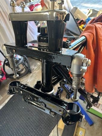

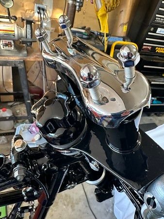

And took a little break from putting the 65 back together and got some of the front end on the 49 FL.

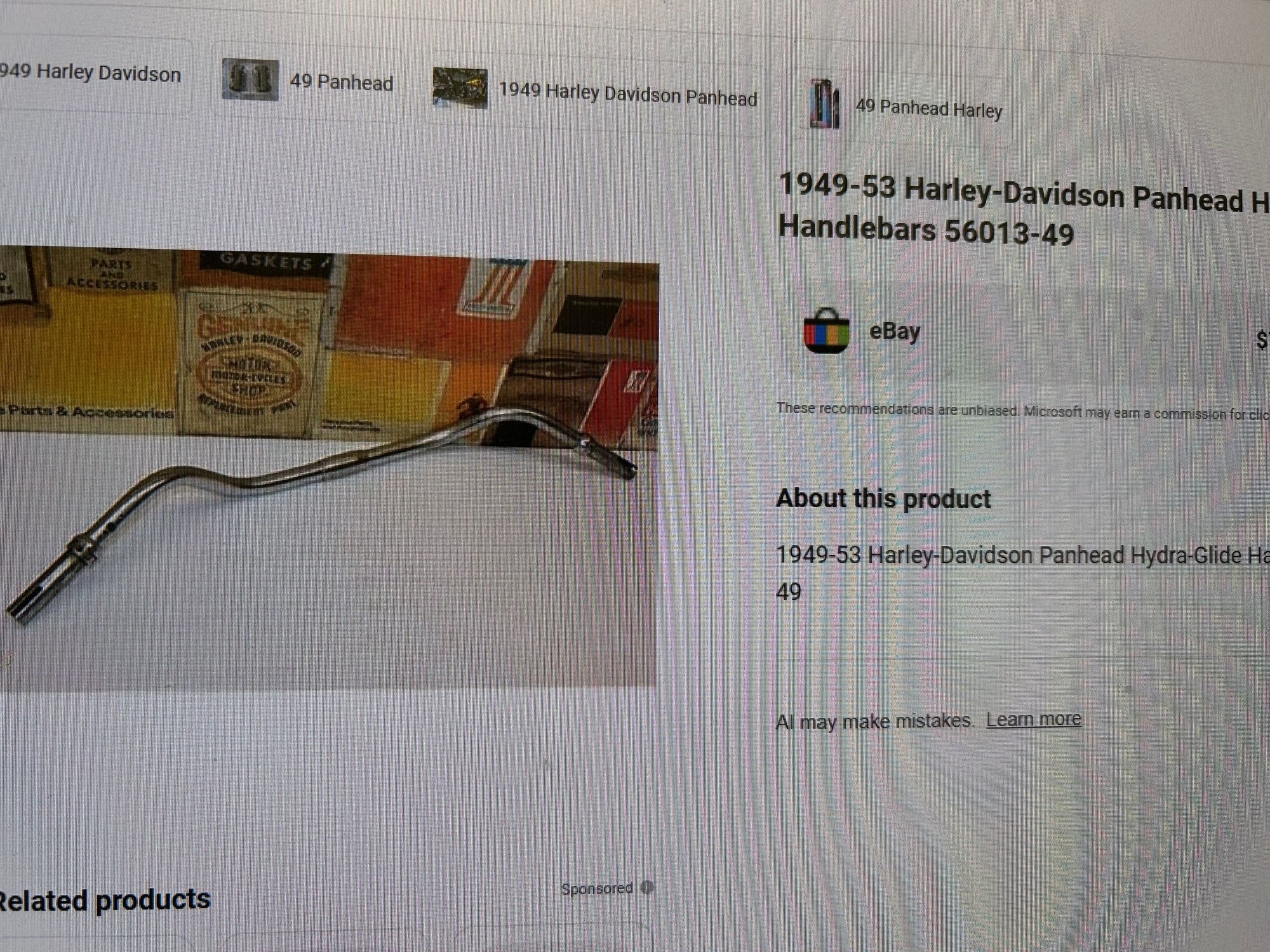

Have the AMCA Dixon swap meet coming up in a month, so I'll look for some handlebars that won't be all f'd up and that I can restore.

Trying to find the earlier type without the re-enforcement on them. Maybe have found them from a member on one of my Panhead FB pages

I have found many 49', 50' unreinforced handlebars. Every one of them cracked. I bought three so I could play with them. I repaired two by cutting and inserting a sleeve and re-welding. I had two of them chromed. I am using one set but have another.
I had not decided what to do with them as I have so much money in the with the new chrome. Then @ Oley I found a bunch of early bars complete for about $1800 so maybe mine aren't too expensive repaired.
I guess I`d pay the $75 for the ebay bars
Yep...the ones on my 49 EL were that way. After repairs and re-chrome, I used the top clamp on them instead of the two individual ones.

For a bike you are going to ride you are probably better off with the later reinforced bar with a top clamp. Museum piece, find original.
