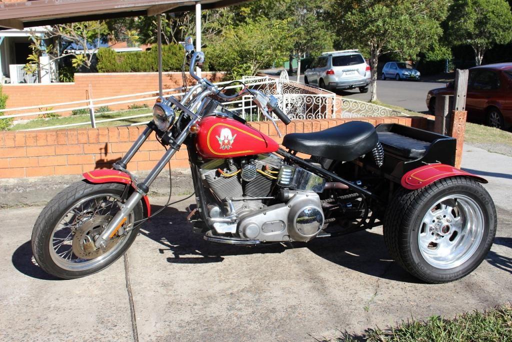

i mentioned to him that i have a mmd reverse on my trike. he didnt want one for some reason
