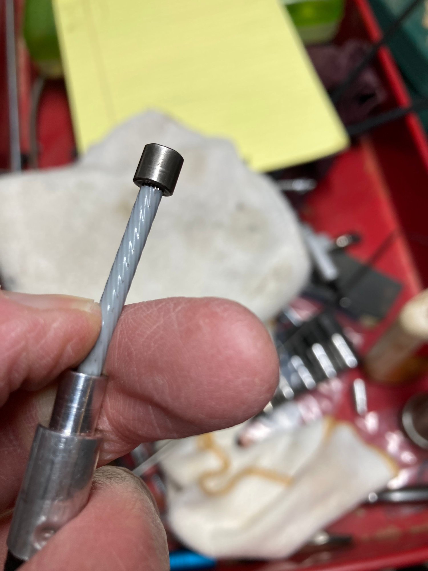

Here are some shots of the custom Barnett shorty cable to fit a wishbone frame with wide glide OEM triple trees, 1-1/2" risers, and 28" drag bars.
I was wrong, in that instead of lining the cable housing with teflon, as they did with bicycles for years until the shift to hydraulics, Barnett sheaths the cable itself in nylon. They include a bit of light grease for fittings but the action is extremely slippery, so I don't gather they want you doing anything other than lubing the ends where they pass through the ferrules. Otherwise, with a normal metal-to-metal cable and housing, I tend to flood them with light oil until it comes out the end.
As for the cable ends, it looks like what they do is swage steel ends on under extremely high pressure in a purpose-made die, then slice off the shorter end to fit nicely into the lever's recess...? FWIW, I've included a shot showing the way in which Barnett configures custom-order part numbers, so it's easy to order whatever you want added to or removed from any cable they offer over the counter. What they really care about is the casing length, and will maintain the free length from the base cable you're modifying unless you tell them otherwise.
