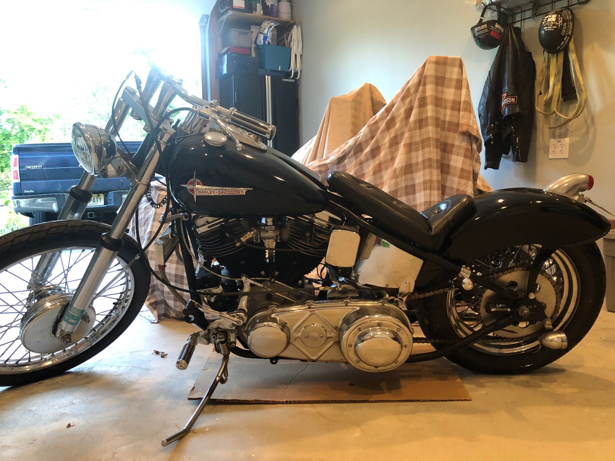

Will start by saying a man must know his limitations have a 57 frame. With 64FL 12volt s/s E carb believe the motor is stroked built by a guy out of NY thy called the beatnik who has passed on .offered the bike from a buddy. Who built it in late 70s early 80s sat under cover in his garage 10 + years jumped on it.#3 first kicker After some wenching and reading soaked rebuilt carb. All gas lines. Flushed tanks.and oils and screen Plugs New battery. She kicked. After carb and clutch adjustment she a runner. And ran strong after riding a while bike not so reliable kicking kicks through kicks me. And when your the only guy kicking everyone is watching has an opinion believe needs a trans or kicker rebuild. Some electrical issues. Or other recommendation Looking for a guy or shop that. Has the experience on older iron. (Not easy) I love this machine and love riding it.and want it to last another 60 years I’m in the NY/ NJ area Orange County wanted to stay closer to home. If possible but will travel any recommendations
would be greatly appreciated, and thank you in advance

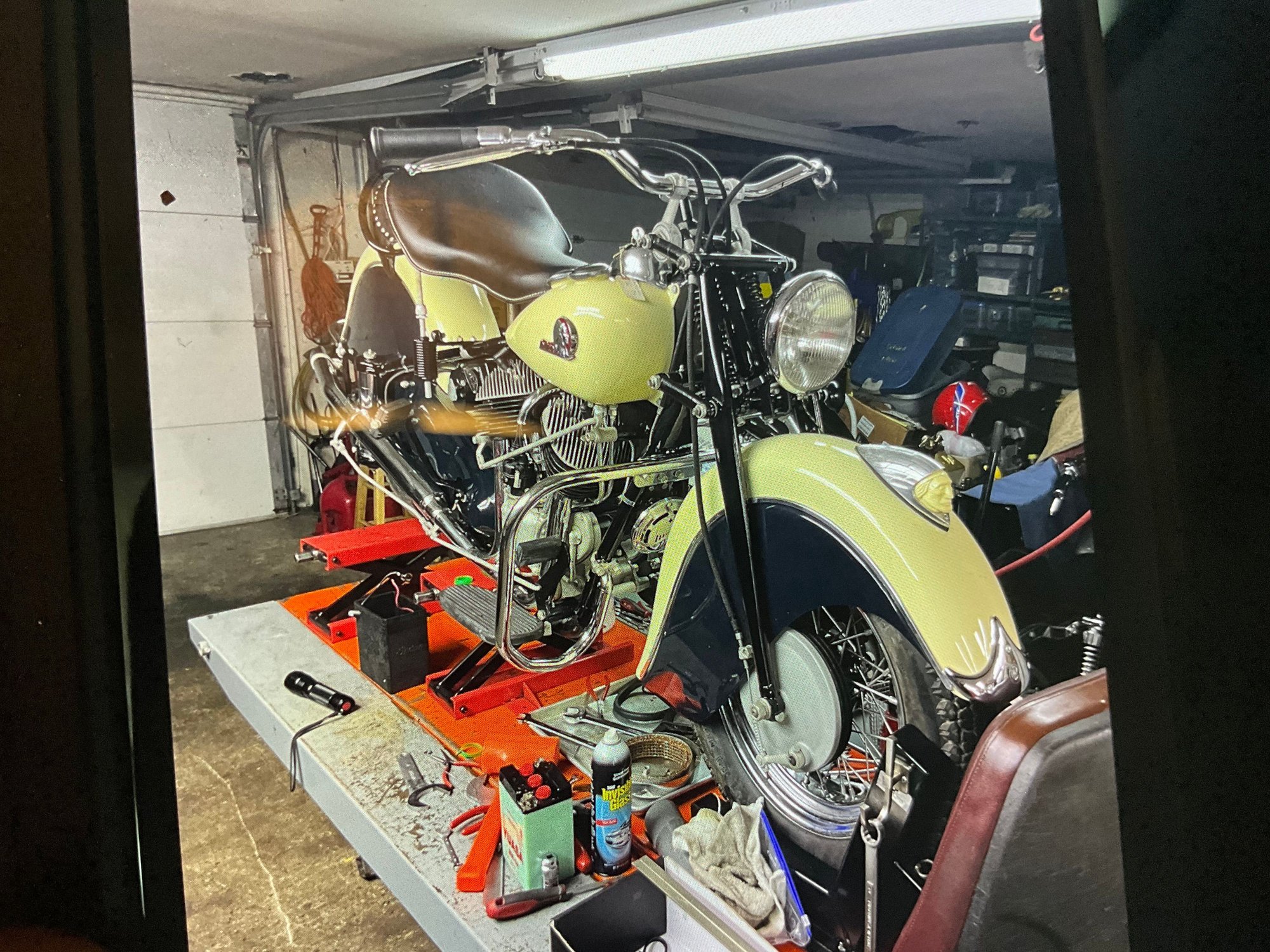

extensive work on the 3 Indians from chassis up to trans overhauls - the 1958 I pan is a chassis up have a 41 knuckle and another 48 pan chassis up and 2 shovels chassis up - all on going at this time but yours is a in and out couple weeks time with no other issues
