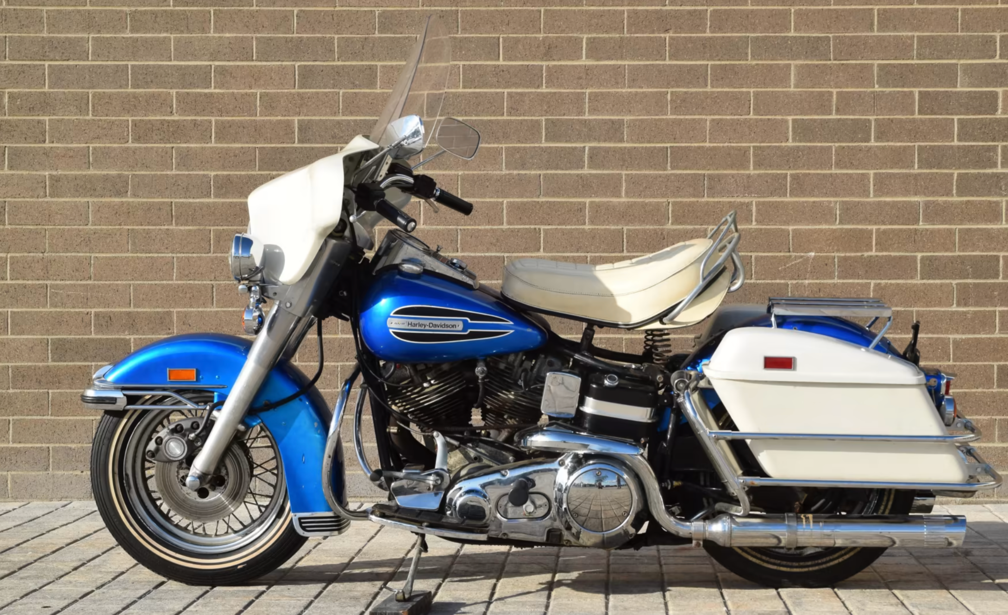

So, my neighbor introduced me to the widow in El Paso via 3-way call, and after he hung up I asked her to please go out to the shed and read me the engine number from the bike. She did, and…
..yeah, it’s 1972, not a 1962—which of course means it’s a Shovelhead. It is indeed all there and much like the one pictured below. Blue and white, just as my neighbor remembered, and sounds like a very nice bike, but… not a Pan as he had recalled.
So, I’ve cancelled my ad (marked it as sold because I don’t know how else to do that). Told her to go ahead and list it for sale on the web, and thanked her for holding it for me.

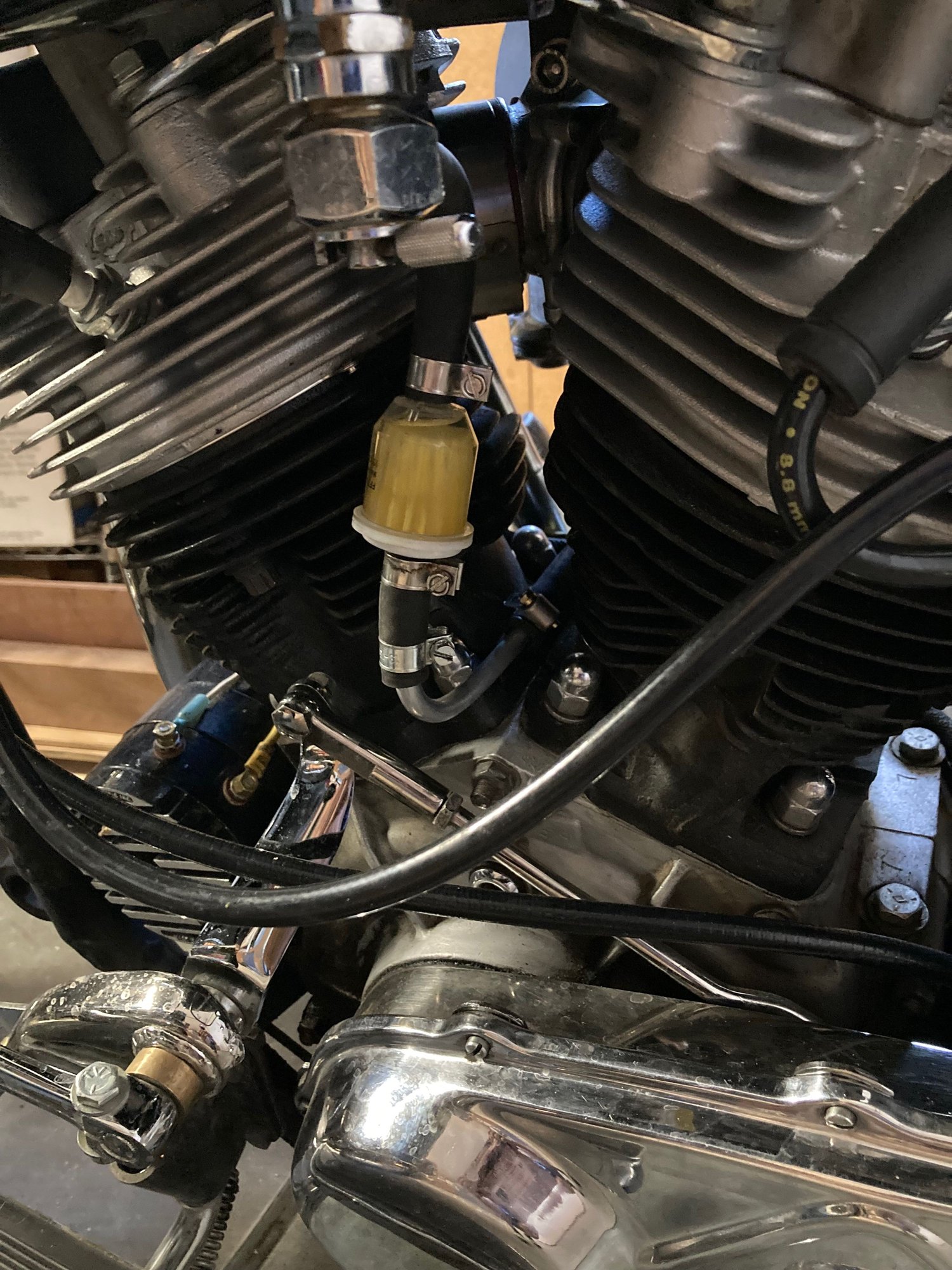

On the jetting: the .031” intermediate is better than the .0295” that was installed—though the latter was partly obstructed. It’s so easy to R&R the carb and it’s always been a touch lean down in ABQ with the .0295” and my air cleaner and pipes, that I figured I’d try it out. I installed an inline fuel filter to avoid getting my jets mucked up again.
