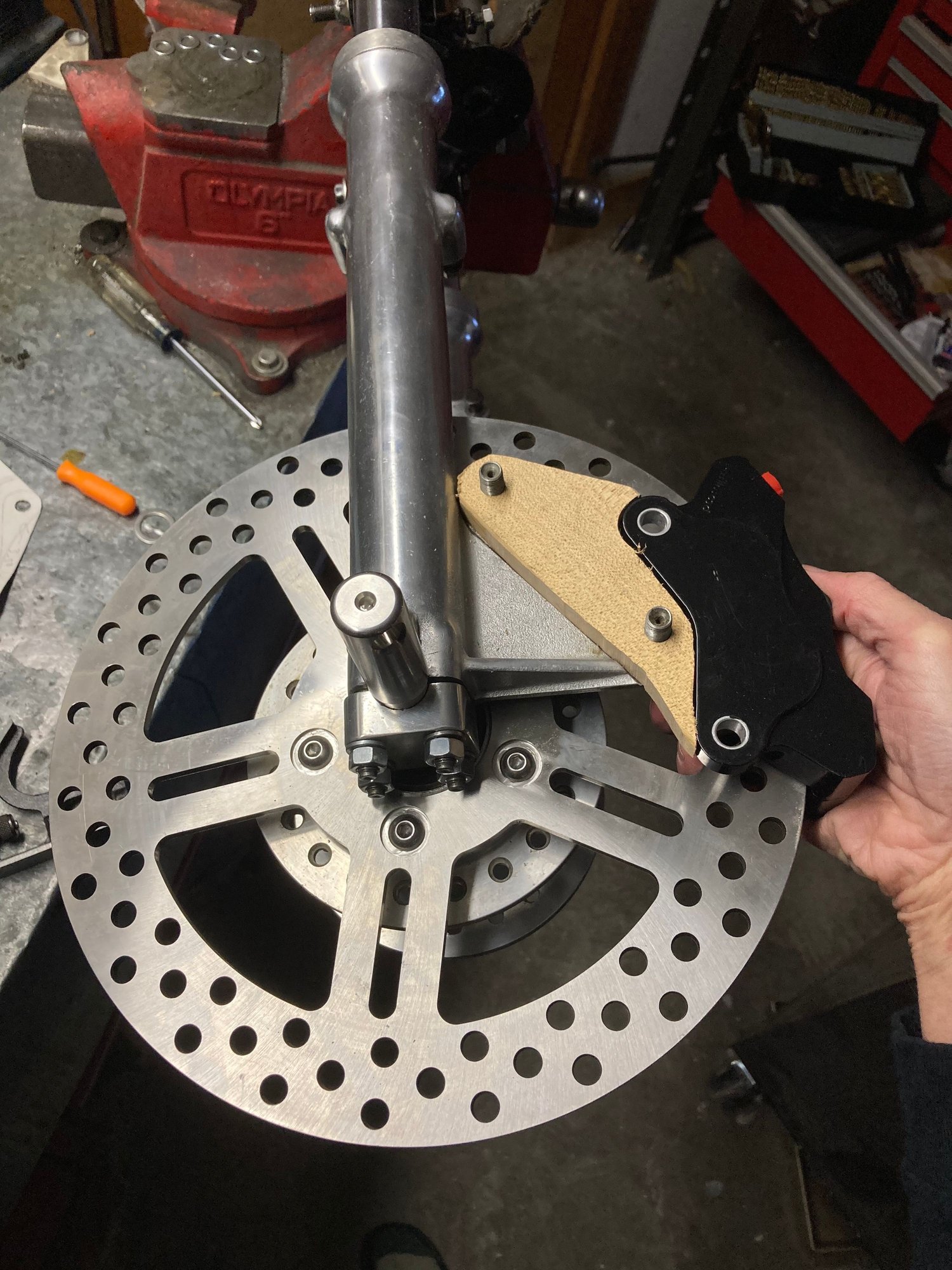

Thanks very much—though they’re actually Borranis (Buchanans didn’t have the Akronts in the right size in stock). That is a DIY front disc kit that I designed to replace the twin-leading-shoe OEM binder on my ’71 OIF (oil in frame) Bonny. Weirdly, no one offers a disc conversion for the ’71-72 OIF bikes, so I rolled my own.
I used ’73-and-later Triumph disc sliders (Max is right about the approximate emergence of discs on Brit twins; the racers used to fit aluminum hoops), a 2000 Sporty hub (just needed a few thin shims), and Harley-spec 11.5” rotor.
I made a wooden prototype of the adapter to mount a Wilwood 4-pot caliper (you can only see the upper profile in the pic; the inward side was the real challenge). Together with the aluminum rim, it shaved 4 lbs off the unsprung weight, and is far better than the drum lump at dodging wild horses coming down through the canyon from my pad to the Rio Grande. I thought the 5-spoke Performance Machine rotor evoked the ‘70s mag wheels, too…

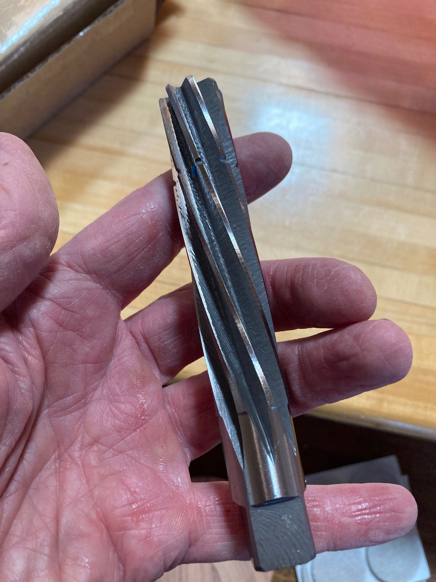

Finally getting reamer in today… but shouldn’t have assumed local stores would have a ball hone in 7/8”. So, yet another delay while 7/8” hone in 240 grit makes its way to me. Ah, well. Used the time to do other stuff I’ve been putting off. Should have her running next week. That’ll give me time to fashion a T-handle to turn the reamer, too…

Curious to see how clean the reamer leaves the bushings. Some touchup may be required, but hopefully it leaves a nice surface with a good fit.

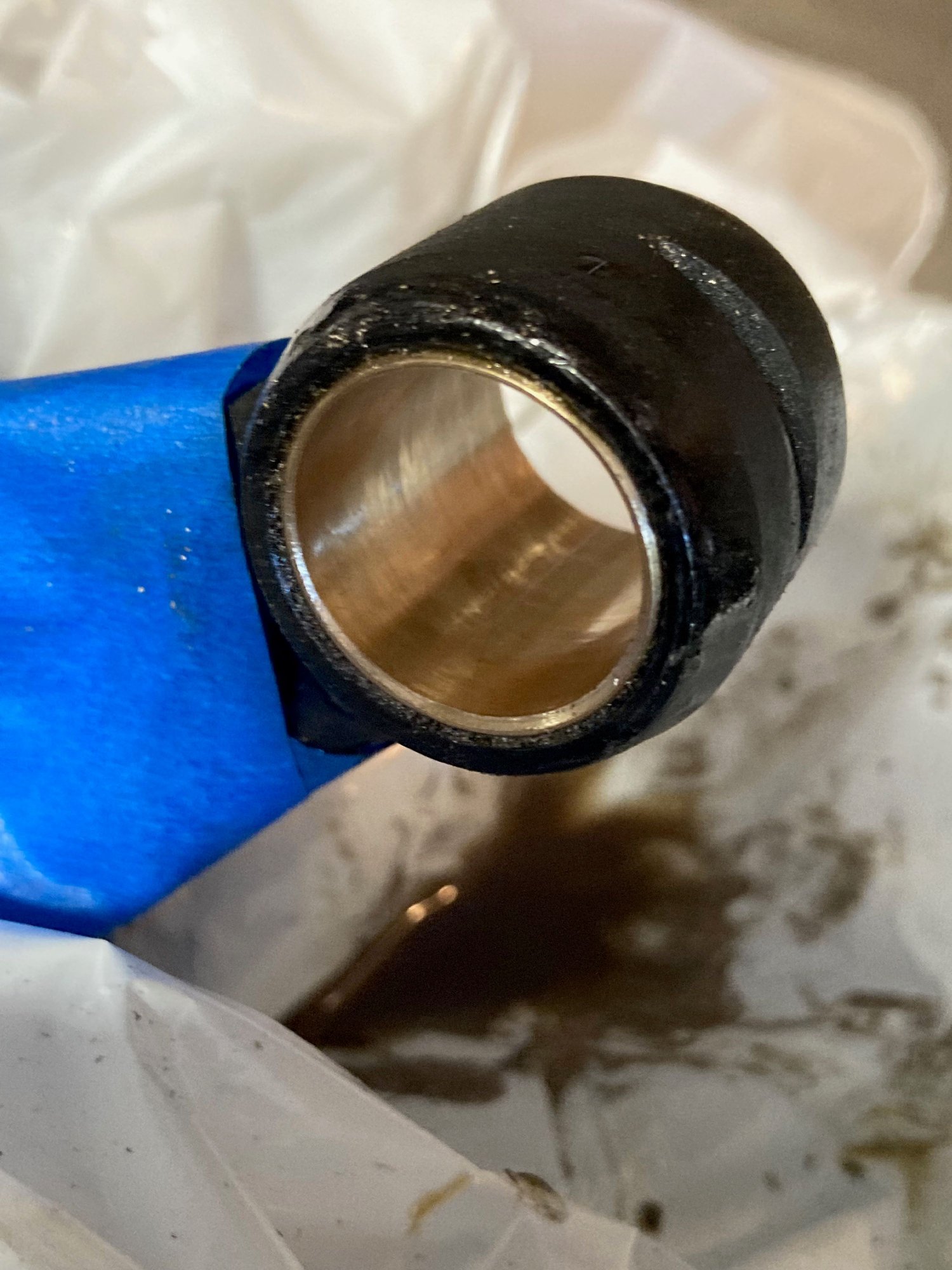

Far from perfect but not terrible. Nobody has a 7/8” ball hone in town, so I ordered one (240 grit) to have on hand.
My only concern is if I hone it to remove the uneven finish, it might loosen up the fit? Right now, it’s near perfect with a singe pass from the application-specific reamer. No rocking and gentle press to get it in...

Heck, I'm sure you got a 1/4 in die grinder. 1/4 inch rod, split the end, 1 inch wide sanding cloth..

If it fits well now, I might cut small stips of fine (320 or finer) sandpaper and lightly remove (polish) as little as possible. Or I might just leave it alone.

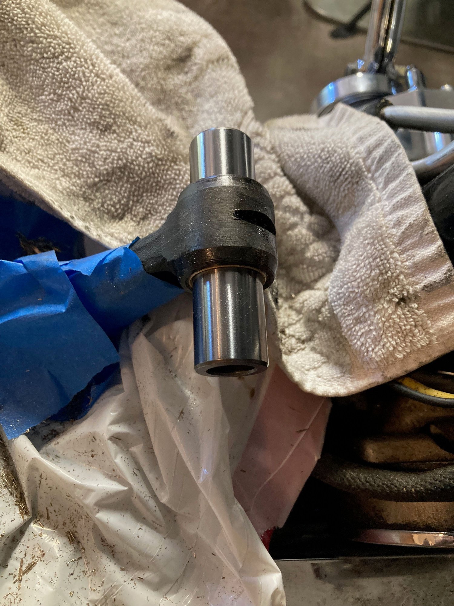

Thanks, guys. Must be something in the air, because my neighbor machinist was over after lunch and said the same thing… so I put her together.

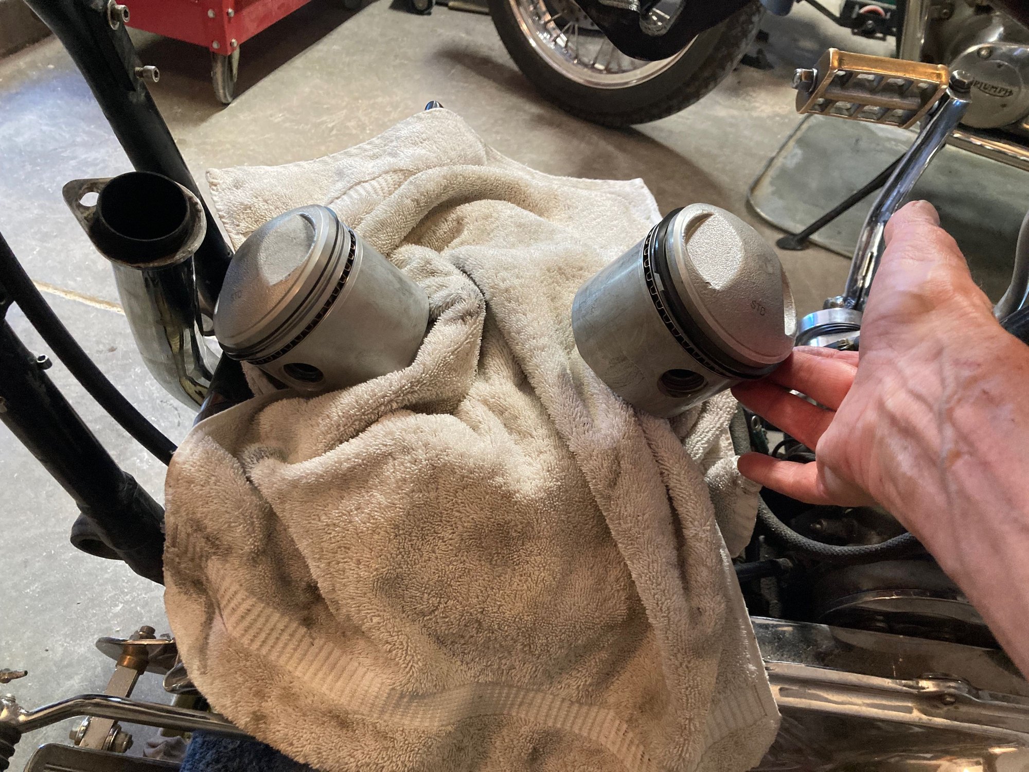

Paul: the manual says to put the side of the piston with a little nub inside the skirt on the wrist pin casting toward the R/H side of the bike… and that corresponds to the side with the divot on the crown. So, you were correct. The pistons do seem to measure symmetrical—at least by my admittedly cruddy mic skills—but this way there’s nothing to keep me fretting while blasting down the blacktop.

As Max mentioned, the wrist pins are not off center. But that isn't always the case, I've seen many KB pistons (including shovel/pan) with wrist pins off center so it's always good to check the documentation.
I have seen on some pistons with a relief cut on the front piston skirt for the rear pistng and the back of the front skirt. I believe the idea was to ensure enough clearance that the skirts to come in contact at the bottom of the stroke.
