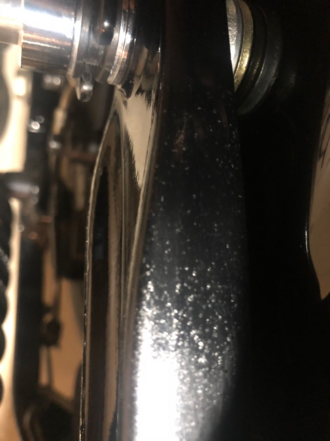

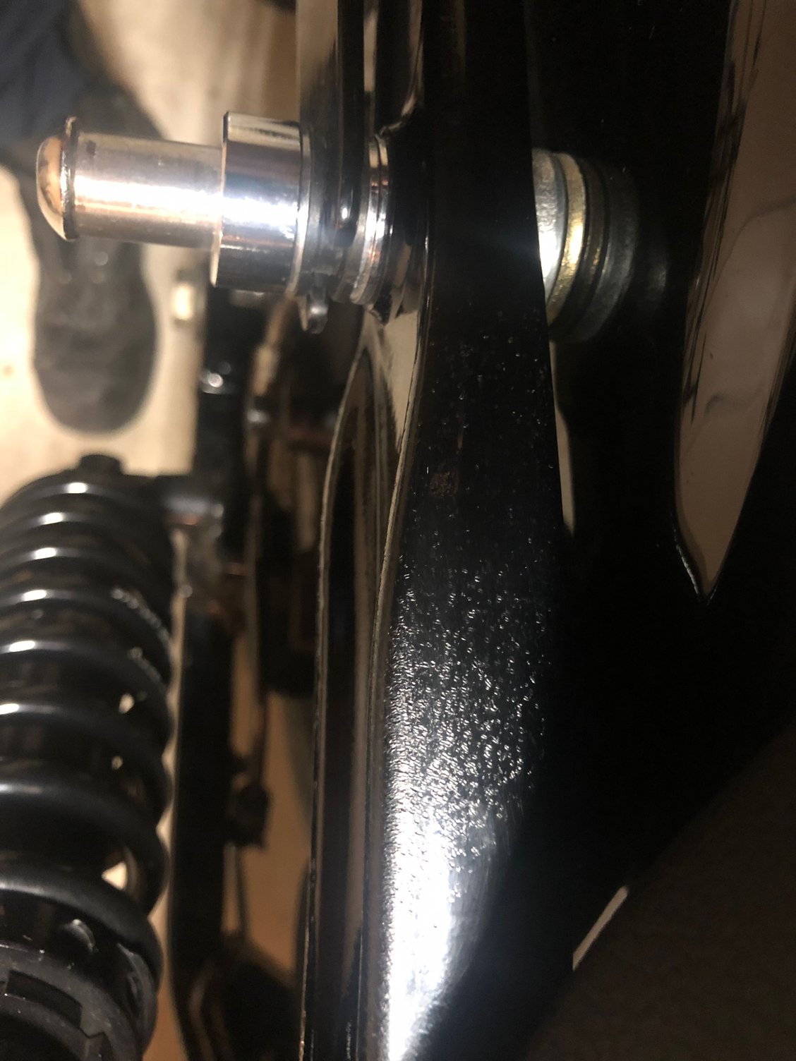

hi. I have a 13 street bob. I have a good 2 inch by 1/2 inch scrape on the rear of my swing arm and also have a lot of small chips/ divots on the frame near the seat. I bought it with most of it except on the swing arm( I think maybe a shop did it).
I am asking what are my best options for repairing it? Pain, touch up? Where to take it if needed? Thanks

I use black nail polish to touch up minor nicks & chips in my frames. Works good and once dried blends in really well.

The good thing is the spot is in a place that's hard to notice. If it was me I would sand it smooth & spray it with some black spray can appliance paint. You can find it at home depot. The stuff is really tough & will stand up to gravel & road debris. Make sure you cover the bike & surrounding areas when doing it. The over-spray from this paint is hard to remove & it sticks to everything!
