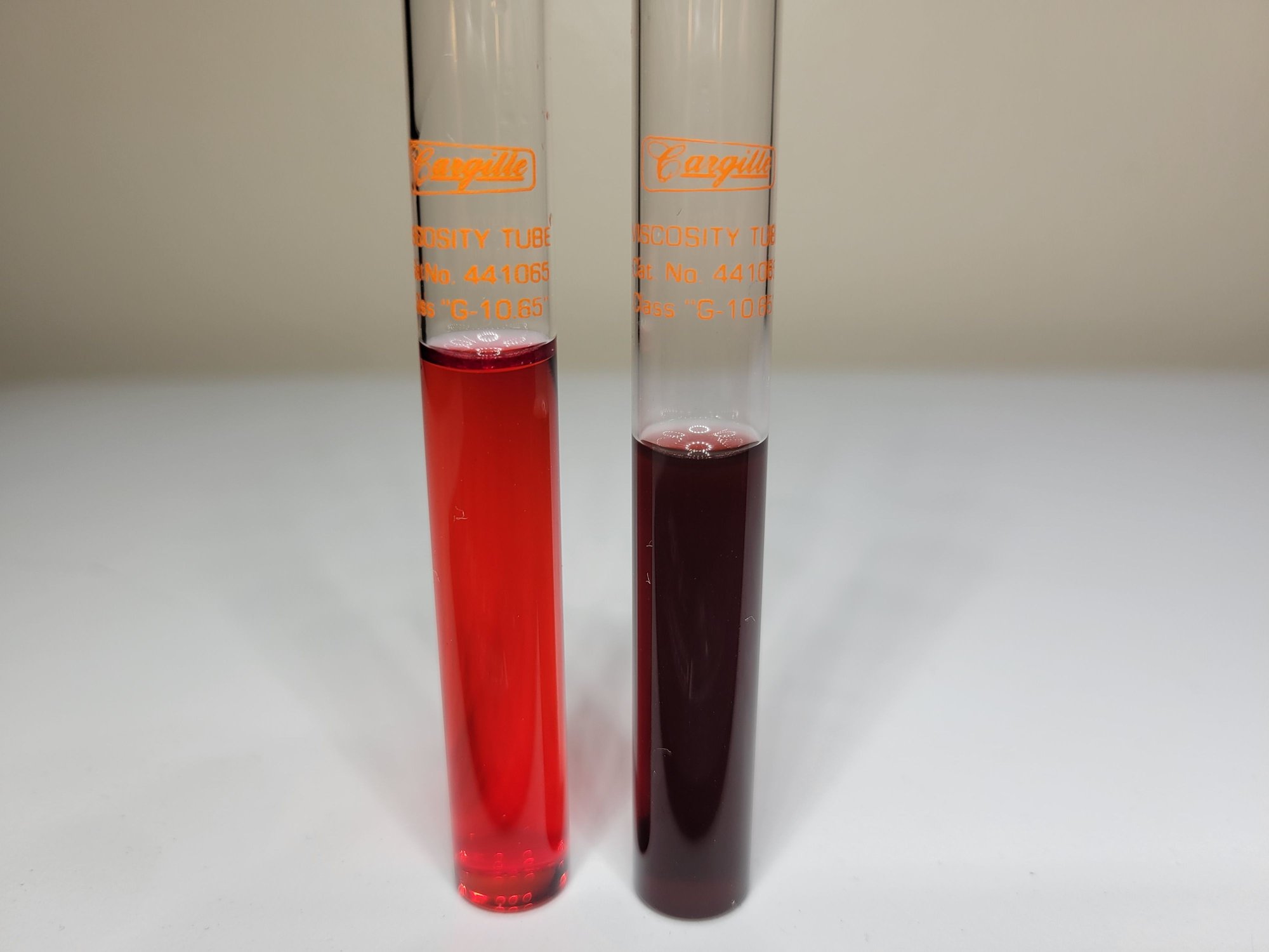

I went and sampled the primary fluid after work today. Yesterday when I drained some, it looked pretty dark. The primary (and oil and transmission lube) were all changed on 04-21-23. This pic was today (didn't ride today). Used fluid has about 1500 miles on it.... this does not look right.
New on the left of course

I once had a classic we where restoring and it was leaking transmission fluid. Replace pan gasket twice before discovering modulator spring had broken and cover had cocked letting fluid run down and appear it was pan.
I had purchased 2 cases of generic AutoZone ATF.
Fast fwd, I used it in a transmission oil change in a Honda. Honda's like there special oil. Within a year, it was hanging in low.
I drained it and it looked like that and was much thicker.
Since you said this was second time using oil, I doubt it just cleaned up primary from maybe Formula+ non detergent gear oil.
Either your stator is toasting it or your clutch is slipping.

Your clutch is slipping..

Here's a thought. Could dirty primary fluid cause the clutch plates to "bind" a little to the point they weren't separating properly for clutch disengagement?
I'm going to change this dirty fluid out with new and try to flush the system out and see if that makes a difference.
