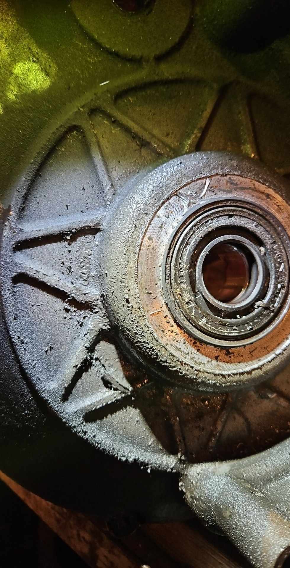

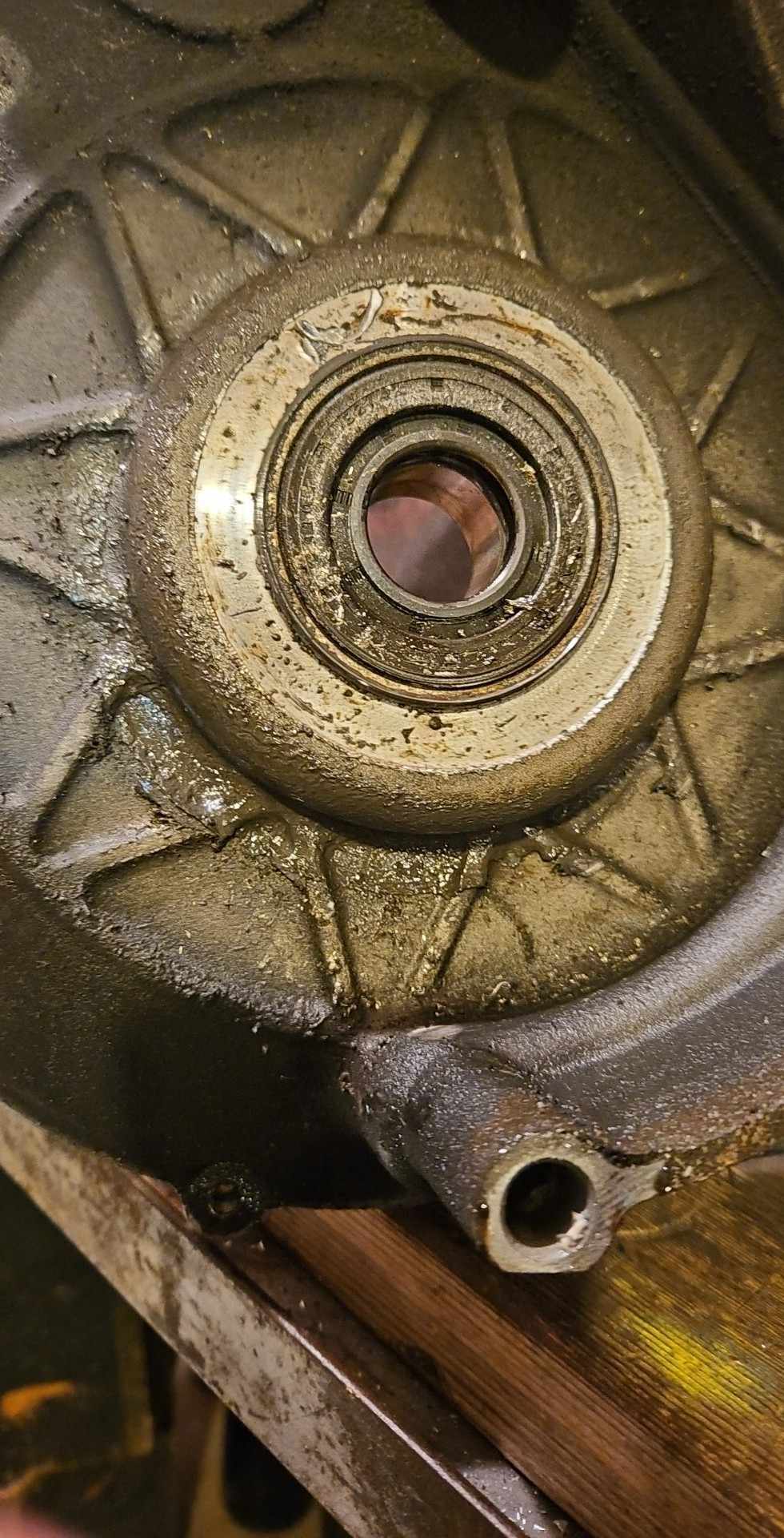

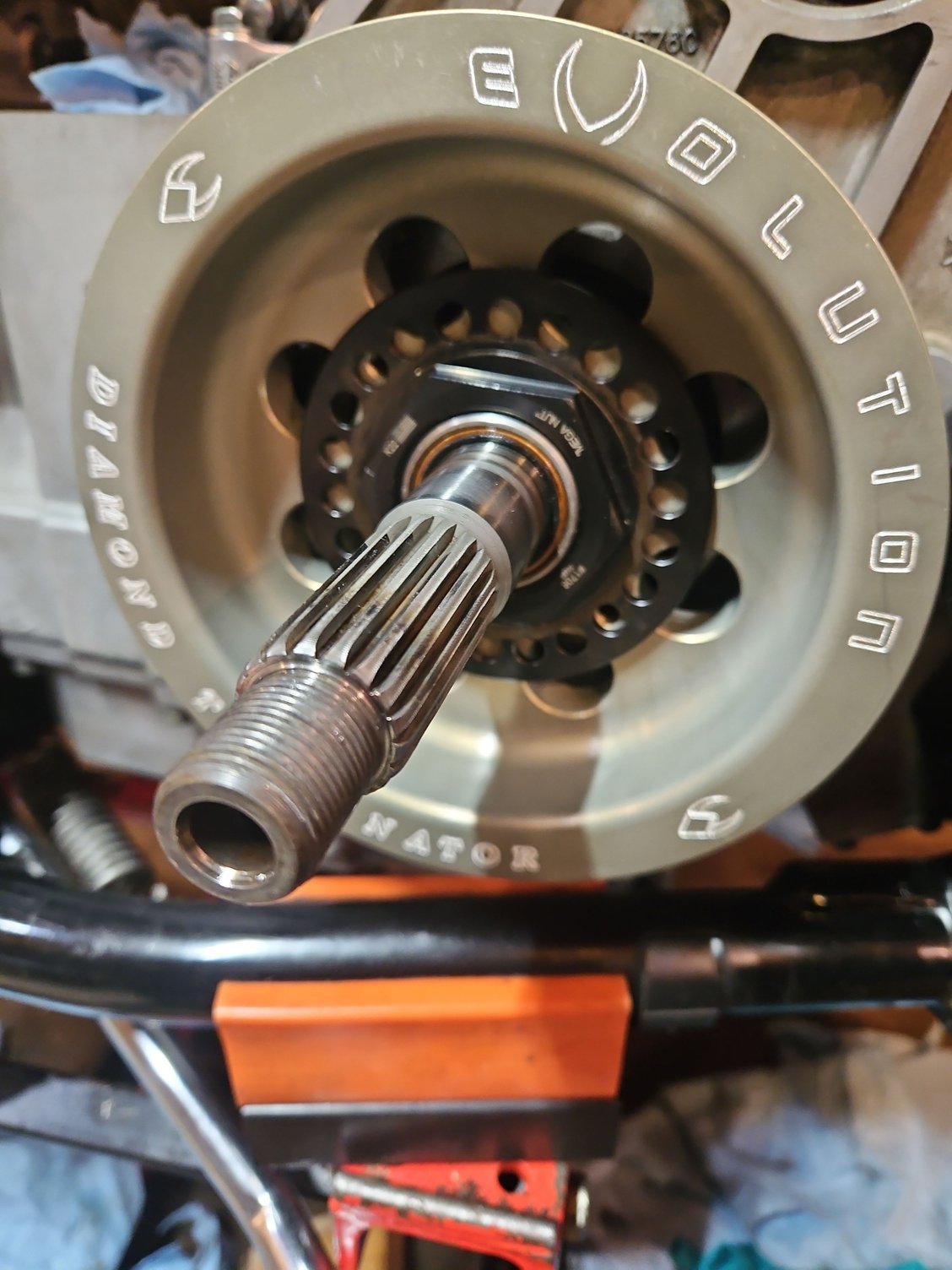

Was all brand new parts cleaned and torqued to spec got about 15,000km what will fix this or upgrade .my only idea is that Jim's big nut and going with aluminum evolution industries pulley lighter rotation mass

2004 ..5speed I used a 34 tooth Andrew pulley for around 7 years no problems I 5th gear looked good when assembled few.years ago and yes its no good now looking for a replacement number for 2004 5 gear main drive now

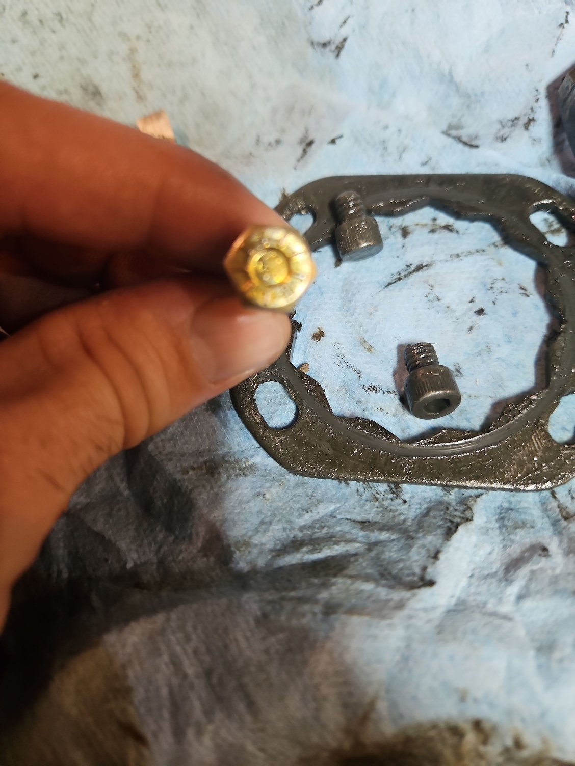

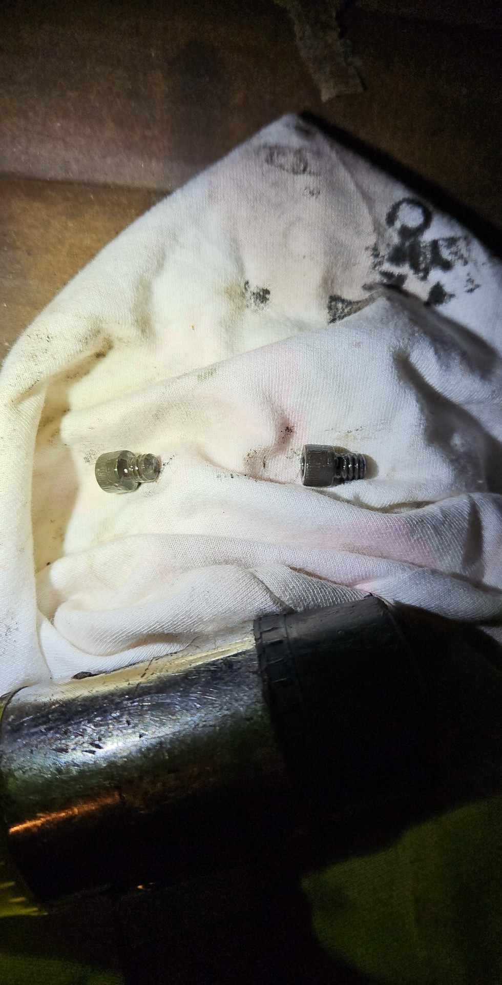

Used grade 9 and seems to be holding
You could use grade 3 there without issue... The tensile strength of the screw ain't the issue..
