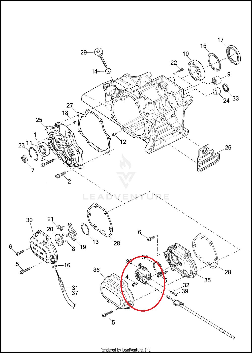

May still have air in the system.
Check your SECONDARY CLUTCH ACTUATOR
Ref: 38
37200023
SECONDARY CLUTCH ACTUATOR W/ 44613-02, 11900035 & 37200034
