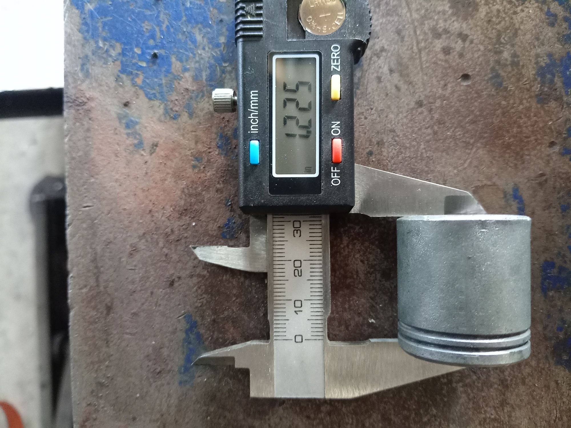

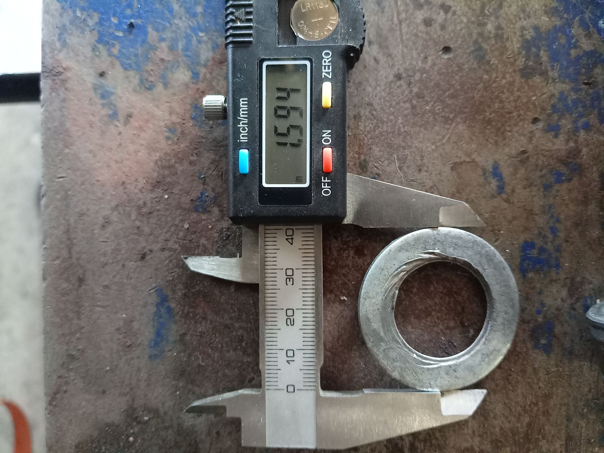

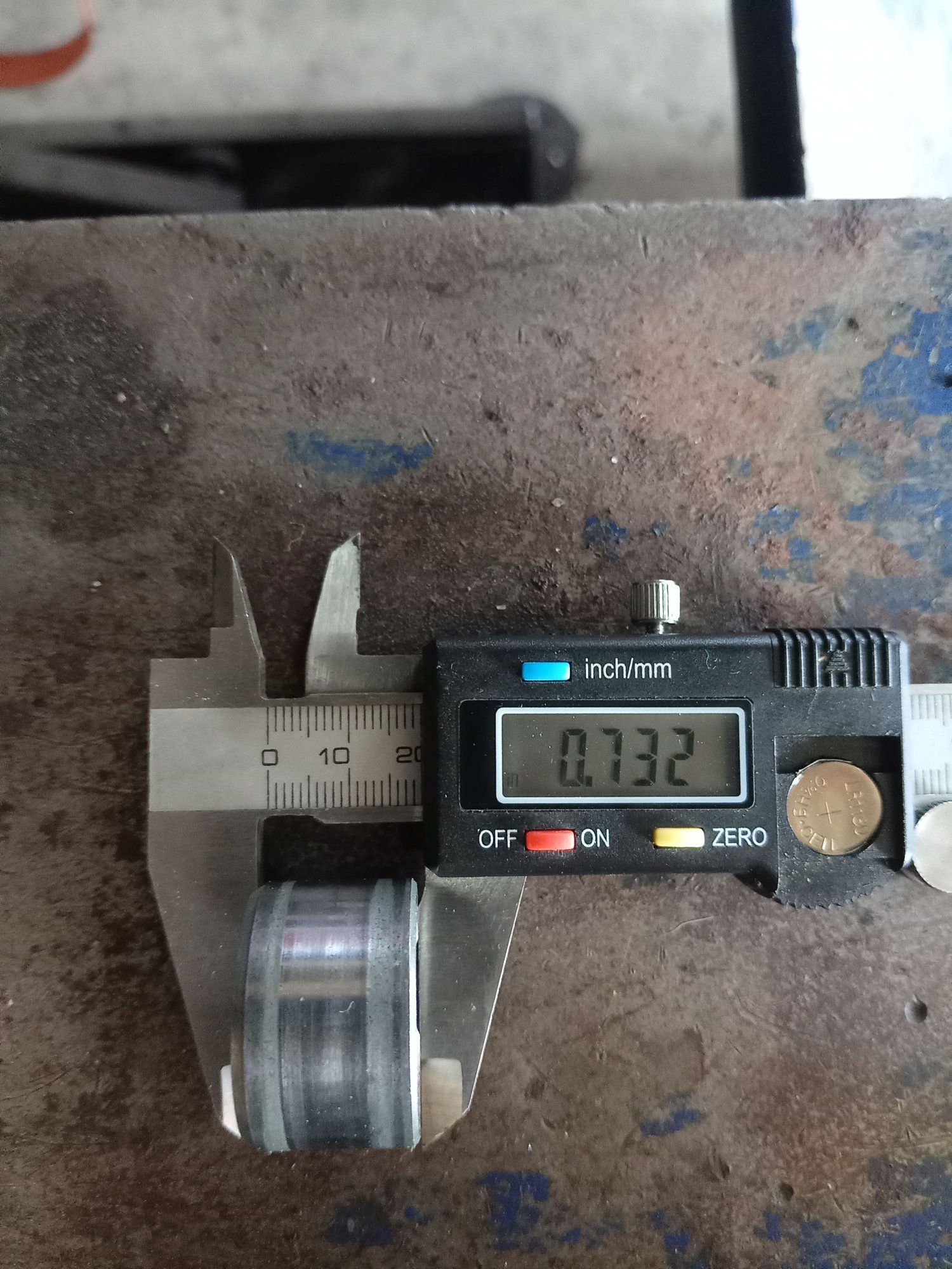

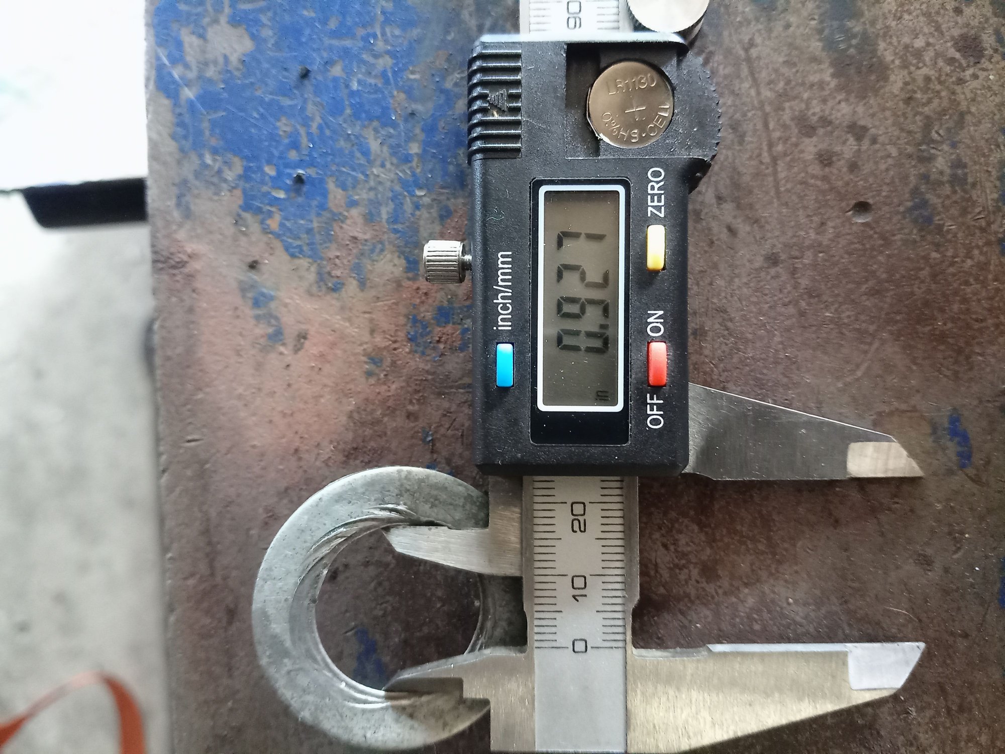

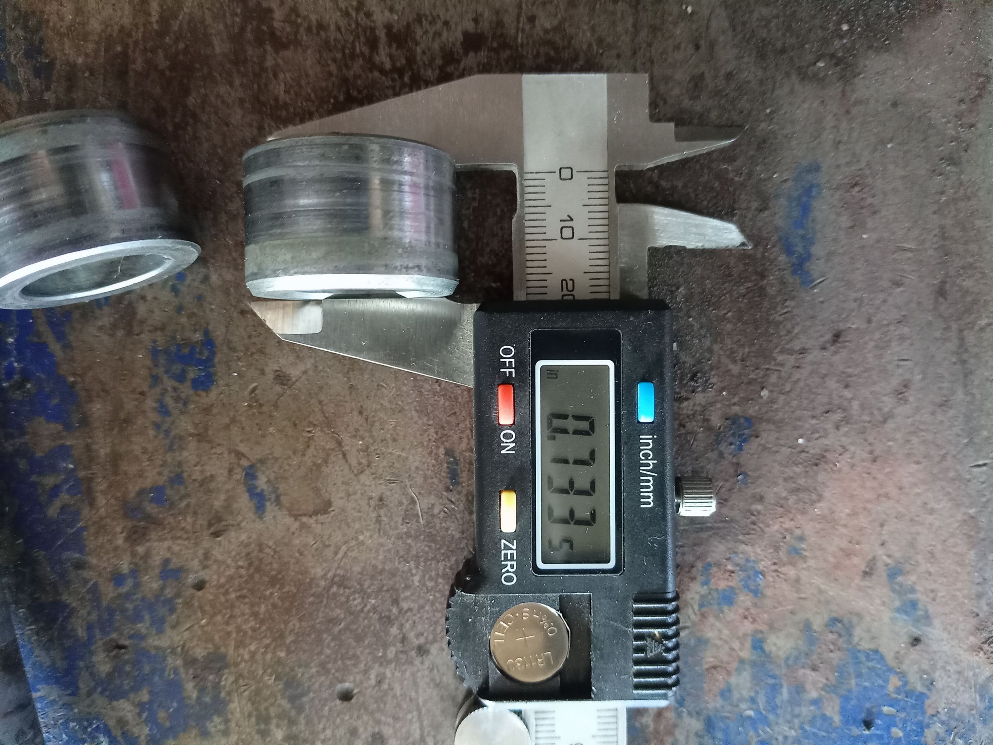

Cannot see the washer thickness measurement, what is it?
Those spacer measurements look ok, about the same as the ones I just measured in my parts stash.

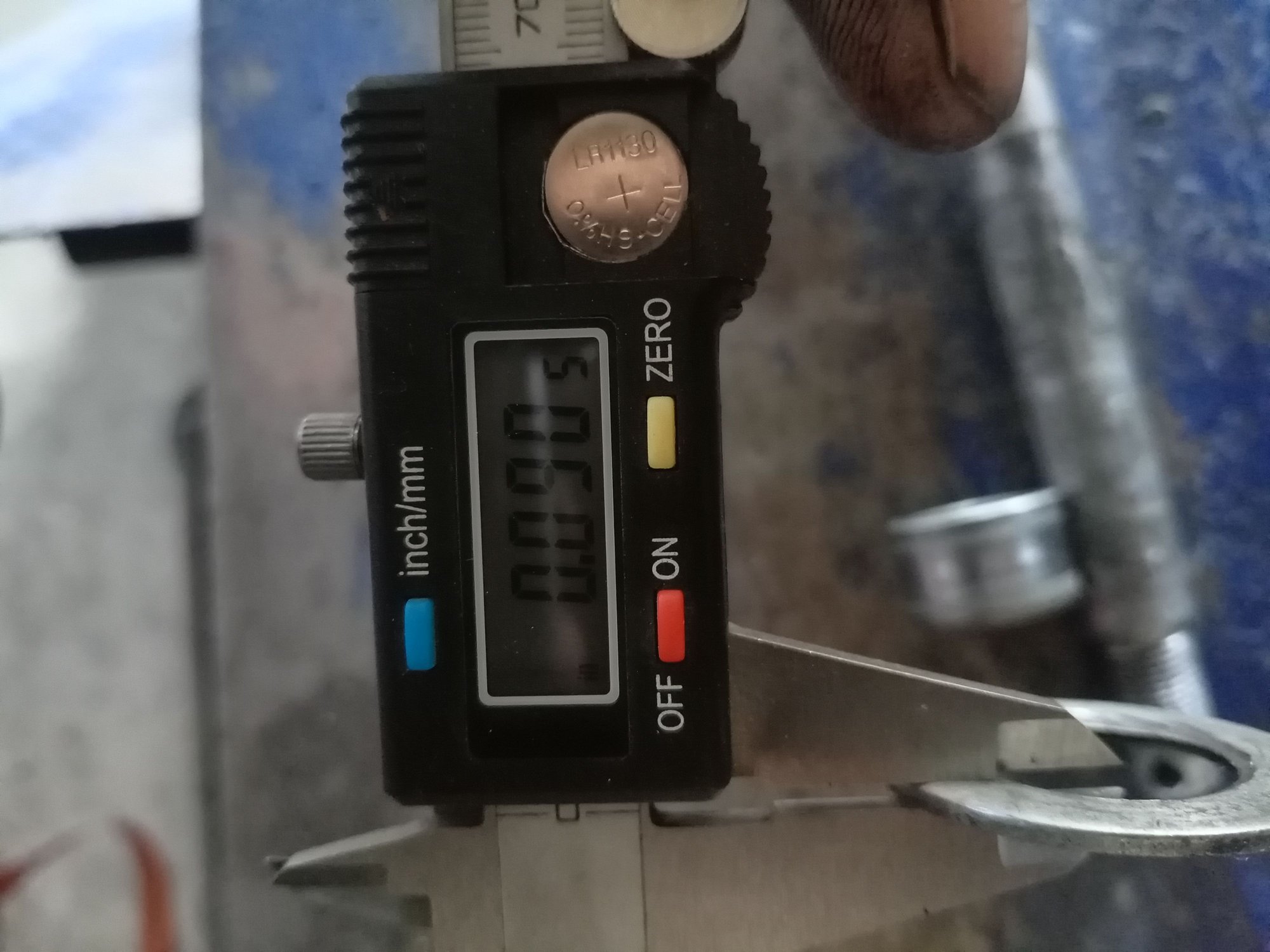

Hi
Thickness is 0.090

The washer on my Softail is .175"
