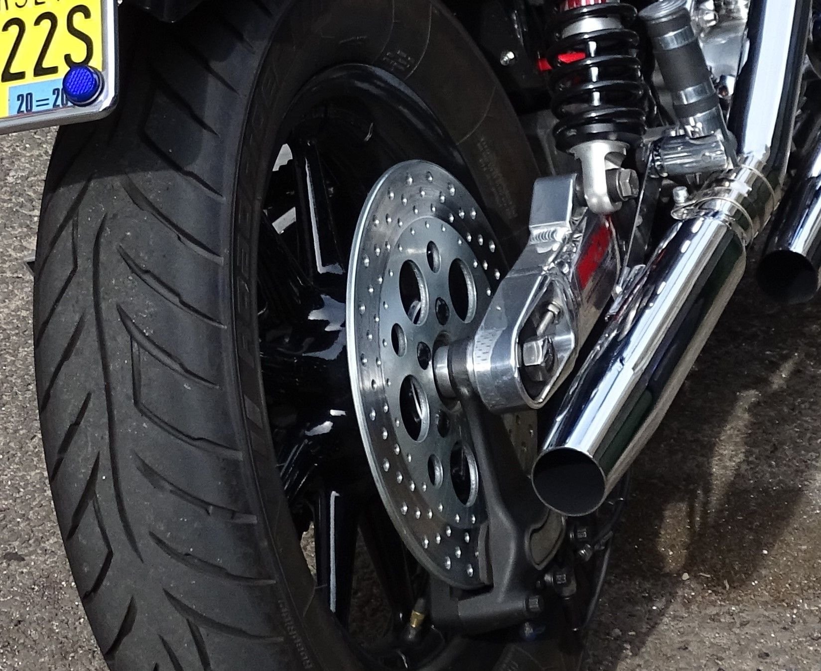

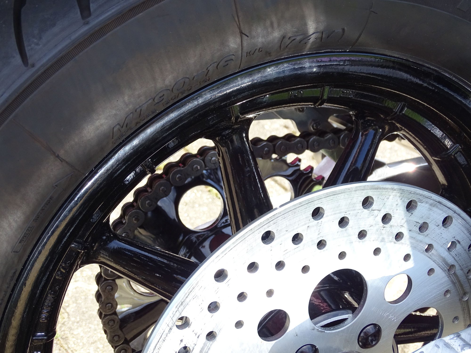

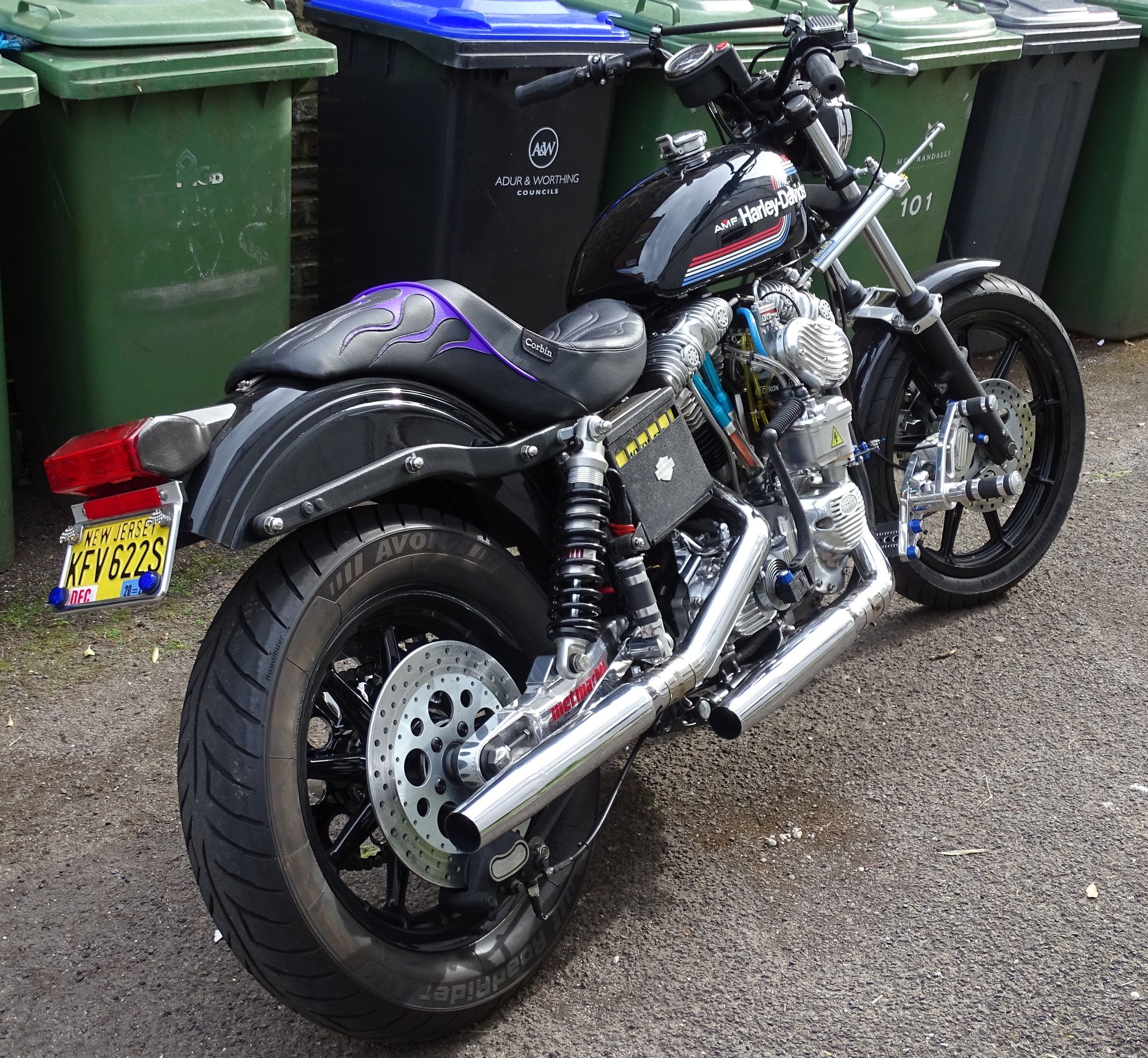

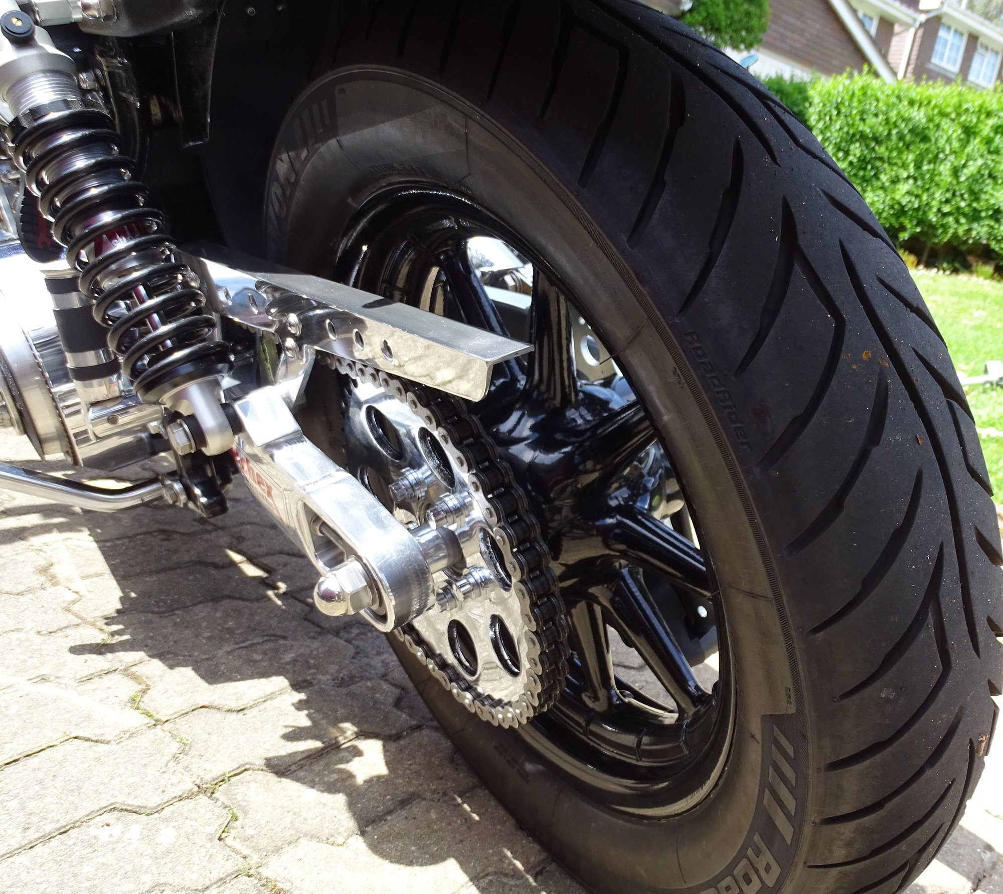

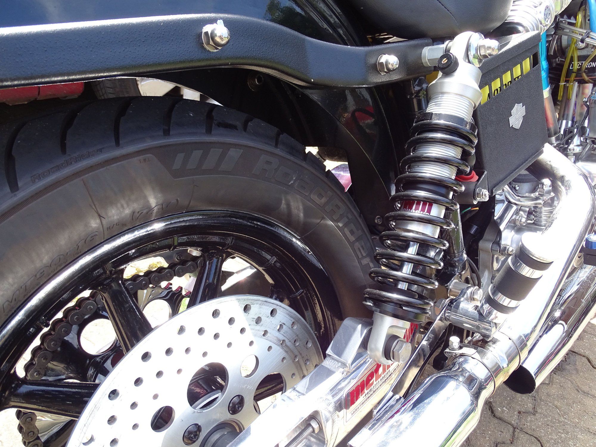

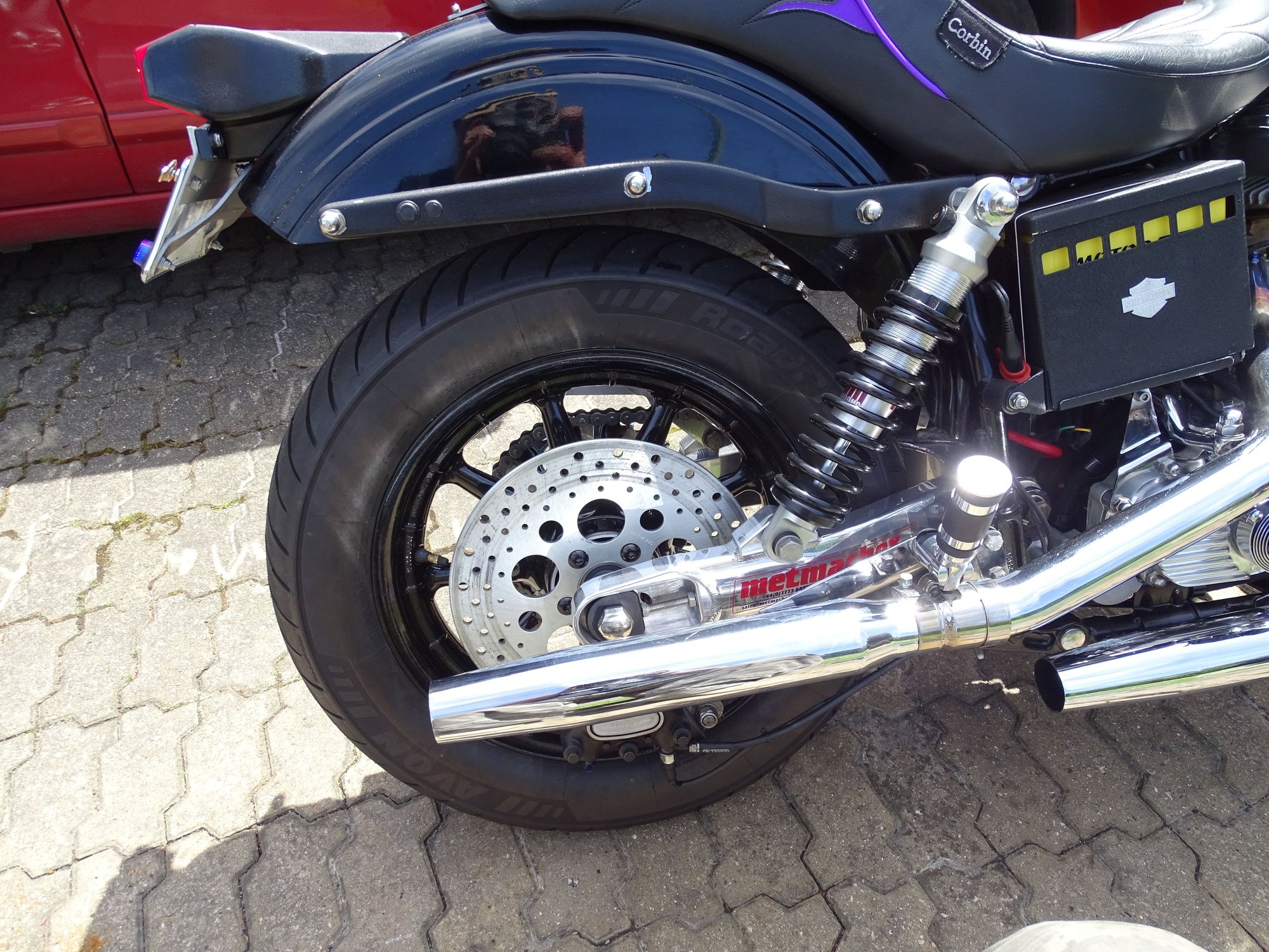

it should fit easily, maybe with a dished sprocket and spacers,... i recently fitted an 04 roadking 'Wagon Wheel to my 78 shovel and to be honest it was almost a drop in unit as long as you dont go for a later Harley 'fat' rear wheel as the swingarm will not allow a fatter rear wheel
