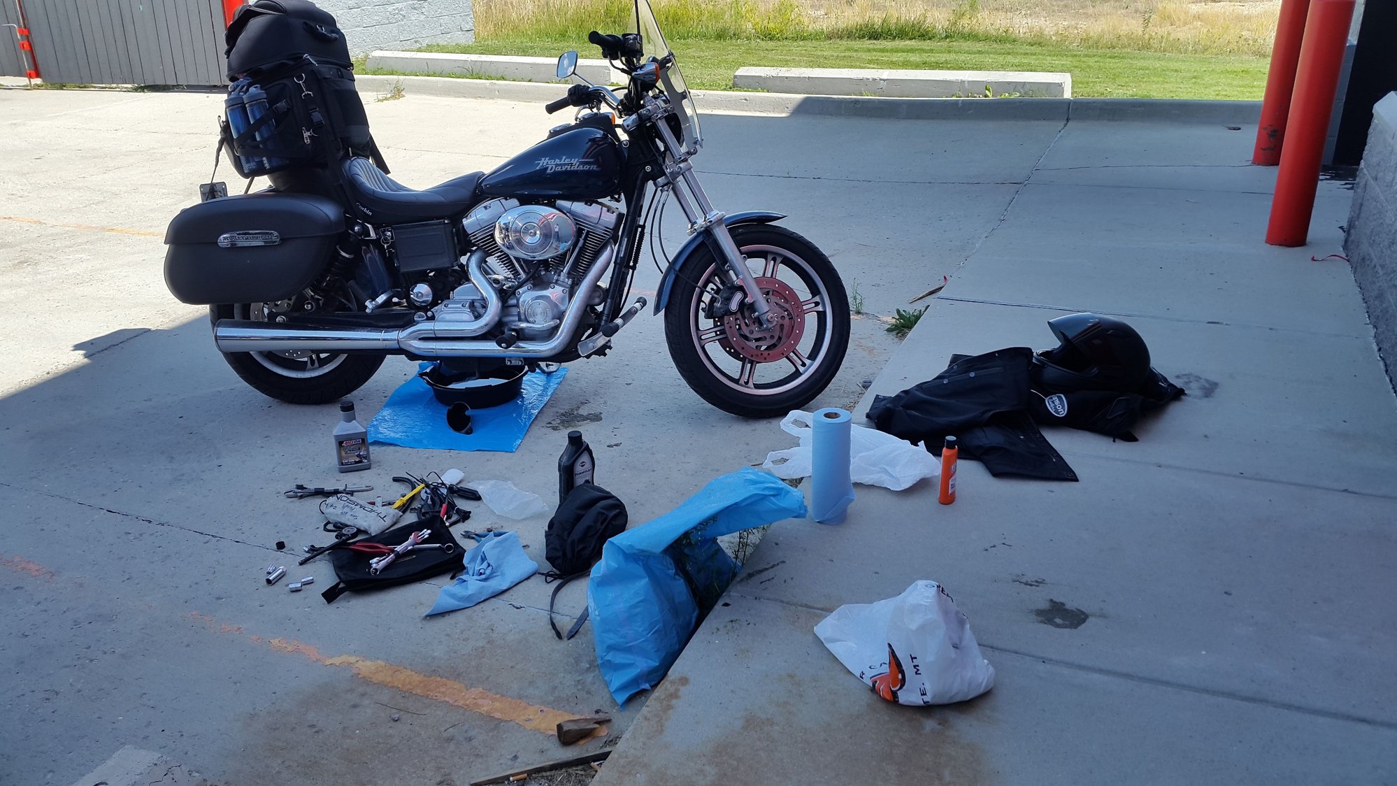

Originally Posted by Nomadmax
Do what I always do. Fix it. This is is almost 1600 miles from my garage full of tools.
The experience gained from straightening out mechanical issues on the road gives you the confidence to enjoy yourself without fretting. The best part is, you get to ride perfectly functional motorcycles bought for less than 50 cents on the dollar because someone was petrified to keep their bike that didn't have a warranty safety net.
What was the issue?

My buddy had a cracked case that got worse the more we rode. He mistakenly removed a tapered tooling plug he thought was the oil drain and he over tightened when reinstalling. After loosing a quart of oil every 30 miles we pulled into Montgomery HD for a fix. No such luck, so he rented a bike. In hindsight he wished he had bought one because it would have been a lot less expensive. Dealer had offered him a great trade value on his blown bike and a big discount on a new softail.

Originally Posted by Harley-Jim
What was the issue?
A header flange, on the pipe had come loose from a poor spot weld via Vance & Hines. The exhaust flange would draw the header flange into the head, but not the pipe. Riding an HD, or any motorcycle for that matter, is about thinking on your feet
