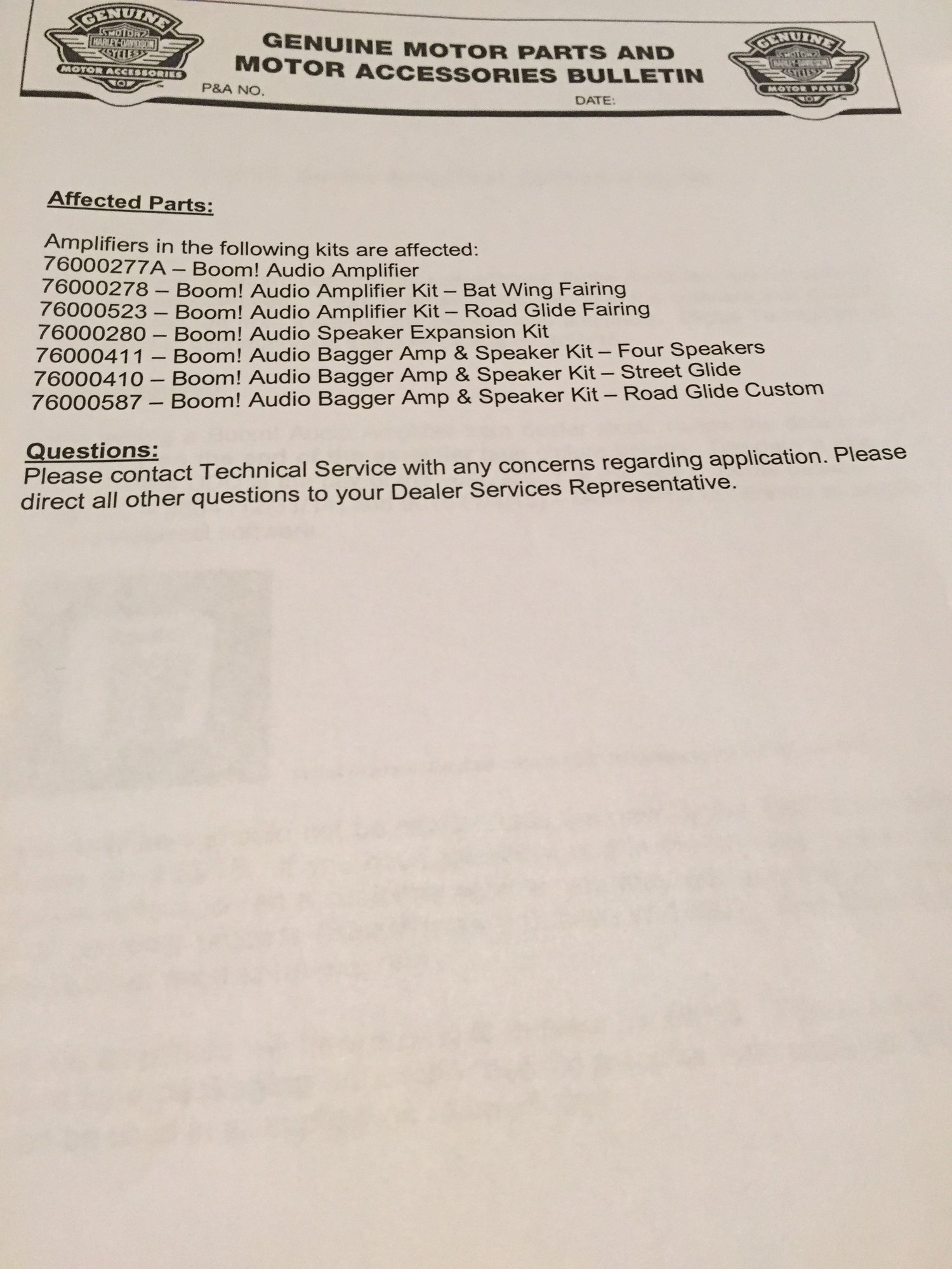

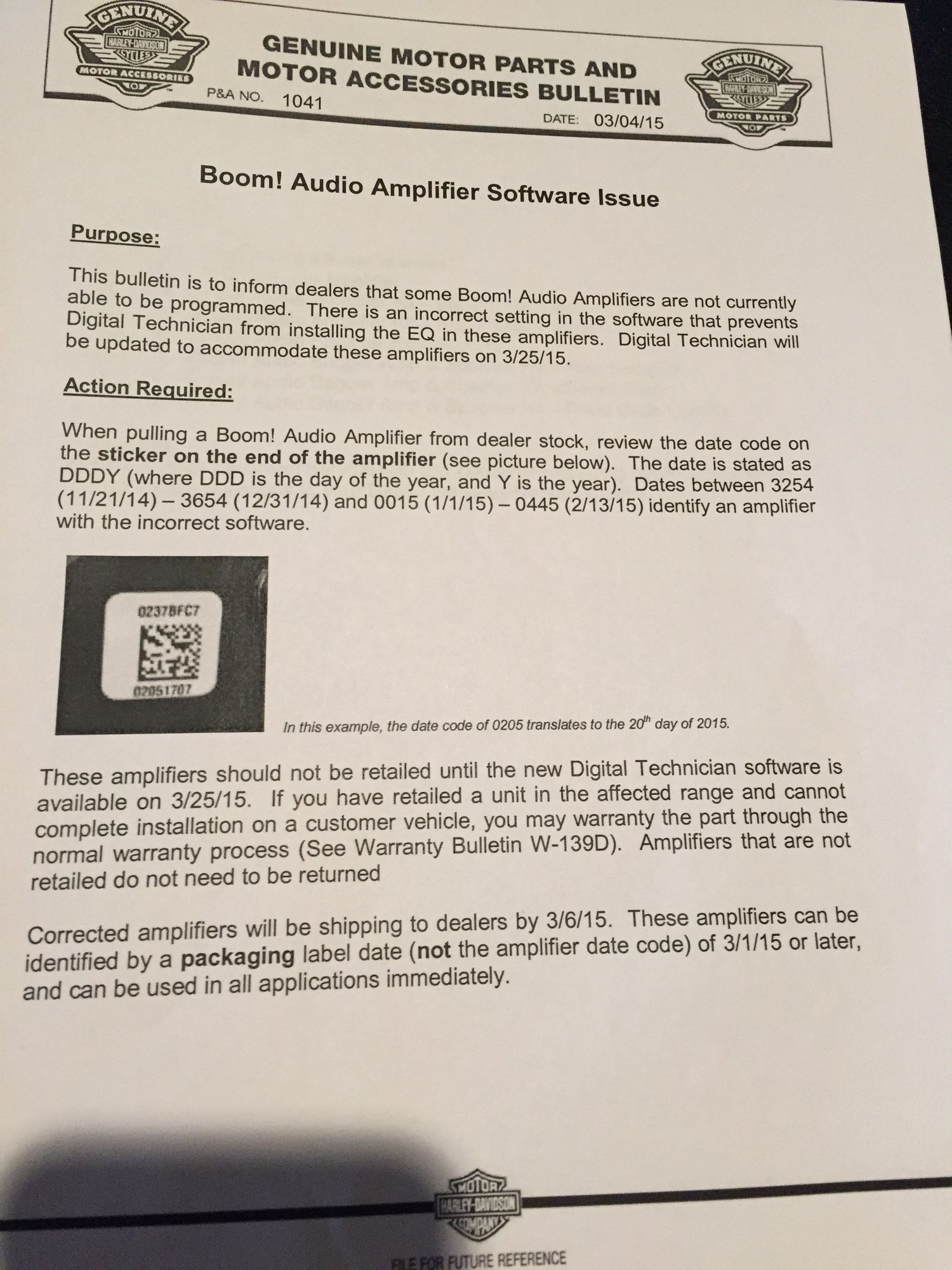

I'm the CreeseHD review on the Harley site that had to have mine removed and refunded by the dealer as well. Apparently there is a "fix" that just came out on March 25th. I still didn't trust it from all the issues I had before. There are some that swear by it, but the majority have had major issues. There was a PA released by Harley saying it is a software flash and amp issue. Make sure your dealer is aware of it. Certain amps could not be flashed. I would spend my money elsewhere.
I was all for the BOOM II after hearing it in the display and after install while the bike is sitting still. If you go more than about 10 mph you lose a lot of clarity. If you get on the highway, you can forget about it. It cuts out and clips. Ultimately it blew the speakers. My dealer stepped up and ordered a new system and was going to install it after March 25th. I decided to just have it removed. The entire process with Harley was a PITA...
http://www.cvoharley.com/smf/index.php?topic=100022.0 Look for the attachment of the Service Bulletin PA I posted on page 6. I'll try to post it. Just read through the thread from the link above to understand the issues.
It may be fine with the fix now, just make sure...
