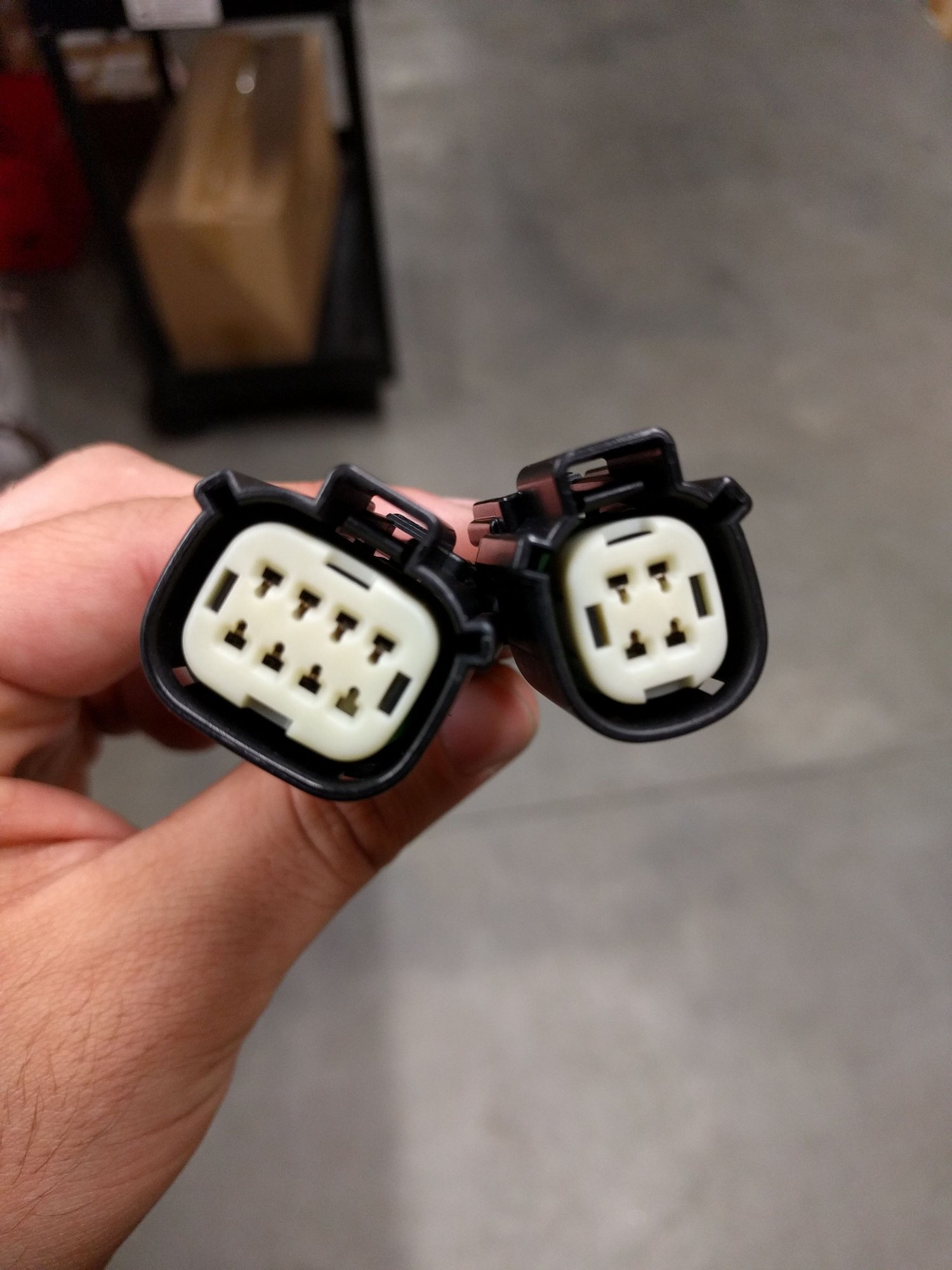

Yes the Boom stage II takes a different plug for the rear speaker crossover pigtail , I believe it’s a 8 pin instead of a 12 pin . I also went with the 4.5” SE Street Cannons which are straight through exhaust system along with a Full-Sac/ Harley Header . Your also going to find out it takes a different wiring pigtail to the rear aux. cooling fan which pulls air from the rear cylinder down past the rear portion of the frame to make it work correctly .

I have a 2018 CVO Limited and upgraded my audio to Boom state 2 within the 60 days. You are correct, the rear pigtail is different as my HD tech found out. This was a couple months ago but at the time there was no part number for it. I imagine if you get your HD parts guy to call the Tech line they prob have the part number now. You can show him these pictures.
