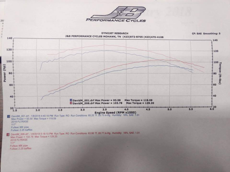

Fullsac is the way to go for performance. For loud CFR or Neighbor Haters. Performance and loud are not one and the same.
I have a fullsac headpipe and fullsac muffler cores in mine. Really wakes it up.

Default Nice dyno
That is an impressive power increase for just a head pipe and mufflers. 10 and 10 is respectable. Beautiful bike. I just had to already go out and buy a new windshield. There was no protection at 80 miles per hour on the freeway. Put a 12in wind Splitter on it and it is better. Thanks for the advice!
