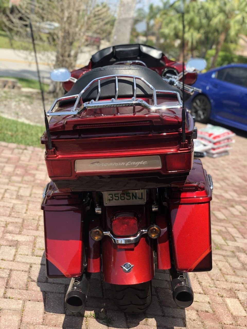

I just picked up a 2013 Road King CV0. It came with VH power duals and RCX mufflers. I am looking for a different set of mufflers as these seem very mild sound. I have set of tridents and full sac on my 103 SG now.

CONGRATS! Good looking bike.
Why not stick w/ the proven set up like you had in the past? Although I currently have a Drago's Dracula II 2-1 pipe w/ ghost on my Rig. I STILL feel that Fullsac is the Best Bang for the buck w/ proven results. In fact, one of these days I am going to put my Fullsac "D" X-Pipe back on my Rig.

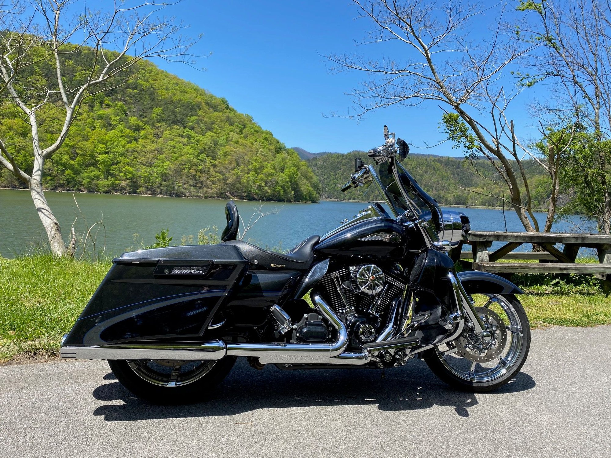

Running complete Fullsac system on my 13 CVO king. Really sounds good especially with the increased compression in the built motor.

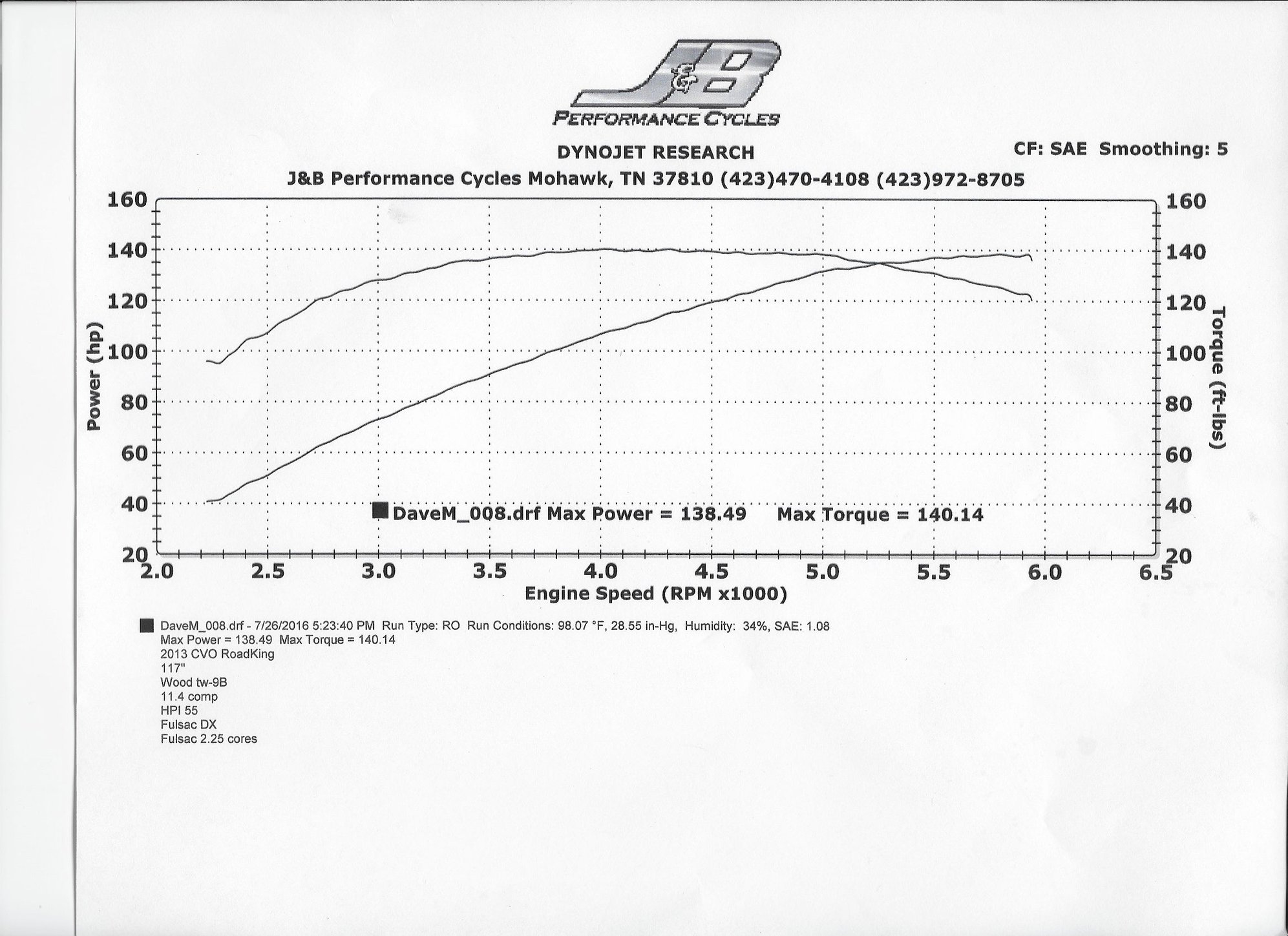

I put HD 117 cylinders on it, CP pistons, Heads were done by HD Street performance and compression set to 11.4 to 1. A woods TW-9B-6 cam and woods Alpha lifters. HPI 55mm throttle body and intake manifold with hd 5.3 injectors. Then a Fullsac DX head pipe with his 2.25 baffles in the CVO Mufflers. Then the AIM VP-SDR clutch

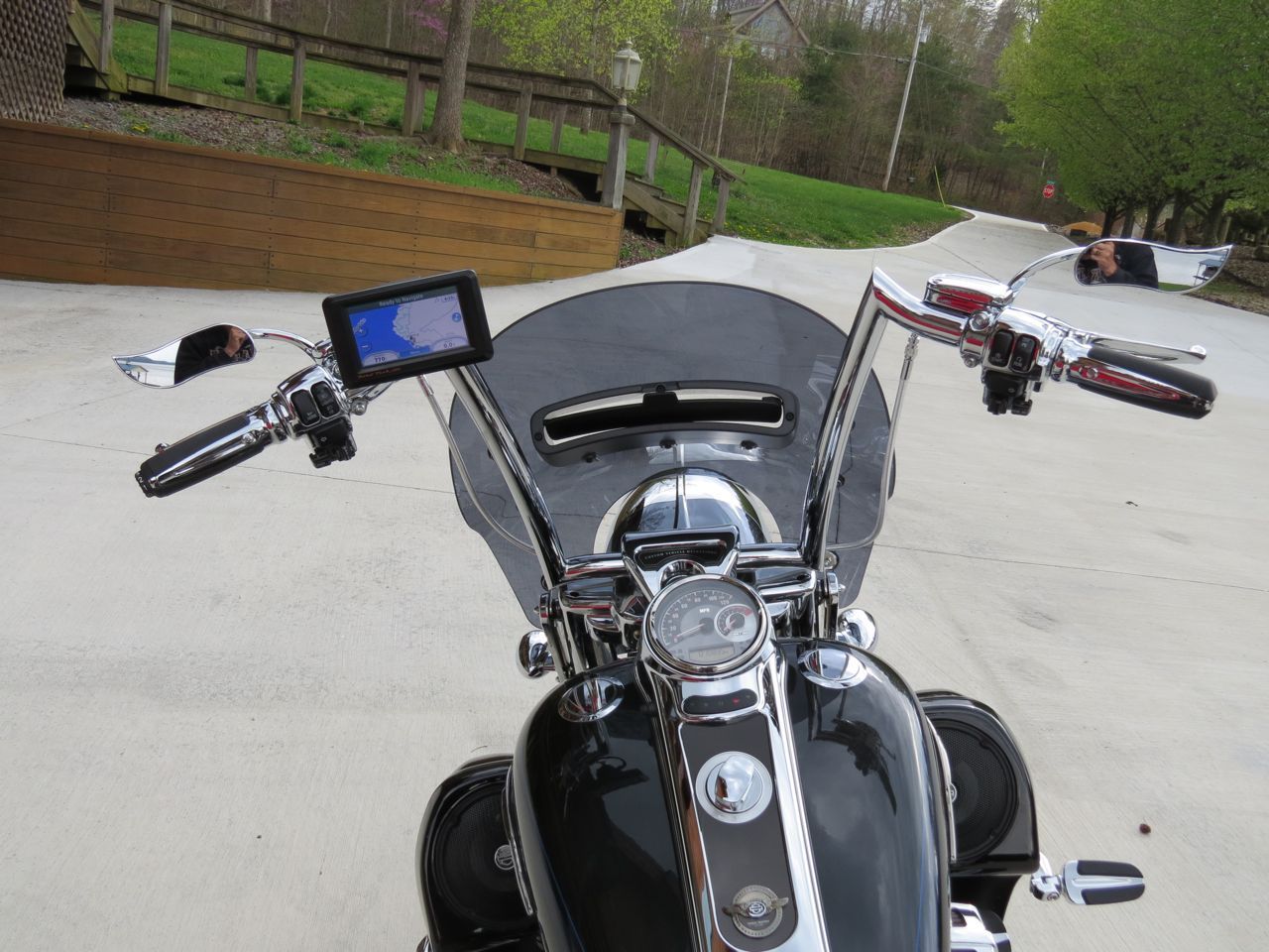

Other changes are 14" Yaffe Monkey bars, CVO Ultra heated grips, turn signals moved to forks, Ohlin 13" shocks in rear and Legends front suspension.
Bike has never been trailered, and its been to UP in MI, and Key West. Total blast to ride, and smoother than stock.

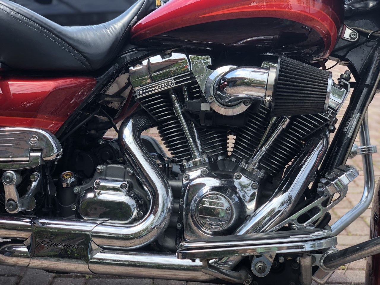

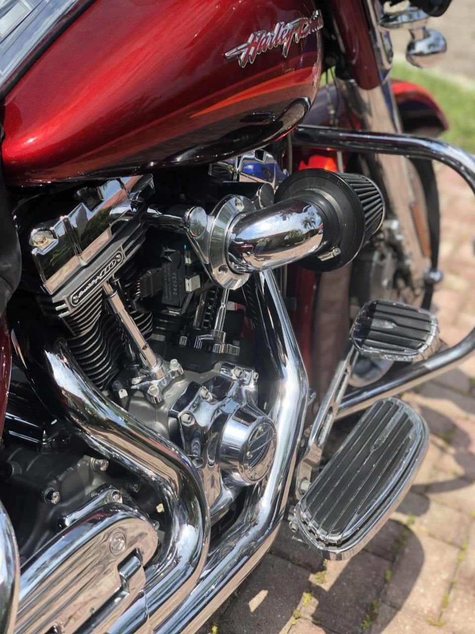

I'm running Rinehart true dual headers with the 3 inch Rinehart slip-ons. Love the noise and the few subtle pops when you are really on it.
