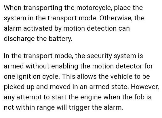

Put the security system into transport mode.
What's the benefit of transport mode for storage? The security system is still armed (red light flashing), however the motion detector is disabled. The OP states the bike will be stored on a jack, which I assume will keep the bike motionless.

Maybe I didn't have to put it in transport mode? I just recall going out to the garage other times and want to move my bike, and accidently set the alarm off because I didn't have the fob on me. That being said, maybe if I just had the Fob on me when I put the bike on the jack and got if off the ground the alarm wouldn't have went off after I covered it and walked away? (I'm honestly not sure, never tried it.) I assumed if the bike was upright and the fob was not in range it would set the alarm off? Maybe it's just the motion of standing the bike up without the fob. I probably would have been fine thinking about it now. Either way... It's all good.

Gotcha... I think it will be just fine. I didn't disconnect anything. I do have a trickle charger on it. My concern was the bike being upright without the fob in range. I thought it would set off the alarm, but given the other replies I don't think it would have. I think all I would have had to do is have the fob on me, jack it up off the ground, cover it up, plug the trickle charge in, and good to go. I got it in transport mode now... but that won't
hurt anything in my case.
