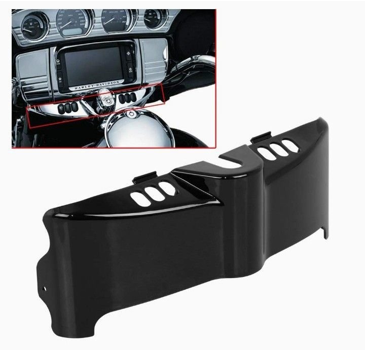

The video is showing a 2014+. The OP's 2013 fairing cap doesn't have the cutout above the switch. The only way to remove the fairing cap to access/remove the switch assembly is to first remove the switch ****.
2014+ fairing cap.
2013 fairing cap.
