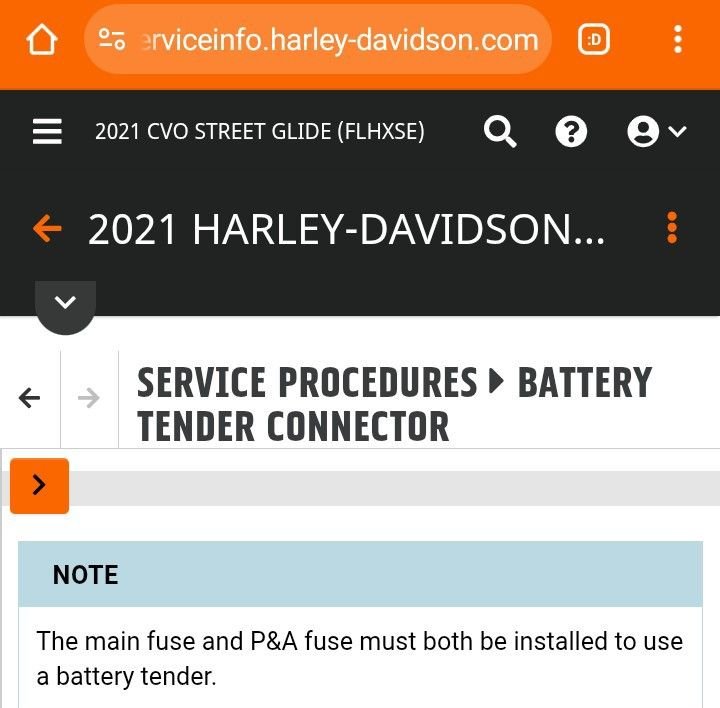

First off, ensure the 20 amp P&A fuse is installed and functional (not blown). Below is an image from your Owner's manual.

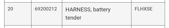

The part you need is 69200212. MSRP is $11.38. Unfortunately, it's not plug & play. It's necessary to cut the defective connector out, and splice the replacement into the main harness.
