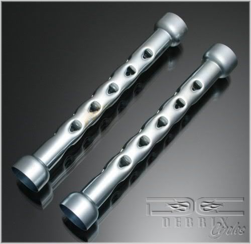

I have not tried those specific ones but I was trying to find a solution to quieting down my my V&H Big Radius pipes on my Ultra and this is what I did. After trying the "Quiet Baffle" by V&H and being disapointed I tried to modify them by adding an additional chamber and they still were a bit to loud for my taste. The next thing I did was to buy a 2" baffle that had the "can opener" look
I covered these with fiberglass packing that I had bought from V&H and they got giant quiet, so much so that I used a 1/2 inch steel rod to drive through the baffle to open it up a little more and it was just the sound I was looking for. I got these baffles on EBAY for under $30.00 shipped to my house.
