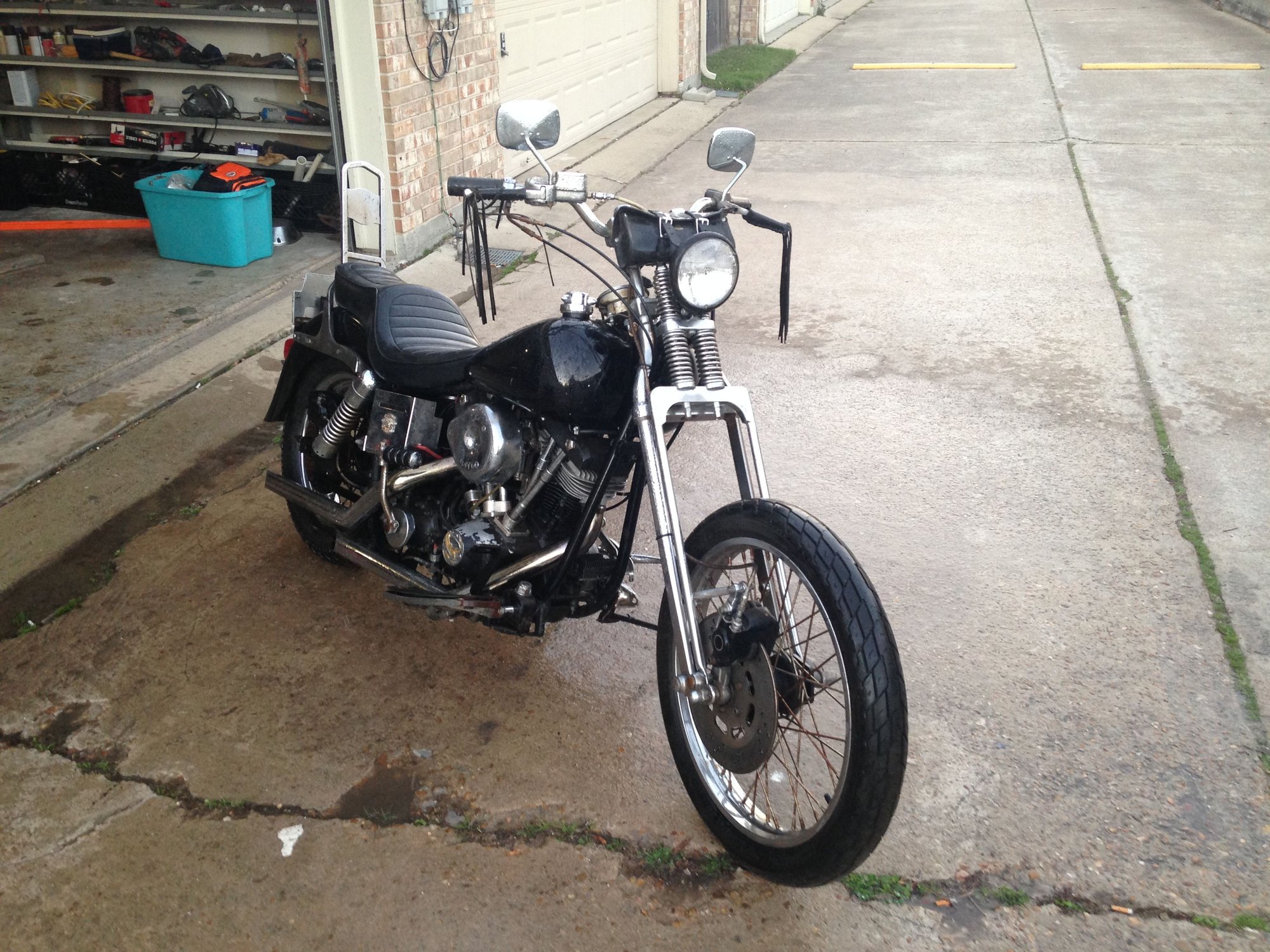

Old Feb 10, 2015 | 08:24 AM
73FXHD's Avatar
73FXHD
6th Gear
Joined: Feb 2015
Posts: 11
From: houston,texas
Old Feb 10, 2015 | 02:09 PM
MIKE93SVT's Avatar
MIKE93SVT
Joined: Oct 2010
Posts: 534
Likes: 8
From: DeRidder, LA
looks like it has good potential.
i'm about 3 hours from you in Deridder, LA. if you need anything done that you can't handle, let me know. happy to help and toss it on the lift.
mike

Old Feb 16, 2015 | 07:50 AM
Racepres's Avatar
Racepres
Posts: 8,603
Likes: 3,374
From: Cental, MI
FWIW that sure looks like a DNA springer.
be very careful and do a thorough inspection before each ride...
Or if Not DNA, Have some fun cause it looks pretty Neat...
