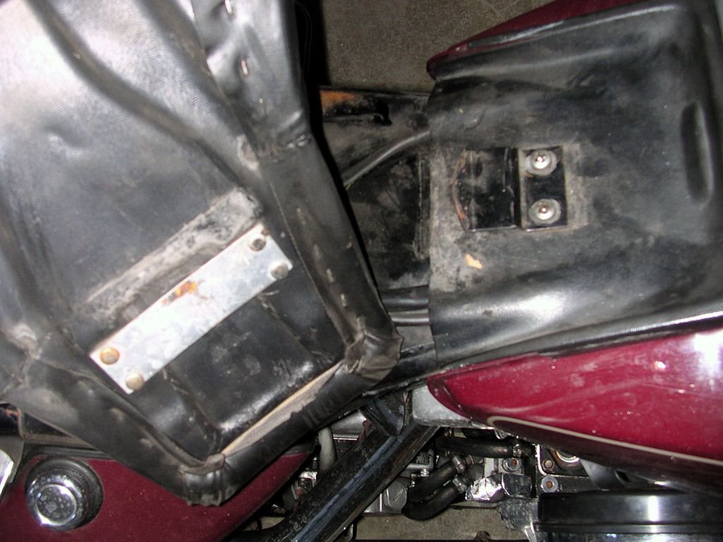

Yes Racepres take a pic if it's not too much trouble. Are the bracket bolts hidden under the rear of your tank?

Here Ya Go...
You can see the screws holding the Pan. or dish or Whatever!!!
