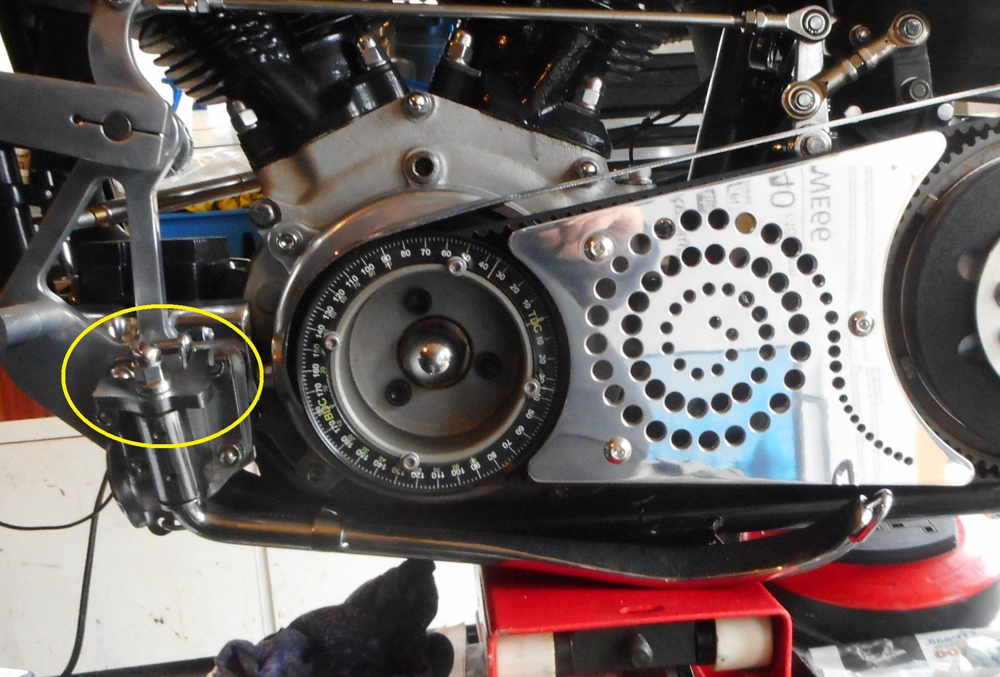

How are you guys keeping the stock mounted kickstand from hitting the inner primary or belt? I am trying to avoid running the kickstand behind the primary like I've seen on some.
The other bikes I built with open primaries, I weld on the tab to run the kickstand underneath the inner primary. However, it's near impossible to figure out the geometry of the weld to keep it from leaning too far, or standing straight up. I know there's someone on here that knows what I'm talking about and has a solution!

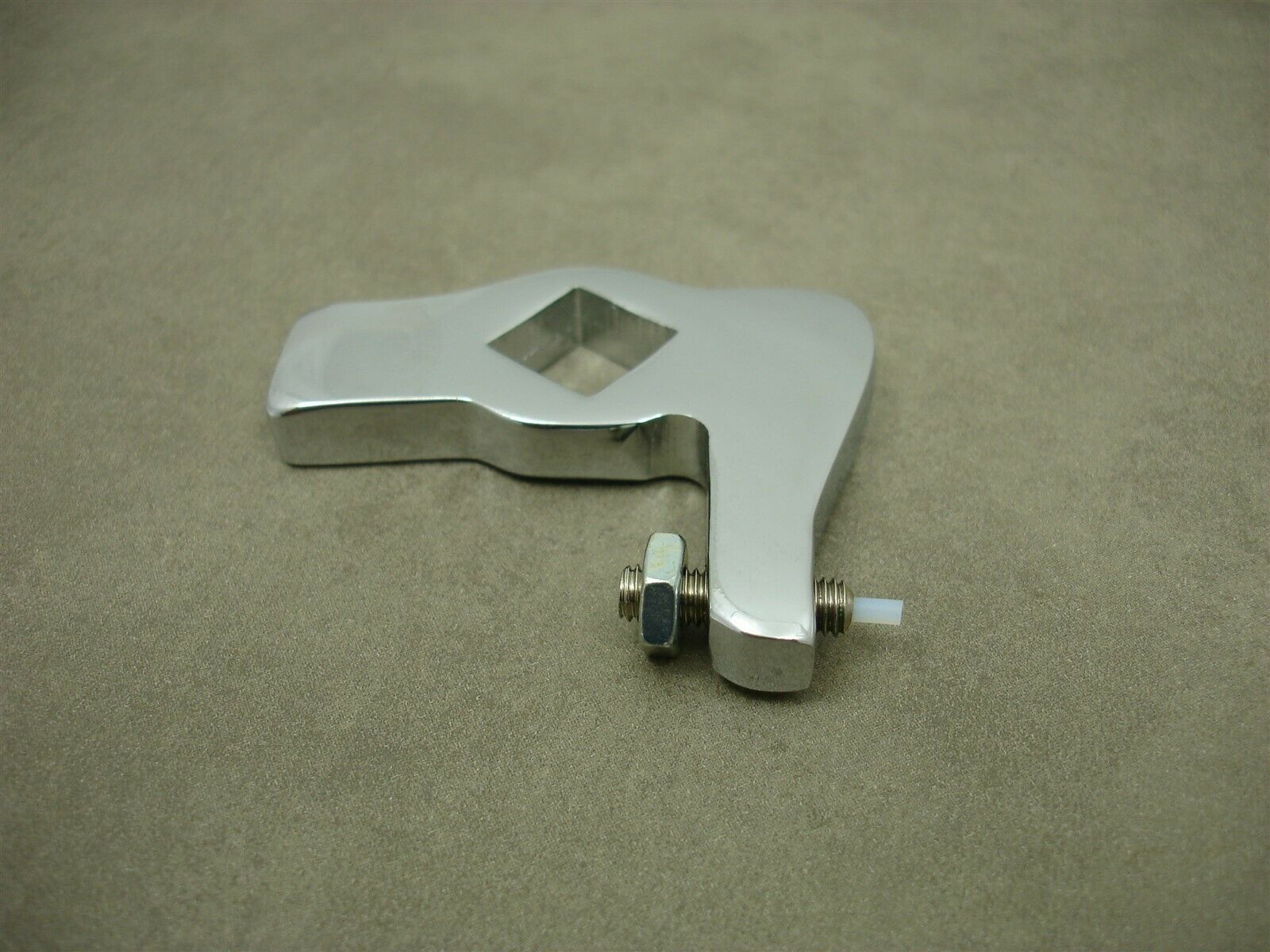

real easy, you need a side stand stop designed for this,...
made by various companys & hundreds on ebay, this is on my Shovel.
they range from $10-$25.

I have used them for the last 10 or so years without a problem other than i forgot to loctite the set screw & it backed out once, but a drop of loctite sorted it,
it cant shake to bits as its basically exactly the same as the stock lug with a small addition for the aduster screw,
so how did yours 'not last long' ?.. theres nothing to go wrong with them or break however big the motor is unless as I say, you didn't use loctite.
the short stands were originally developed for lower chops & specials that require moving the stand to the rear of the primary which can make the whole bike unstable at times,
the one you put the link to probably would work, but without the locking lug the bike could roll off the stand like a lot of non Harley type side stands can if on if parked uneven surfaces or on hills
