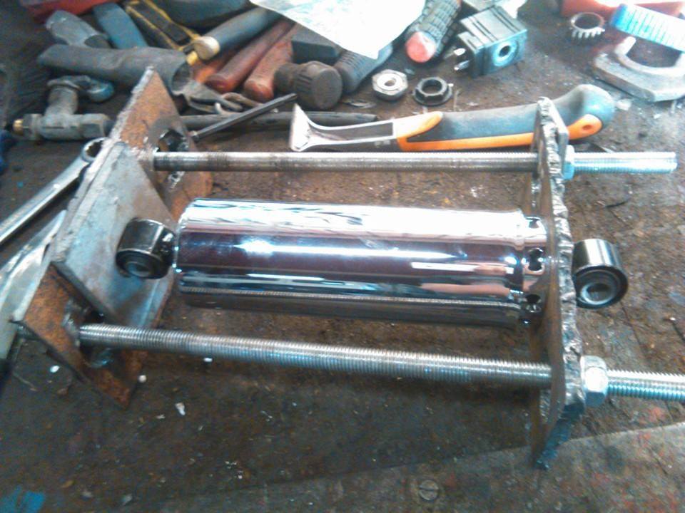

this is the shock whilst being compressed
Anyone able to help with through this?
Thanks in advance

So, to disassemble the shock, you aren't compressing it right - you have to push the chrome cover down away from the top eye. the ring will then slip out - the slot is for the shaft. Are you going to cut the spring to lower the bike? Cheap, but could cause problems with bottoming out.
