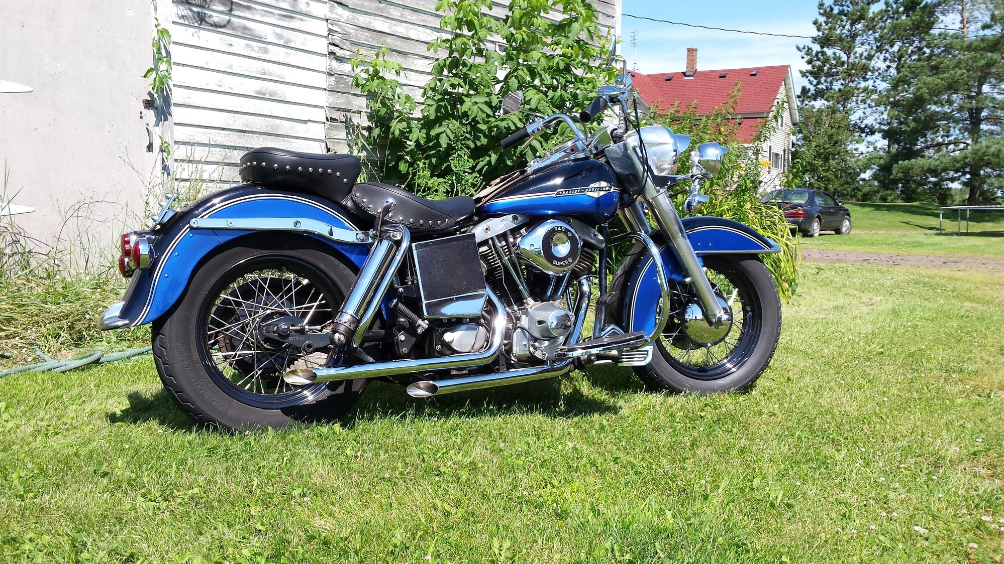

So apparently Jireh no longer carries Cycle Shack. And J&P got them in stock, but was still out of stock on the mounting bracket. So I ordered the pipes and floorboard bracket from J&P, and got the mounting bracket and exhaust gasket/stud kit from Dennis Kirk. Pipes arrived today, with the receipt for both the pipes and the floorboard bracket... but no sign of the bracket anywhere in the box. Apparently they shipped separately, but there was no "1 of 2" or anything on the box for the pipes. Already spoke with customer service, and they said to let them know if they don't show up by Saturday... even though I put the order in last Saturday... just does not make sense thatbi would not have received the bracket yet. When I went to track the order with good ol' USPS, it says it's in Cedar Rapids, IA... which is what it said two days ago... so anyway, hopefully it comes tomorrow so I can get them installed before the weekend. Thanks for everyone's responses. Will post pics of them in the bike as soon as I get em on.

They did, but they shipped separately and only gave me one tracking number. Anyway, I got them on, but having trouble getting them to seal. Gonna double up the gaskets and use high-temp silicone. Also, should I be concerned that rear pipe is frighteningly close to the oil line?
Don't double the gaskets they will just blow out faster and use Permatex Ultra gray not the red ****. Trouble sealing is directly related to not being mounted or aligned right on the rear bracket , it's not uncommon to either have to bend it a little to tuck or raise the pipe a bit or add a washer or 2 between the bracket and the pipe on the T bolt to get everything clean and straight and from what I'm seeing in the picture that front pipes is off a bunch .
Don't be afraid to get in there and tweak things none of the aftermarket stuff bolts up true and straight out of the box.
