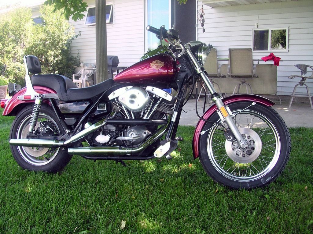

Since I doubt you will come up with the Stock crossover staggered duals that the Shovel FXR came with...Parts Breakdown Here
You will be Making Brackets...also do Not use the Rearmost mount donut that the MoCo provided to the early FXR's [#34]...your exhaust will break, and you bike will Vibrate. Even the MoCo quit using that miserable bracket...
Use the late model Brackets generally available one for the Transmission mount [#20] and one for the Cone [on the engine #32] ] and Don't forget to tie the Mufflers together [#33]..
I use the Lightest Mufflers available [prefer HD-65A] because the FXR exhaust mounting is Feeble at best!!!
Good Luck and BTW This is a Stock Exhaust Headpipes w/65A's from a late '80's FXSB, and the FXWG one works as well....
