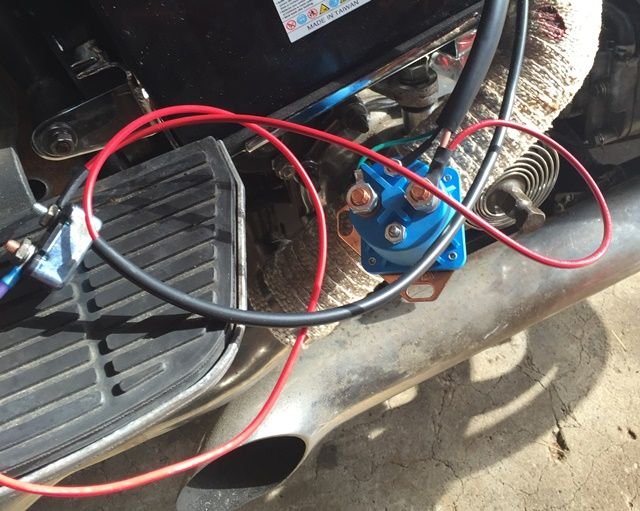

Old Nov 16, 2016 | 12:31 PM
Nick Sorgio's Avatar
Nick Sorgio
Joined: Oct 2016
Posts: 256
Likes: 36
From: Hartford, CT
New starter relay wired up:
I did a couple of quick checks. I have 12v at the post with red wire all the time. I don't have power on the black wire with key on and I push the starter button. I have to permanently ground the relay by installing it under the battery tray.

Old Nov 16, 2016 | 05:17 PM
Racepres's Avatar
Racepres
Posts: 8,613
Likes: 3,380
From: Cental, MI
That Ford relay is gonna ruin your OE starter button...it was not intended to fire that big bastard...Takes too much amperage!!!!
