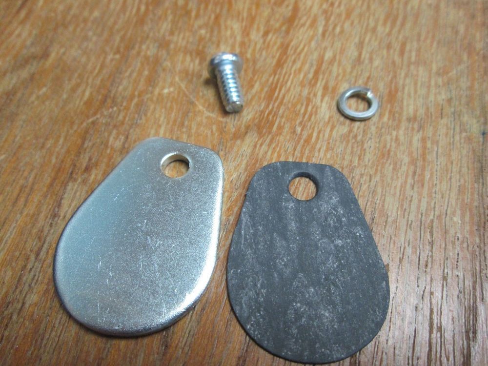

73 up FXE's didn't use a trans driven speedo...they used a block off plate...part number 35606-73

Thanx Tom, I just thought it was weird that it looks as if someone welded it up and ground it down.. also not looking to utilize a trans drivin Speedo.. gonna try a later model FXR drive...
