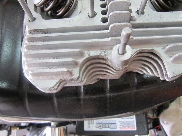

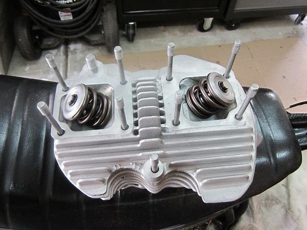

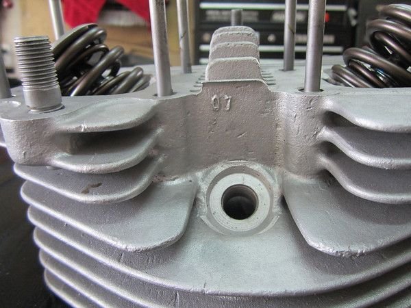

Originally Posted by SparkyD
No I have not. How would i determine if the heads are stock?
There are casting codes on HD heads. Pics are from a stock 1975 FXE.

From: Washington State
My heads seem to have all the casting codes that say they are stock. Learning a lot from all of you. Thanks to all
