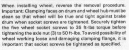

Factory lug wrench gets them plenty tight.. and Racepres is spot on suggesting blue locktite.
Notice oversize lugs are available? The threaded part? Thats because of folks going to tight..stripping them.

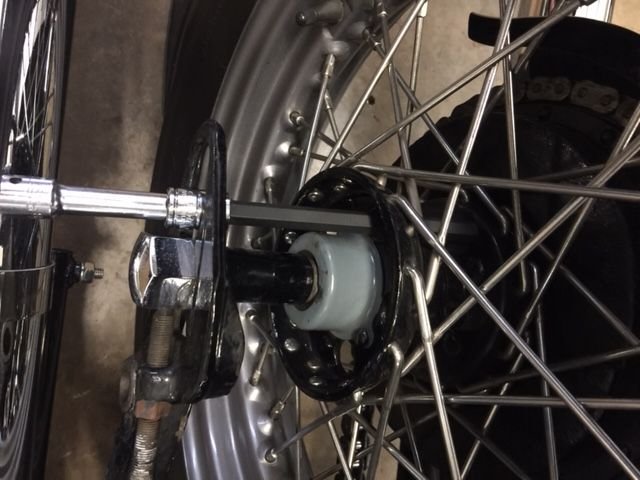

In Your pics, looks like just maybe a PO drilled out the access holes in order to use a socket..could be the pic angle or my old eyes.

I guess many on here don't follow the service manual or have blurry vision and can't read this LOL
Not sure if I need a T-bar Lug Wrench since a long allen socket and short extension reaches to allen bolt and can be used with a Ratchet and Torgue Wrench....IS THE ALLEN SCREW 7/16"? Just my luck, the largest long allen socket I have is 10mm and 7/16 is 11mm....and can't find one so I ordered the Wheel Lug Wrench for Harley 1936-72.
And yes, I have a lift and a jack. And yes, always use either blue Loctite or anti-seize depending on the application. An yes, will study the brake system when the wheel is off. I also have a C clamp and will use that to lock down the brake. Thanks
One more question....is front brake squeak normal? I realize the front is a mechanical drum vs the rear hydraulic drum. It squeaks when I first roll her out of the garage and down my driveway. After I start riding pretty much goes away even when slowing down except when apply full pressure to stop,
There it is, that's how you do it. Similar sockets in 7/16" also available on the Bay. I have one, bent it good using an impact gun, then got a new one. So I do follow the FSM and torque to spec, but I use a drop of red loctite. I had the absolute pleasure of losing lug bolts on the rear wheel of my Flathead, bad, bad things happen. Do not want a repeat. I have never had an issue getting them back off. No slathering of the Loctite, just a drop of RED.
You can use the ground to hold the wheel, but you need to keep turning the wheel as there is only one spot (as you found) that allows access. On the lift, clamp the brake pedal, rotate and repeat. Have a helper? Have them hold the pedal down. In a pinch, I can stand next to the bike, put my right foot on the brake pedal and do what I gotta do. I was putting the front wheel back on last month, wife was home and in a good mood, I asked her to help me for 5 minutes. I had her holding the front brake, tighten the bolt, let go of brake, rotate, repeat. Well in quick order we are done ans she says "that is a PITA, how do you do that by yourself?" I showed her the wood clamp and explained how I have do get up take clamp off, rotate wheel, get up put the clamp on, tighten bolt, get up take clamp off................. Her observation was that was not cool, I replied that she can come help whenever she wants. Good luck.

For me, I don't torque everything but I do make it a habit to torque all critical fasteners for safety. I surely don't want to find out the hard way like you did.
If you find one, please post the link as I can not find one anywhere. Largest long allen socket I found was 3/8" and 10mm. I have a 7/16" standard allen socket but would need to put it on inside the wheel, lower bike, torque, remove, lift bike, turn wheel, put it on, lower bike, torque, remove, lift bike, turn wheel.....now that is a PITA but only 5 times so maybe not so bad lol.
