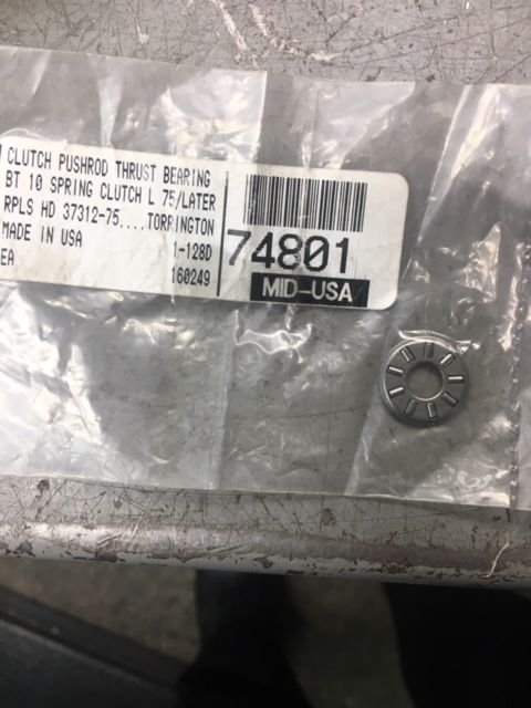

USA bearing alone

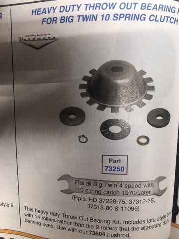

as a kit it says USA
Never tried to get an Old style throwout to work in an FXR...I have my Doubts, because the pushrod is Different!!!
Also.. I have had poor luck with the "new" bell type throwout... Finding the bearing in it inferior to the O.E. wafer bearing [newer style]...
