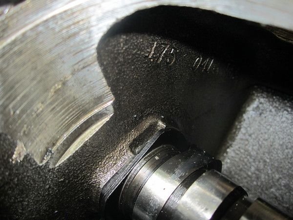

Starting in 1975 Harley Davidson changed their numbering procedure on the lower crancase (belly) numbers. The new procedure utilizes the Julian date. (The Julian date uses all 365 days of the year, 366 in Leap Year).
For example, a 1975 FL model which was produced on January 1, 1975 would appear as follows: 1 75 - 001 001
1 = Model
75 = Year
001 = Julian date
001= production number
You can see it on the left case
however, you will need to pull your tappet front block in order to see the numbers on the right case

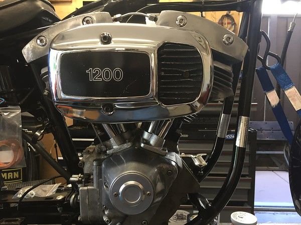

I know of none. Wasn't just electronic ignition system. Another change was from the oval air cleaner with the Pig Snout backing plate to the Ham Can air cleaner in order to compley with the CARB standards.
1977 to E-78 Pig Snout backing plate (also used on Sportster models for same time frame)...
Mid 1978 change to the Ham Can cleaner...
And to the OP, sorry, I do not mean to jack your post.
If you get the chance, how about a pic (or two) of your bike?
