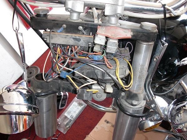

I'm looking for some pictures of the fork terminal block. My 76 FLH needs to be rewired. I was replacing the handlebars which had the handlebar wiring fed through them. I found a mess of wiring inside the headlamp housing. The previous owner's wiring eliminated the junction block. I'd like to see how it looks when mounted. Thanks!

Its part #72312-73. I know V-twin has it (used one to re-wire a buddy's 75 FLH). Their part number is #32-9246. You see them for sale on the Flea as well, but as with all used electrical stuff, you can't be sure alll the terminal points are still functional.
And if my memory serves me correctly, they use #9904 wire terminal, female spade type connector, 1/8 slot - #16-20 wire. Found at a Frys Electronic store

Thanks for the picture. I've ordered the block and bracket. Just needed to see where to mount it.And thanks for the connector info.
