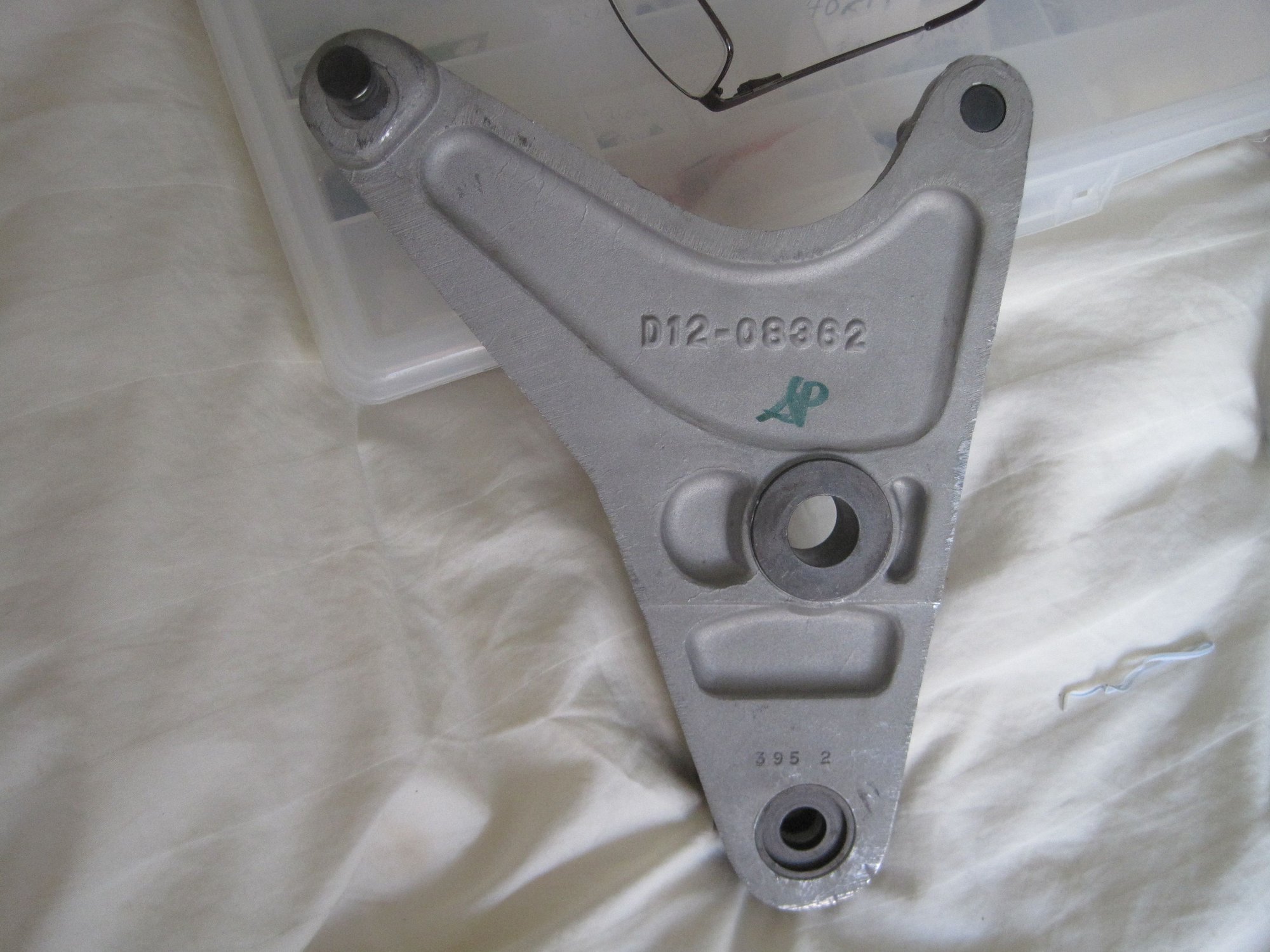

Hi, I just joined today and was reading your discussion about the banana brakes, I just dragged an '81 NOS caliper and mount out of my stash today and noticed it's a real tight fit, I think it's due to the addition of the anti-rattle clip and that high tech plastic seal, feels really solid

the seal was pretty hi-tech for HD in 1981 it seems
