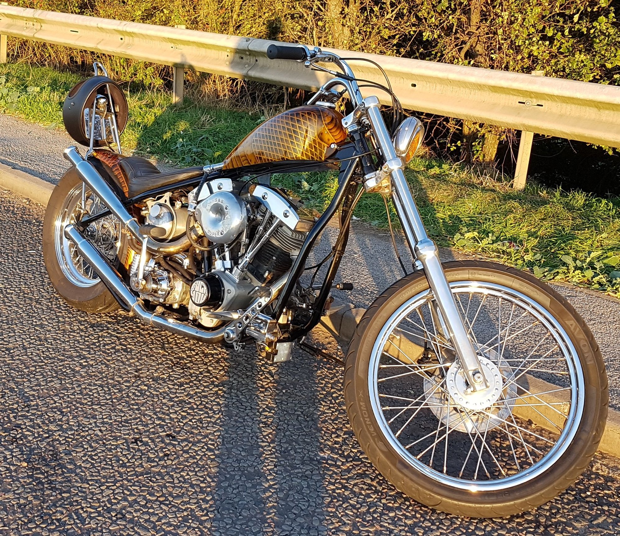

HI guys. Steve from England. have recently purchased a 1977 flh shovelhead, with s&s 93ci sh motor. I'll try and add a picture.
Im looking for some advice please. Whilst riding home from purchase she broke down. Over heated , back fired and smoked pretty badly. When i pulled over, she wouldnt turn off. I found an ignition lead had worked loose. Was taken home by recovery vehicle.
On further inspection i found also that the accelorator pump jet was blocked. Having sorting both, she is now smoking badly. I have done a leakdown test. its at 70% loss on both cyclinders, adding oil to cyclinders makes no differance. i can hear air from both exhaust and carb. Would adjusting pushrods adjust the valves to cure this ?

Cure it???? Probably not
Worth doing tho...then see what ya gots.
Odd looking FLH, but... Guessing this may be yer first Shovelhead??

Nice looking custojm you have there. As Racepress suugested probably won't cure it but definitely worth the effort.
Suprising somehthing that clean llooking would turn out to be such a quick problem though. Considered asking the prior owner for some input?
And just a question. Is there a carb support bracket hold the carb in place? If not, and with that rigid frame you will never get a complete and proper seal on the intake manifold between the heads and the carb.

I don't see any support worthwhile... best get at minimum the S&S case bolt one...
Better get rid of that Cheezy inline fuel filter as well, or you won't be Happy with your tuning efforts..
Do Not put any oil into it... especially if it is smoking...I suspect someone checked the oil after sittig and now the poor old girl is Desperately trying to clear her throat... May even need to let some out!!!!!
