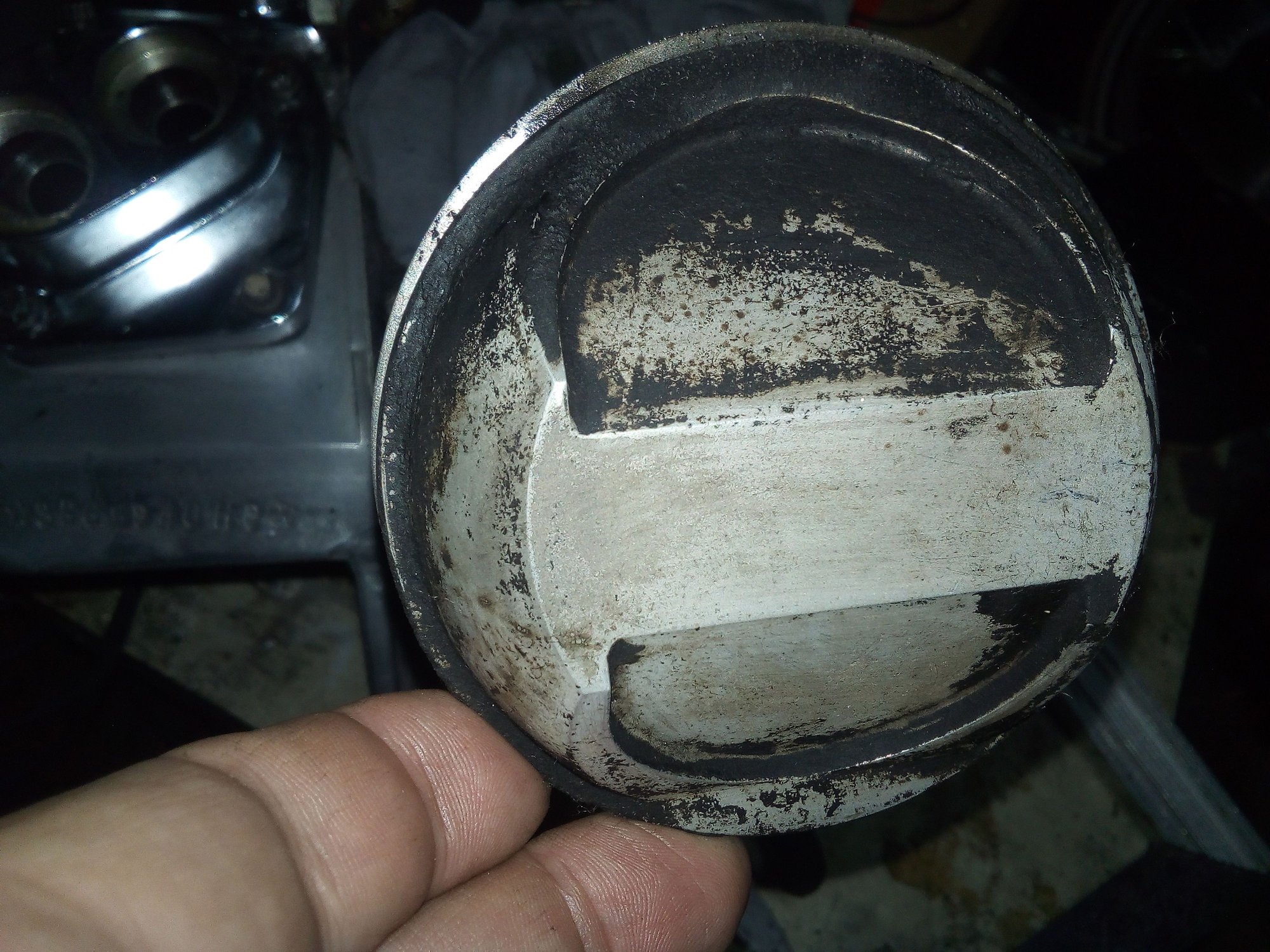

hello, I´m working in the top of my 1979 flh, the bike was imported from USA two years ago, and I think along his life will be repaired and modified many times, I try to identify this pistons, don´t appears marks of any type in this,and I want to fit the correct type in it
It´s a weird to locate parts for it, I think it,s the early 79 type
any sugestion will be apreciated

my first thought was ross but they could be wiseco pistons - it looks to be a forged blank and at lest 9 1/2 to 1 or a little bit more 9 3/4 maybe
we use the Midusa brand of pistons in the shop 8 1/2 to 1 and they are cast set at .003 piston to wall - have 100s of sets out and about with no issues - forged need at least .004 or 005 and tend to rattle cold - its all about if you can buy on the road good fuel

I'm thinking Wiseco or early Keith Black.

what type of rings i need to fit?, currently I can only find hasting brand in my usual dealer

they could be priority to the piston reason I would suggest you do not re use them
/you need to measure them and post the results - standard is 1/16 - 1/16 - 3 /16 oil but yours might be metric

the measures ( in inches) 0.062/ 0.062/ oil 0.15
piston3.505 taked in the lower edge /skirt
cilinder 3.506
the oil ring is not standar

wiseco, the rings measure match.
