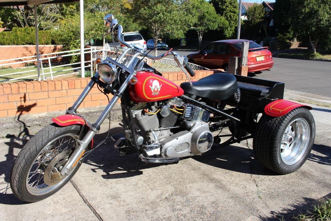

Likes: 435
From: australia
my trike seat was repadded so there was no dip in the middle. raised the rear with longer springs and moved it 2 and half inches forward.this was before pic now its a pleasure to ride
