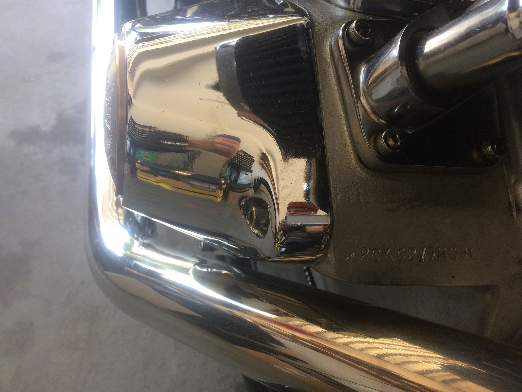

I found a service bulletin dated 1981 that shows the VIN character Identification, each character has a certain style to it not just block numbers and letters. I guess harder to alter numbers. The numbers and letters on the 1973 FX I want to buy have these characters on the case number. Am I imagining that things don't look right?
Let me know which characters you think look suspect. My vision is getting blurry from studying this for so long.
Also should the cases at the rear cylinder be more in line, could this indicate that the right case with the number on it was swapped out.
I do not have the belly numbers and I wish I did more homework before I drove 3 hrs to see the bike. I don't want my enthusiasm to cloud my judgement before I lay down 8 large.

Shovel character styles changed a couple times during production and I can't remember the years they did, sorry. Sequence in the picture looks right and the stars have the correct slightly off stamp depth to one side, that one is the usual giveaway on funky numbers jobs, they usually hammer them to deep & even.
Case miss matching on the rear is common on the older castings.

Engine VIN looks fine.

I agree things don't look right. As I mentioned in the other thread, the engine number picture is very interesting and there appear to be some unusual things about it. Also as you noted in the other thread the casting around the case number is smooth.
I've seen a few other 1970s engine numbers like that 73 but some characters don't look the same as Posident types. For example the 5 is different to what I'd expect. Also compare the end of the curve on the 2. And notice the 6 and 9 were done with the same stamp as each other. Why wasn't the 9 done with a different stamp to the 6?
I have a copy of that Service Bulletin and judging by photo examples of 1970–80 VINs I’ve collected thus far, it seems that sometimes the 6 and 9 were indeed used as per the Posident line-up initially suggested, meaning the 6 was rounded and the 9 was not. But sometimes you’ll find the opposite. (See photo below.)
Sometimes the way the 6 and 9 were used on an engine is opposite to how they were used on the accompanying (matching) frame. But sometimes it isn’t. The early-70s seem to have the most differences and then maybe around mid-74 or maybe 1975 the factory seems to move toward a standard approach, almost. I say almost because there also seem to be some exceptions and I continue to investigate them.
Anyway, that 73 engine number doesn't look authentic to me and I posted two examples for comparison. Also notice in one of my photos that although the 9 and 6 have been done with characters different to each other, they are opposite to what the Posident line-up indicated. But I've seen plenty of this for the early-70s so I don't think it's a concern.

Cases being out of line at the back is okay, depending. But in your photo I can’t tell if any characters are stamped on top of the cases. Notice a certain style of Hs in my picture below.
