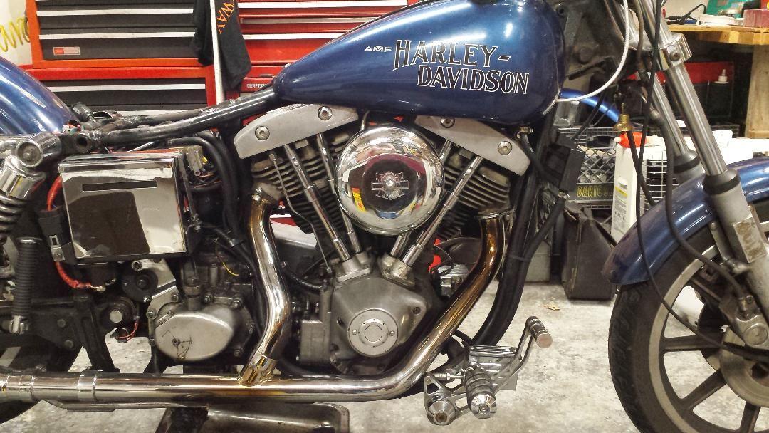

This is the Pauhgco I went with for my '79 FXEF. Helped give me some lower end torque with no other major changes other than adjusting the jetting as witnessed by the discoloration.

I always liked that Dresser 2 into one... with no left side crossover, yet kicker clearance... but not on an FX for me...
The Crossover staggered duals [stock] headpipe, with free flowing glasspacked mufflers is the ****...
and if there is Not a K&N filter in that little bitty air box.... yer leaving alot on the Table!!!!
1200??? or 80 CUin??
