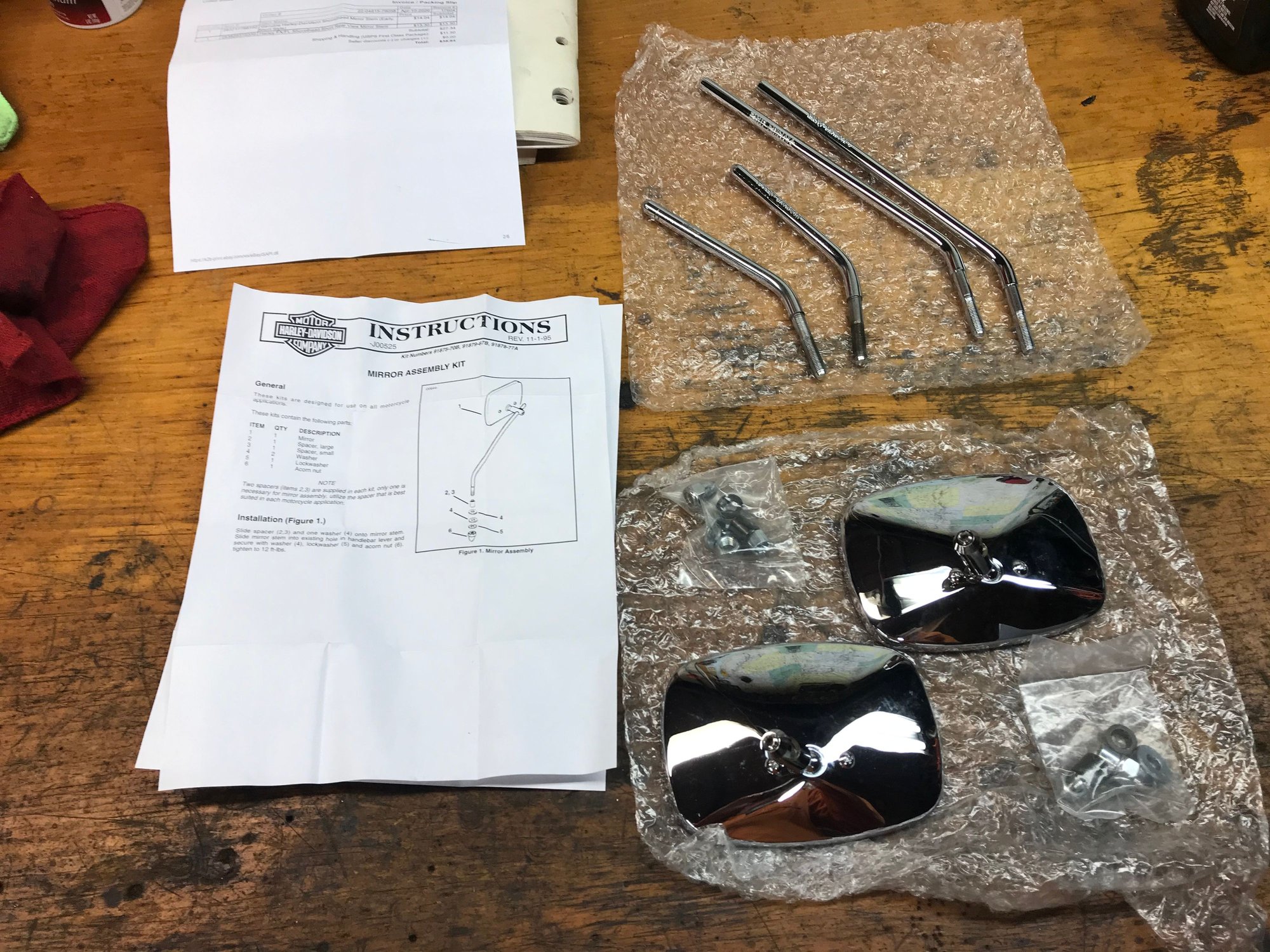

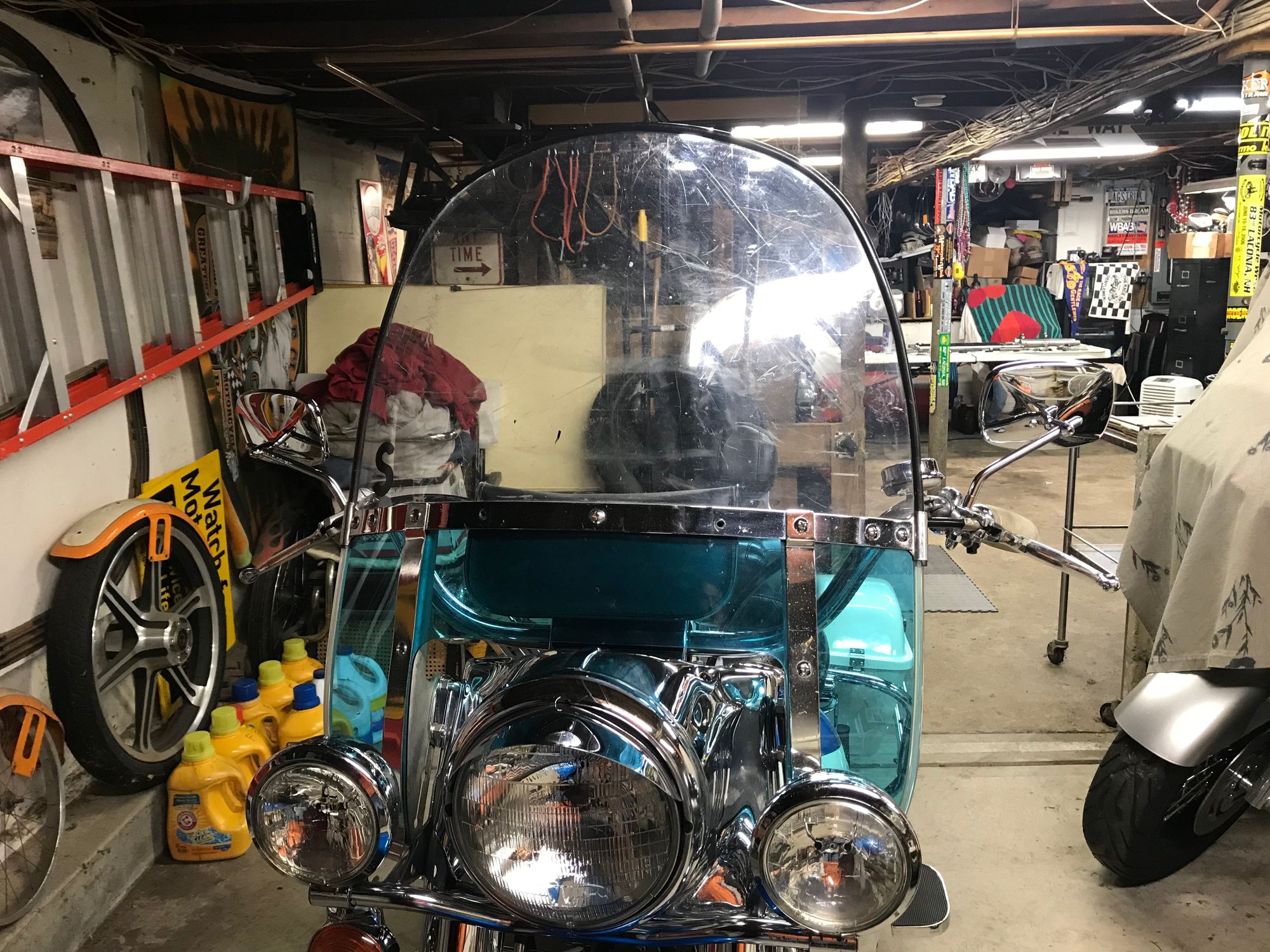

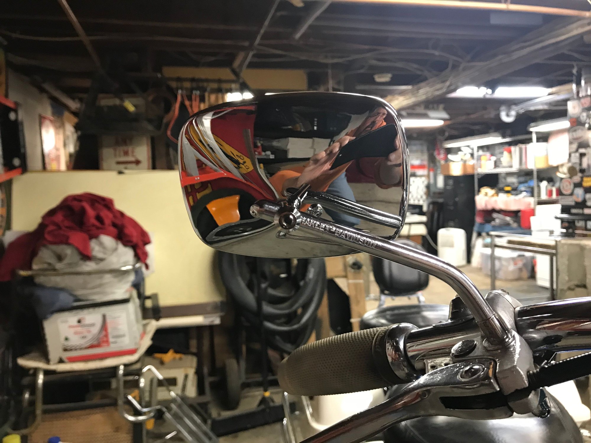

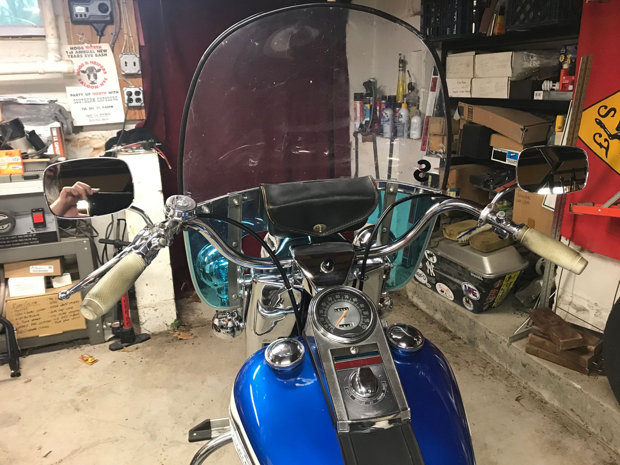

For anyone that cares, found a set of NOS mirrors on the Bay, still in the box. Unfortunately they were long stem, so I also had to score some correct short stems. Long stems only look good with the bat wing fairing, my opinion. Some pictures, I didn't realize how nasty the old mirrors were until I put brand new ones next to them. Success, now to find the next thing, thanks to all that helped with part #'s and such:
