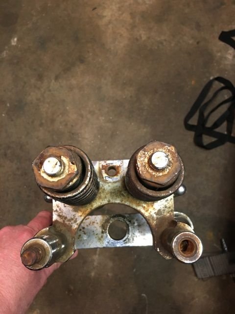

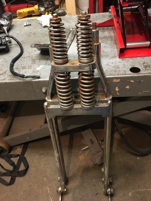

Working on my 81 FXS. This weekend I picked up a bunch of parts including this springer front end. I've never run one before so I'm completely new, but always loved the look. From the research I've done, its a Jammer - so not an HD or Paughco, but apparently not as bad as some of the other Chinese junk. At any rate, how would I use it in my application? Do I thread risers on to the posts?

I am not familiar with that make, but looks like you are missing the fork stem and the top clamp. The top clamp would have the attachment point for handle bars. All I got, Jammer still exists, give their website a look at what a current one looks like. The Bay is your friend.

JAMMER springer would wear out the spring studs how do I know I got hit in the head by one on the Verrazano bridge 1970
they rub and wear around the center - look close

they pogo like all with out the shock - if you want you could get use to it but I would plan on a shock
