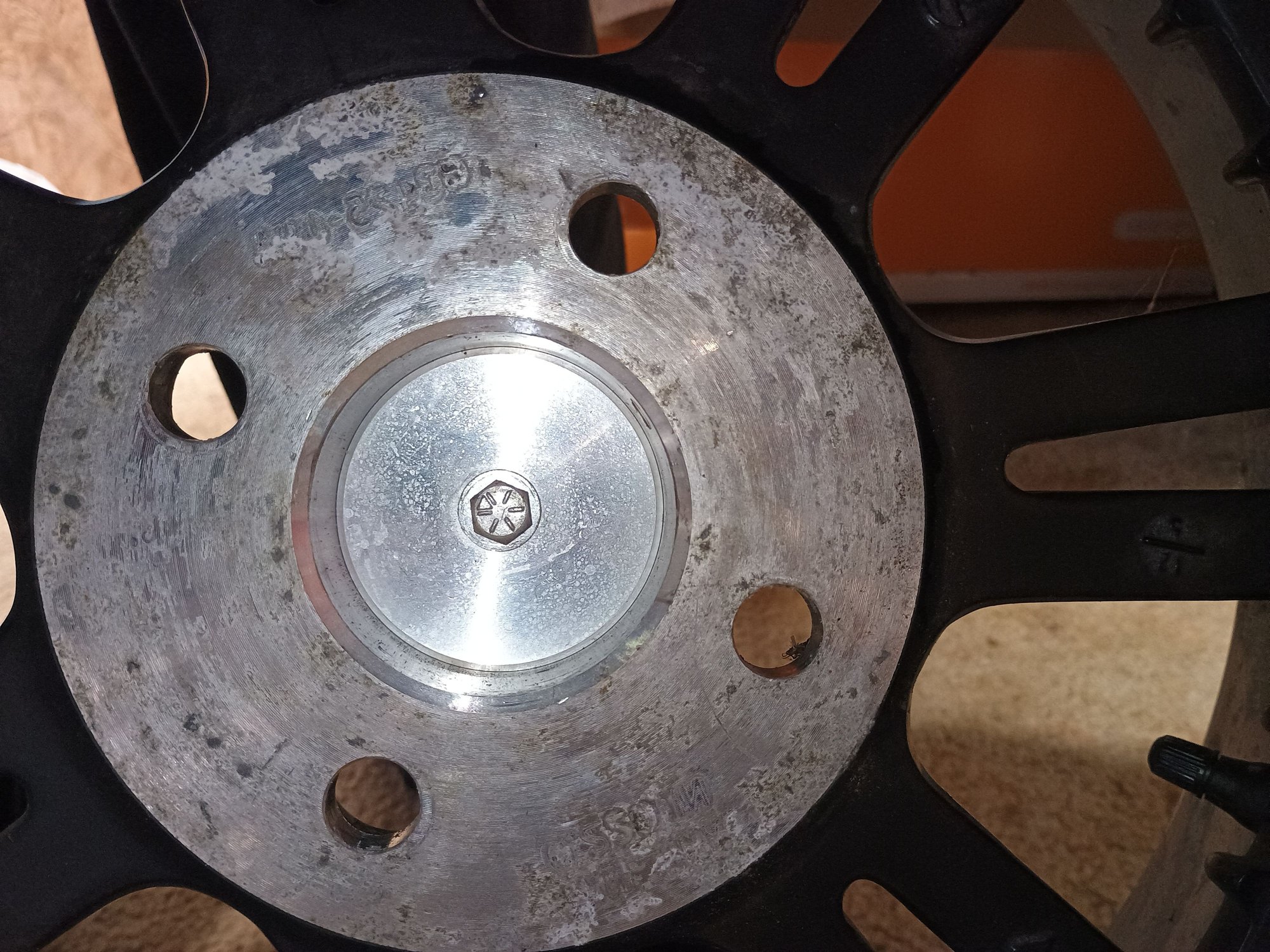

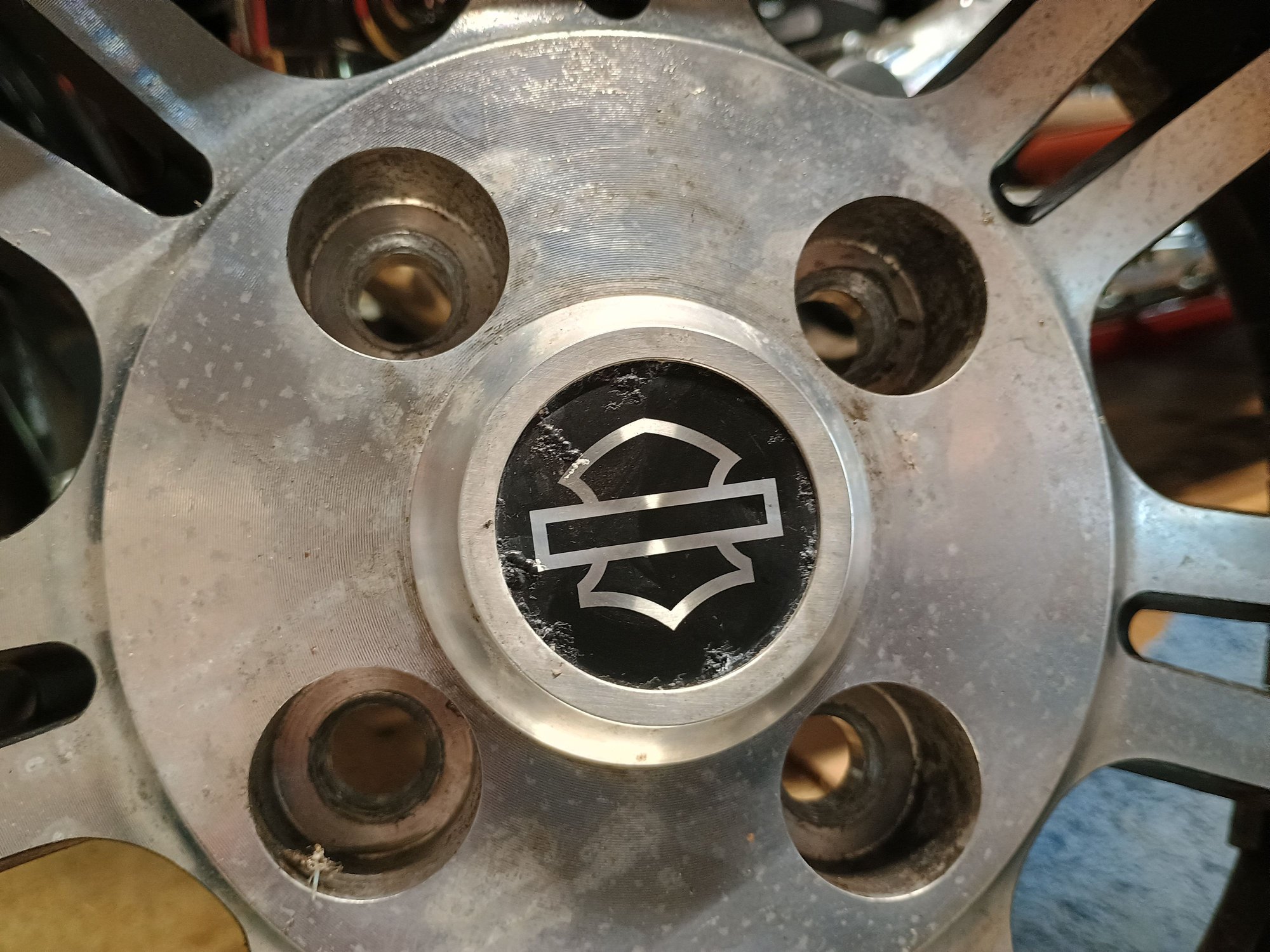

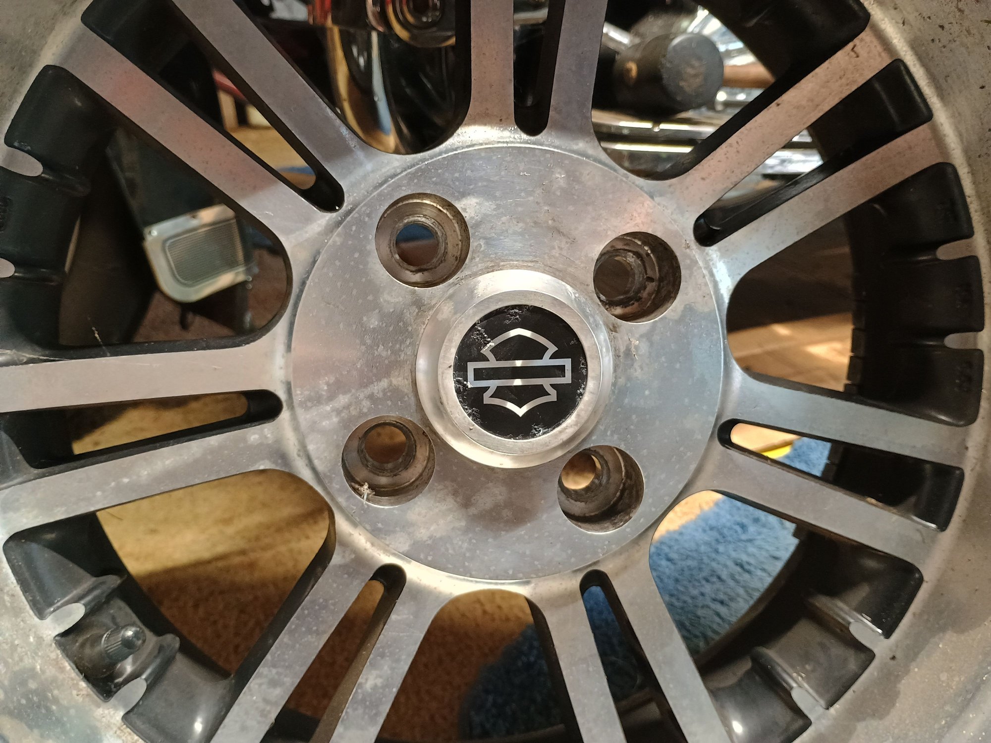

Any body got any ideas about getting the center hub off the rear wheels. Mine has a 1/2 bolt going through and the cover would be the nut. There is not slot or anything to be able to keep this from spinning. I was thinking about picking a spot on the outside image and drilling a 1/6 " hole all the way through and leave the drill bit in while I loosen the bolt.
All ideas are welcome. The wheels are off but the tires will not be here until Tuesday or Wed., so I've got until then.

Probably corroded in there from the looks of your wheel. You may be able to push on the outside and use an impact wrench on the inside. Or see if you can fit a C-Clamp between the spokes and compress the outside putting a cloth or something that will not mar the outside.
Or just drill out the center and replace with new, they are $37.00 each.

??? IS that a trike wheel ??
