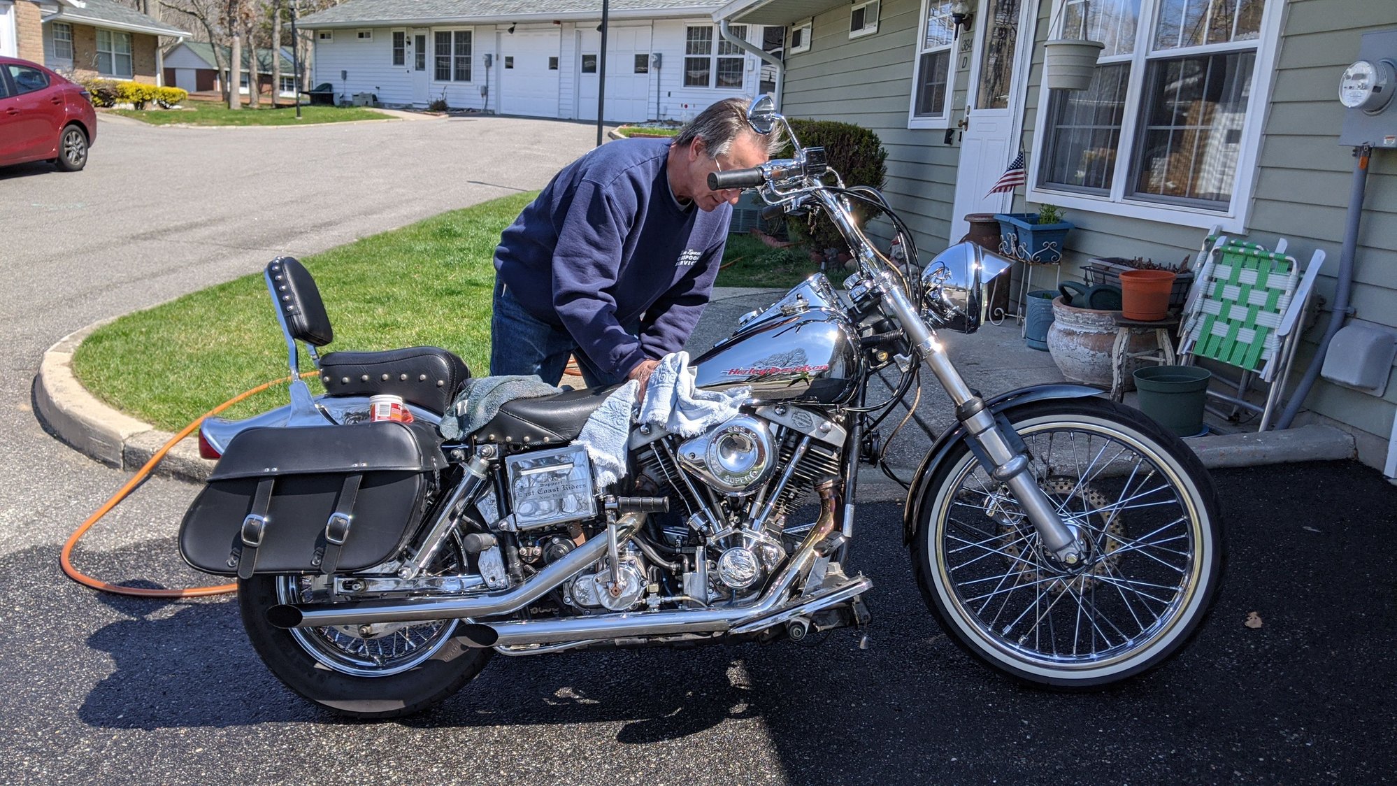

As Twizted quoted John They are a different breed and if you do not have hands on experience with them or even hung with Shovel owners it will test your knowledge and cost of repairs.. I found out the hard way when I bought my first shovel. I should have walked but I wanted one so bad that now I have closed to 10G's into it just to get it road worthy.... Yeah I got ripped off like John said and the guy who sold it to me knows it but didn't care...
Rings, Valve job, 3rd gear, shift forks, Main and countershaft, Starter and starter housing. Clutch basket and more inportantly a new ignition. And lets not forget about the common trans bushing leak that can leave a grapefruit size puddle under the bike.. I won't leave out the fork rebuild either..
Though I was getting a JEM.. More like COAL....
Actually I'd like to add a little more info. Make sure you understand how to decipher VIN's and that the bike matches the vin... I didn't and thought I was purchasing a 77 FXE but it turns out it was just an FX that was made into an FXE so it was sort of rubed up... Research and know exactly what you want...
