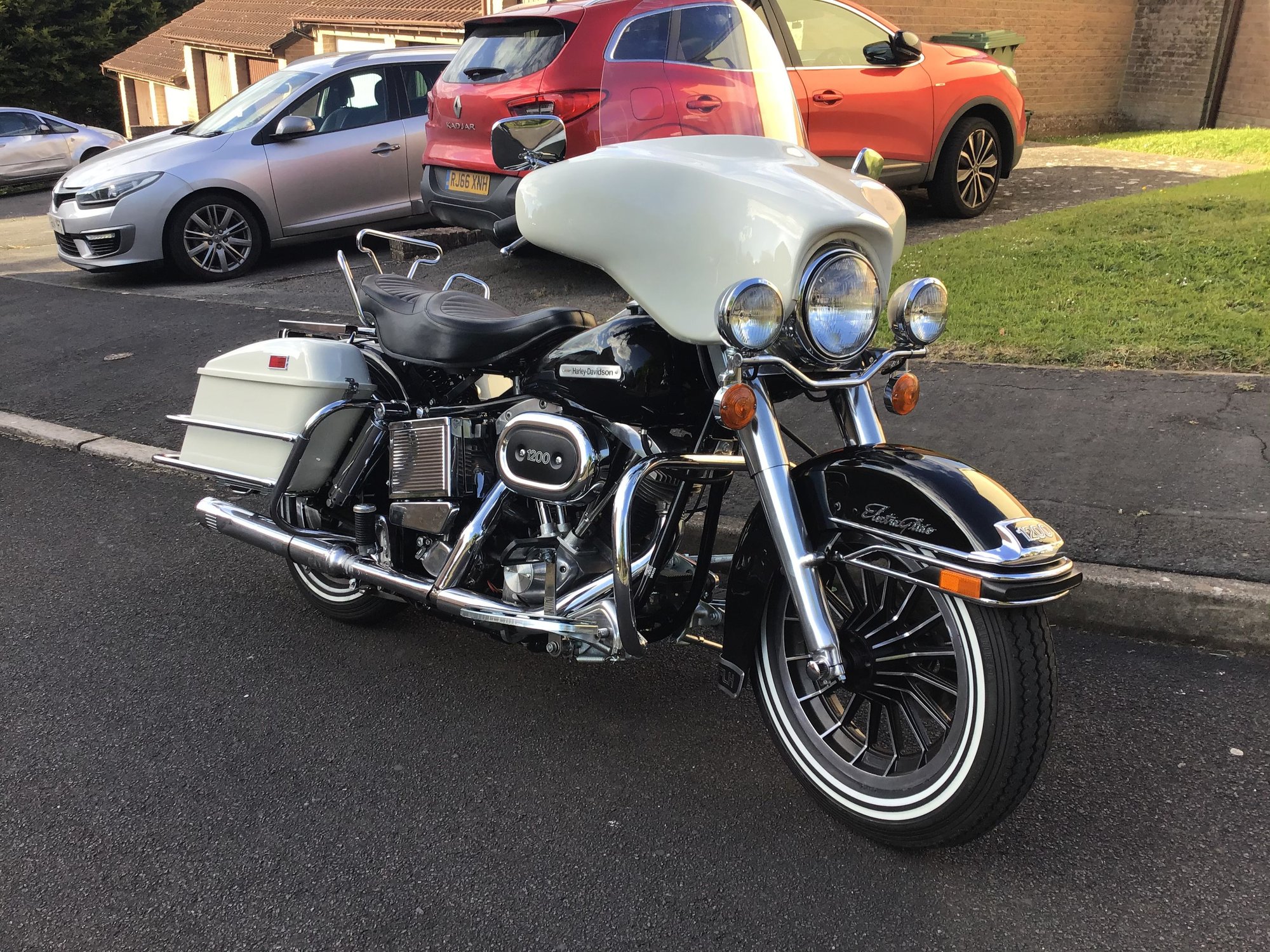

Metzeler ME888 Marathon Ultra Wide White Walls
Mounted these 2 years ago.
1979 Electra Glide FLH King of the Highway.
Bike ride perfect. Lean angles crazy for a 1000 lb.bike !
Scraping boards!

Lol- not sure what that says about my riding architect, I’m getting on fine with the 240s. Happy at 70+ but haven’t had them in the wet yet-that might be interesting 🤔
they do look the part though
