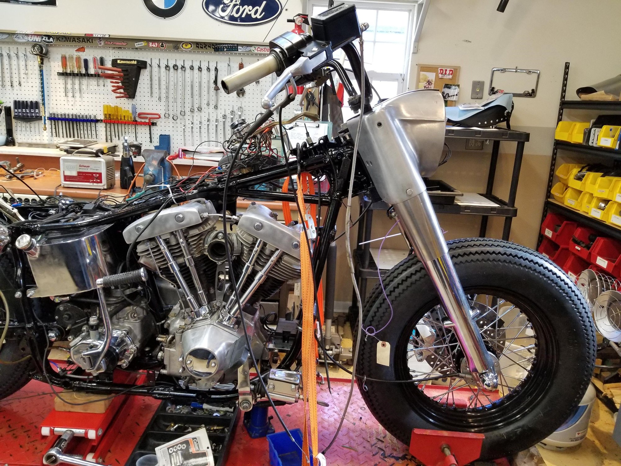

I got the brakes hooked up but not bled and the wiring is almost done. The starter clicks but won't turn over so I need to sort that out. I finally get to see her with the headlight nacelle in place.

Test Battery with a Digital Volt Ohm Meter..
12.6+ volts is good... 12.3v is 1/2 of a charge, and 12.0 is Dead...
First things first!!!!

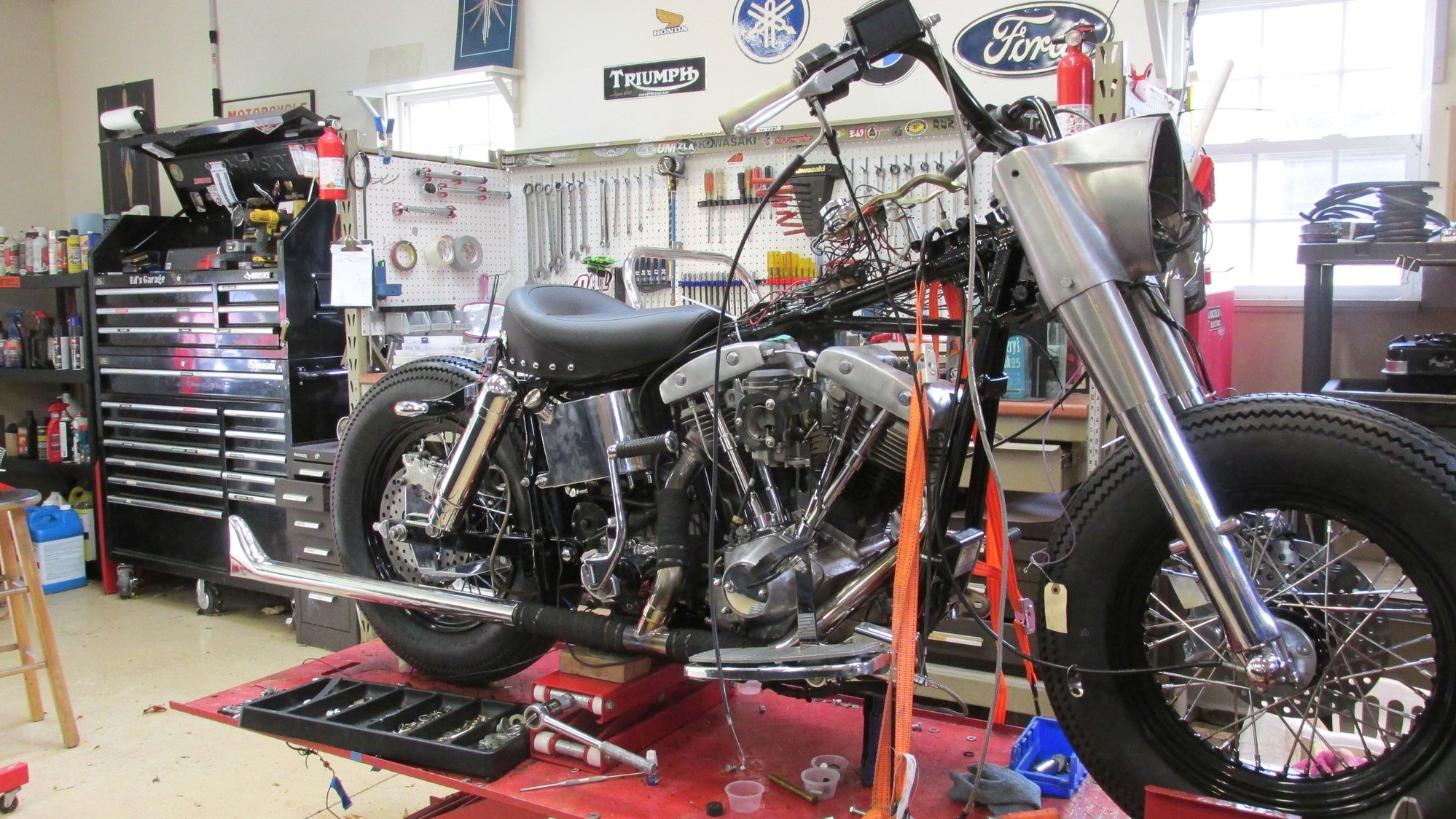

volts is 12.59; maybe borderline. Got the shift linkage, right floorboard, and carb fitted. Trying to decide if I want to shorten the fishtail pipe. I wish the painter would call to tell me he's done.

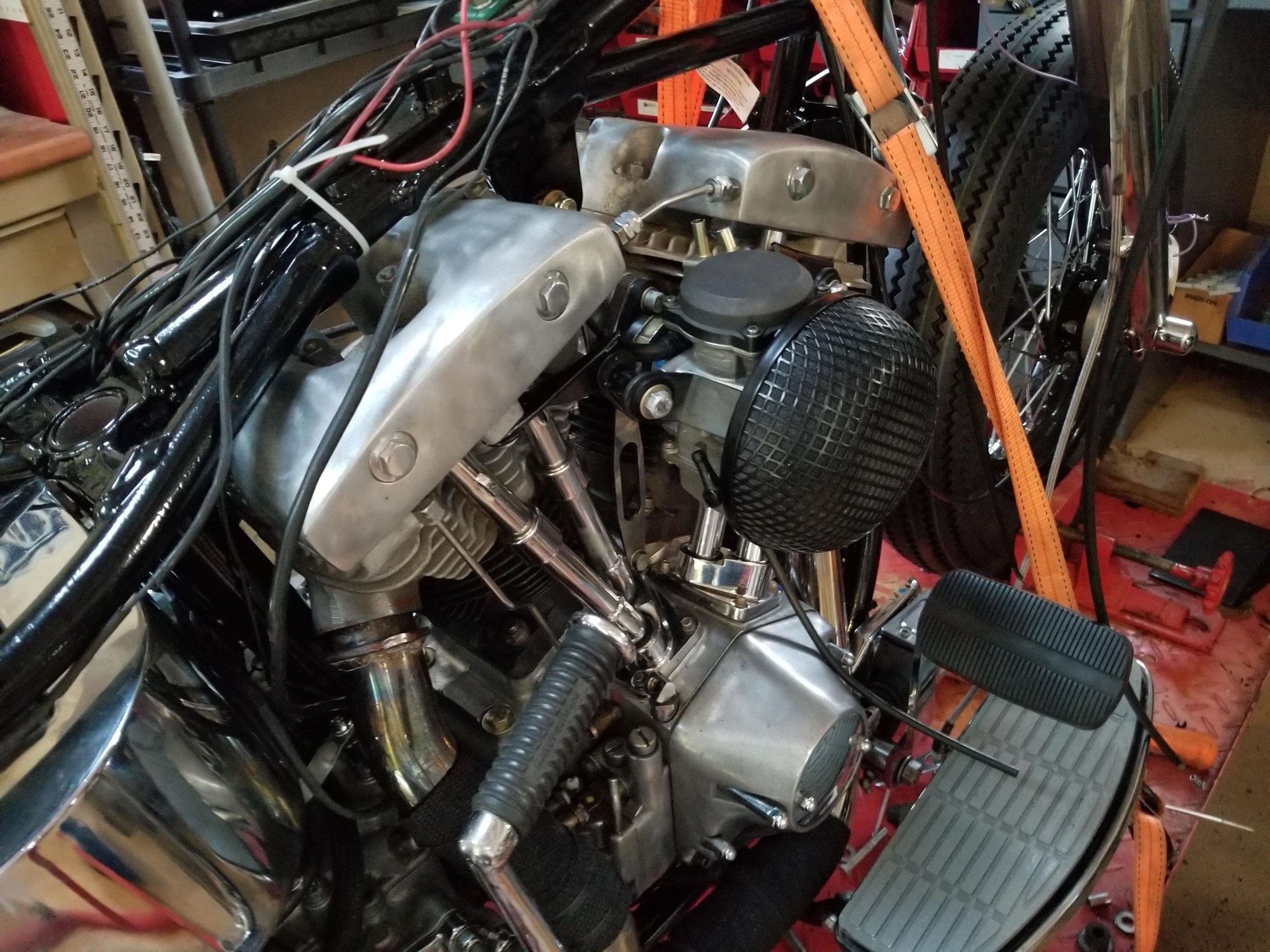

The wiring continues and I made some brackets to fasten the CV carb to the tapped holes in the heads. The air cleaner is from Lowbrow. I l like it because it's smaller and you can see more of the motor.
Called a "Bird Catcher"
Not an Air "cleaner"
