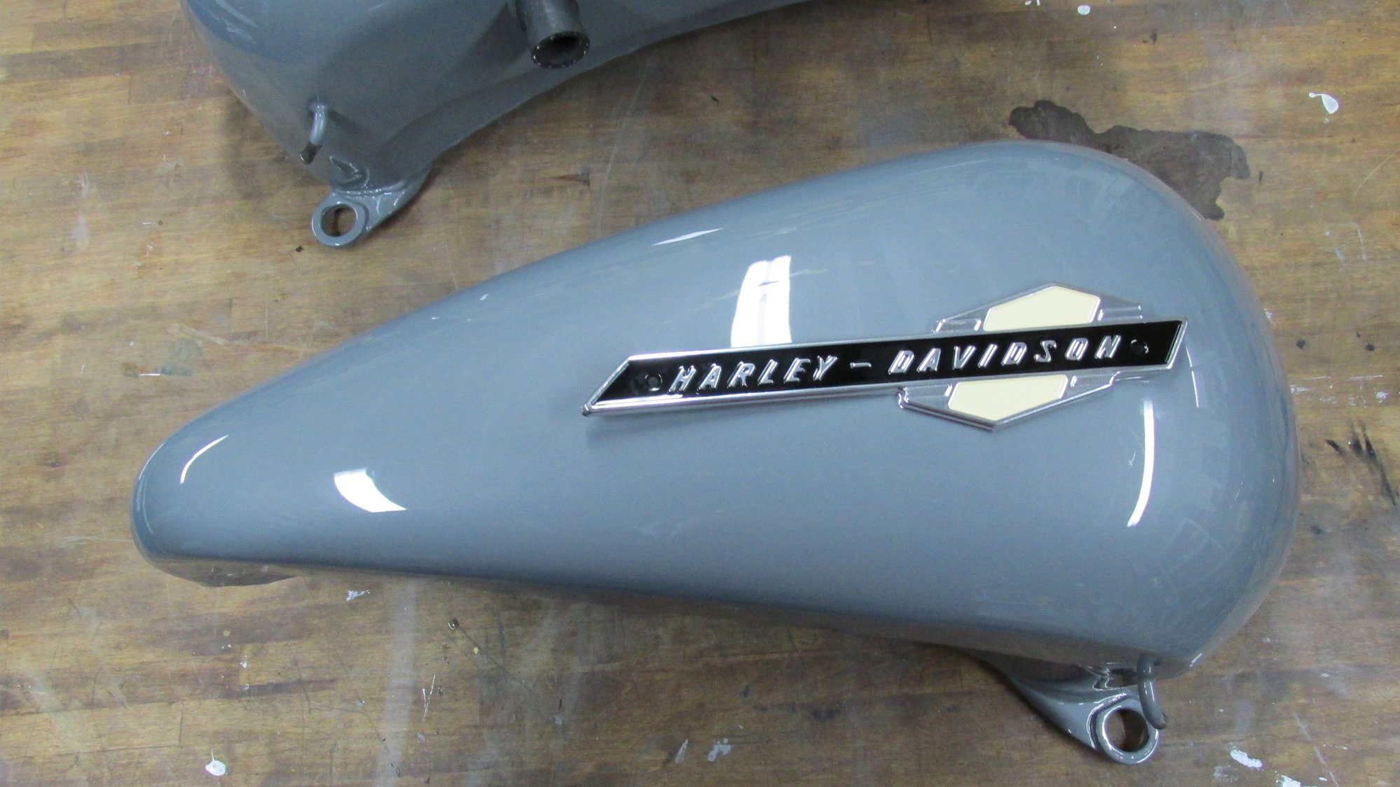

Got my paint back today. The emblems are not correct for the year but I like how they look

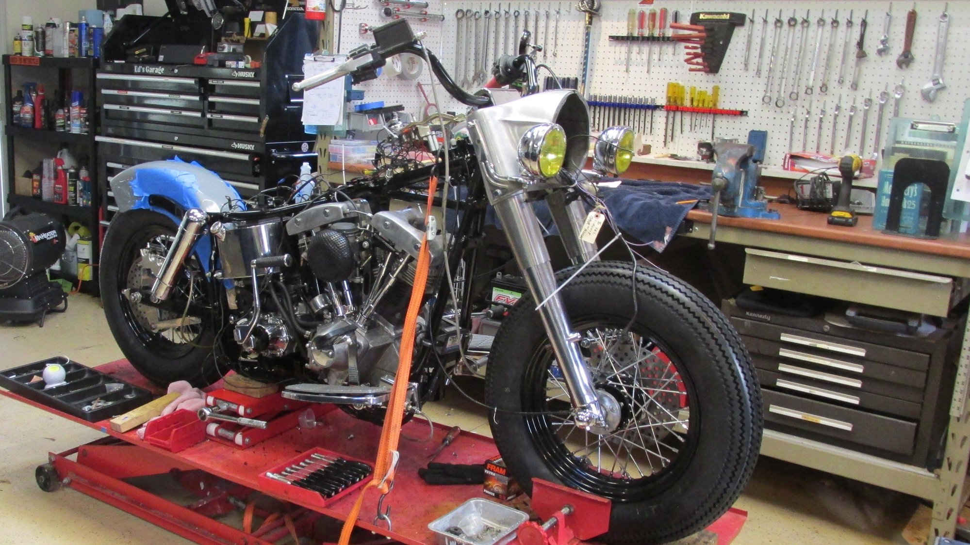

The wiring took longer than it should have, but I was pretty happy when I saw that I had spark and everything else seems to work like it should. I am test fitting the fender and maybe tomorrow the fuel tanks. The yellow passing lamps function as turn signals.

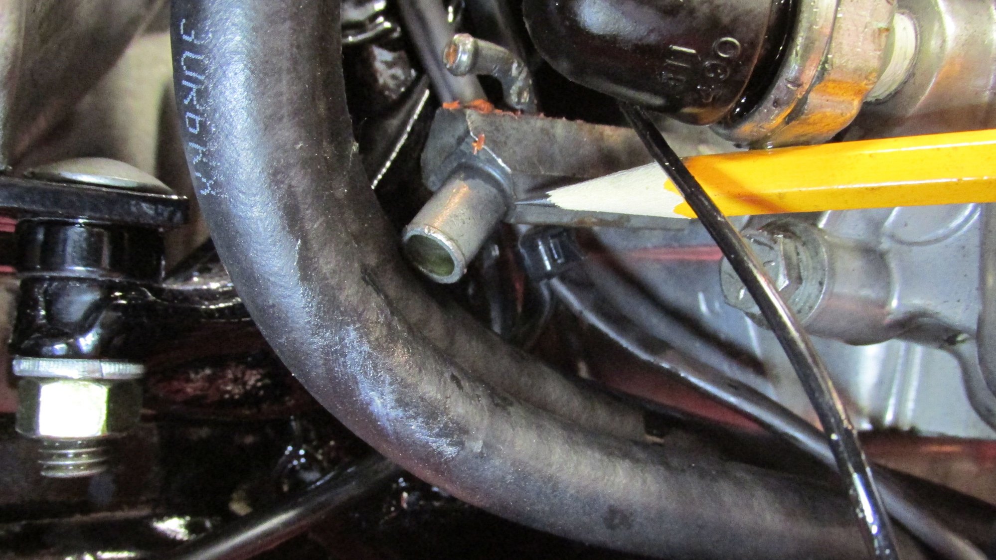

Originally Posted by edz1200
In the picture below, do I just cap this pipe off if I have a primary belt?
That can be capped off or plugged.

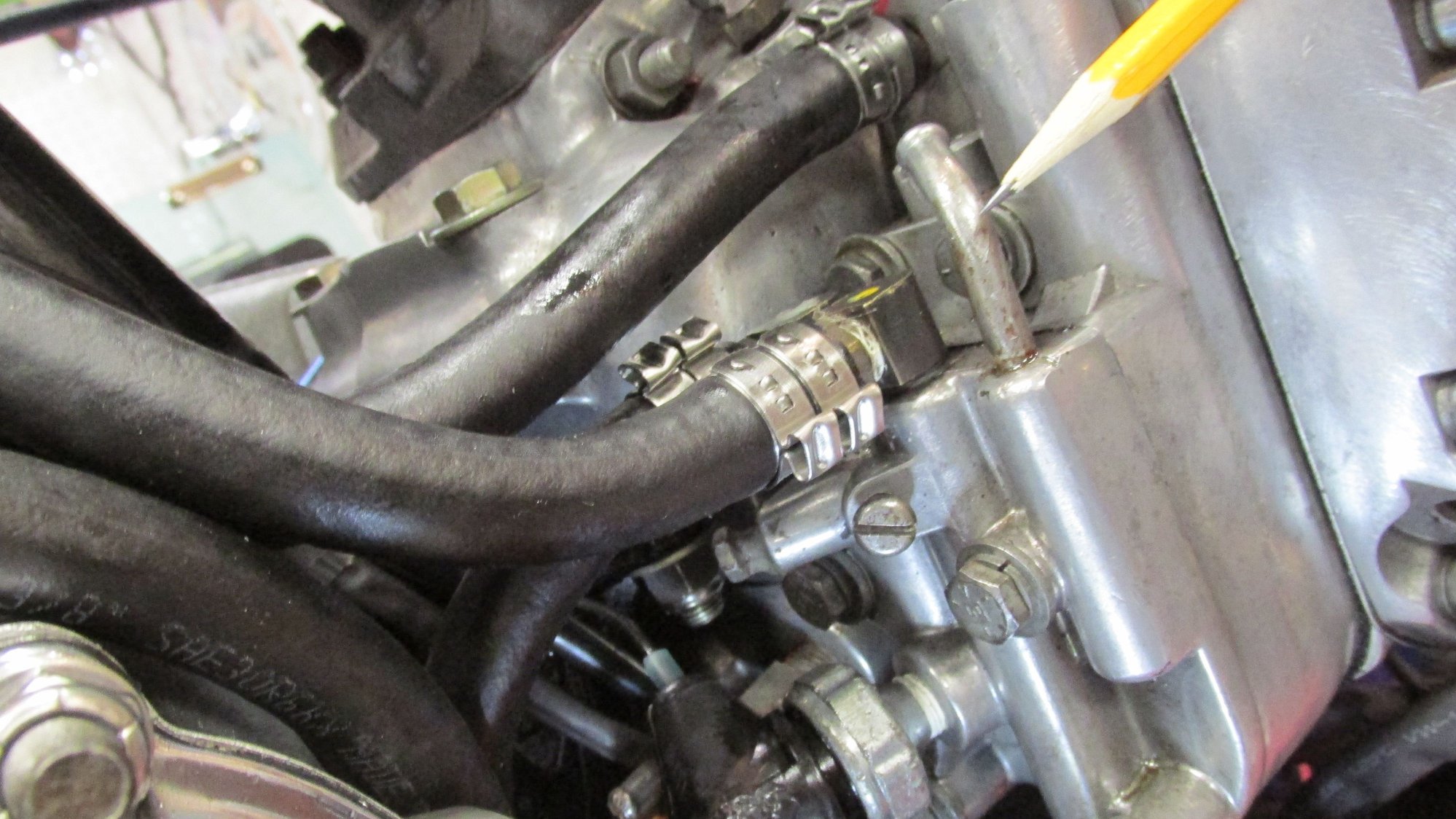

And in this picture, do these 2 get capped off? Again, primary belt and belt drive. Thanks.
This is the crankcase breather and should have a hose run to the ground.

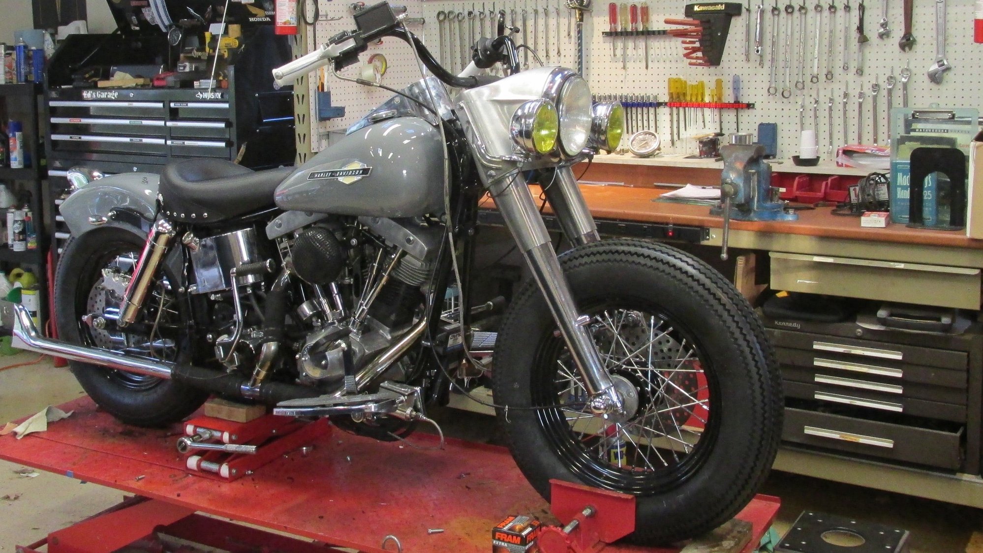

There is still a lot to do, but you can see pretty much how it's going to look. I have a question about the throttle cable. The return cable is bad so I eliminated it. It feels OK without it and I see choppers with one cable. Do I really need it? It has the CV carb. Thanks for looking.

You don't need it, but the nice thing about having one is, you have a built in spare for the pull side in case you need it.
I switched one out on a road trip for a friend once. Boy, was he ever happy.
The spring is generally strong enough to not need the push (throttle down) cable (or you can add one that is).

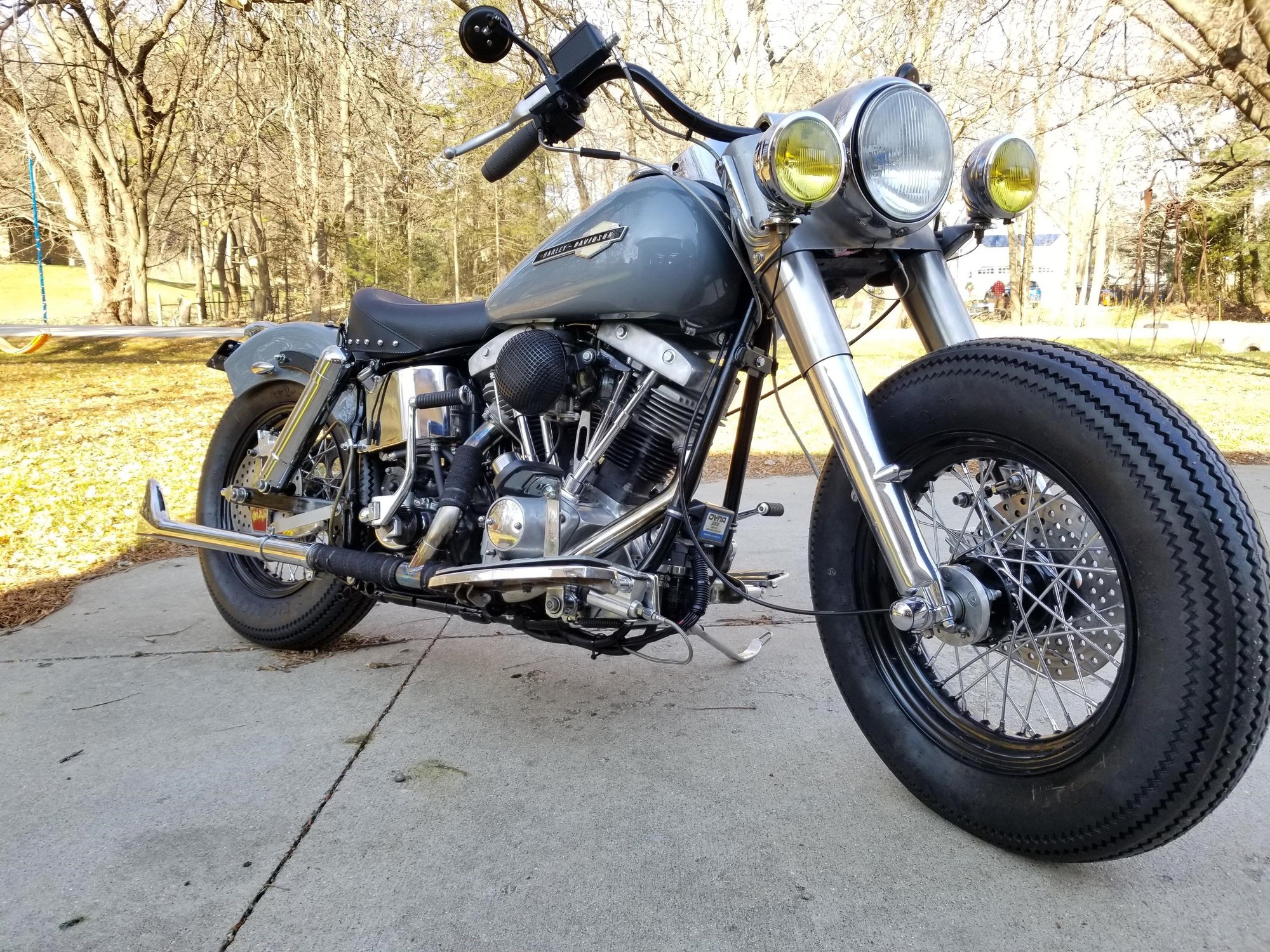

Recently finished the 79 FLH for now. It will probably never really be done. This is my forty-first motorcycle so I cleverly named her “41”. This build went well, the previous owners maintained it. The wiring wasn’t stock but it was well done; the parts were genuine HD; and there were no stripped threads except for the one I did. The motor and trans needed nothing.
The passing lamps function as turn signals and they flash at about the same rate as the original setup. My plan is to start it in spring but I don’t know if I’ll be able to wait that long. I got a lot of good advice from the forum so thanks to everyone.
