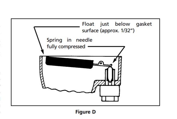

I am having trouble with my S&S Super B overflowing if I leave the petcock open for just a few minutes after shutting off the engine. I pulled the float bowl to check the float level and when I looked up the specs on the S&S site it mentions a spring on the needle valve, mine doesn't have any type of spring. This is the first time I have ever been into and S&S so I don't really have anything to compare it to.
Here is the pic from S&S

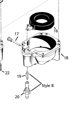

The parts diagram doesn't show a spring though.

Not sure what to think. When I first read your post I thought of the spring inside some needles, you can’t see the spring, it’s inside the needle and pushes the plunger that contacts the float back out if the plunger is depressed. I’ve seen the plunger stuck so it can’t be depressed into the needle. Usually from sitting to long without the carb being drained. Usually some carb cleaner and working the plunger will free it up.
Looking at the parts diagram though I’ve never seen a spring inside that kind of needle

Take the needle and seat out... in those early days, S&S had interchangeable Seats/Needles.. some folks thought that a Fuel needle, and maybe even a Fuel or Alcohol seat were the hot ticket...some needles were even Flat... not good for street use.. .. Good old Gasoline needle and seat are the proper setup for the street.. Call S&S... They May still remember the correct stuff... If Not... I can get pictures..
BTW the "spring" they speak of is built into the needle... Maybe... again.. depends on who was in there last!!!
