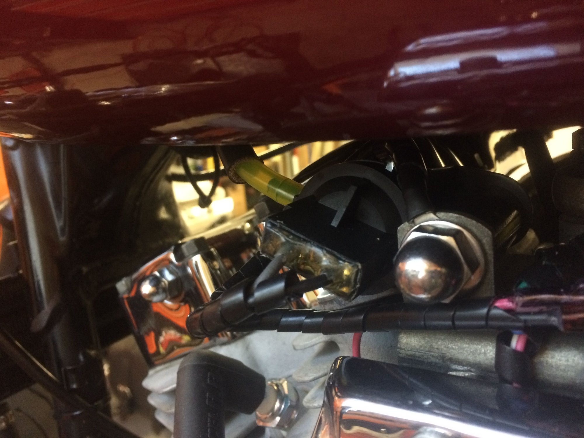

Old Jan 24, 2021 | 08:42 AM
Redrodyankneck's Avatar
Redrodyankneck
Joined: Mar 2016
Posts: 2,285
Likes: 965
From: Eastern NC
Originally Posted by johnjzjz
your light and its a light machine so 4 is your number
Here is the VOES installed, this is the only place I could get it mounted out of the way. I will get a run in during the week when it gets a bit warmer around here.
Old Jan 24, 2021 | 10:07 AM
TwiZted Biker's Avatar
TwiZted Biker
Joined: Mar 2009
Posts: 66,122
Likes: 51,431
From: Niles Canyon Ca.
Usually mount off the upper motor mount, tucked in and tight.
Old Jan 24, 2021 | 01:57 PM
Redrodyankneck
Joined: Mar 2016
Posts: 2,285
Likes: 965
From: Eastern NC
Is that the bracket welded to the frame under the tank where the upper stabilizer link is bolted to?
Old Jan 24, 2021 | 03:53 PM
TwiZted Biker
Joined: Mar 2009
Posts: 66,122
Likes: 51,431
Don't remember the exact configuration just where it was, sorry been a while since my FXR.
