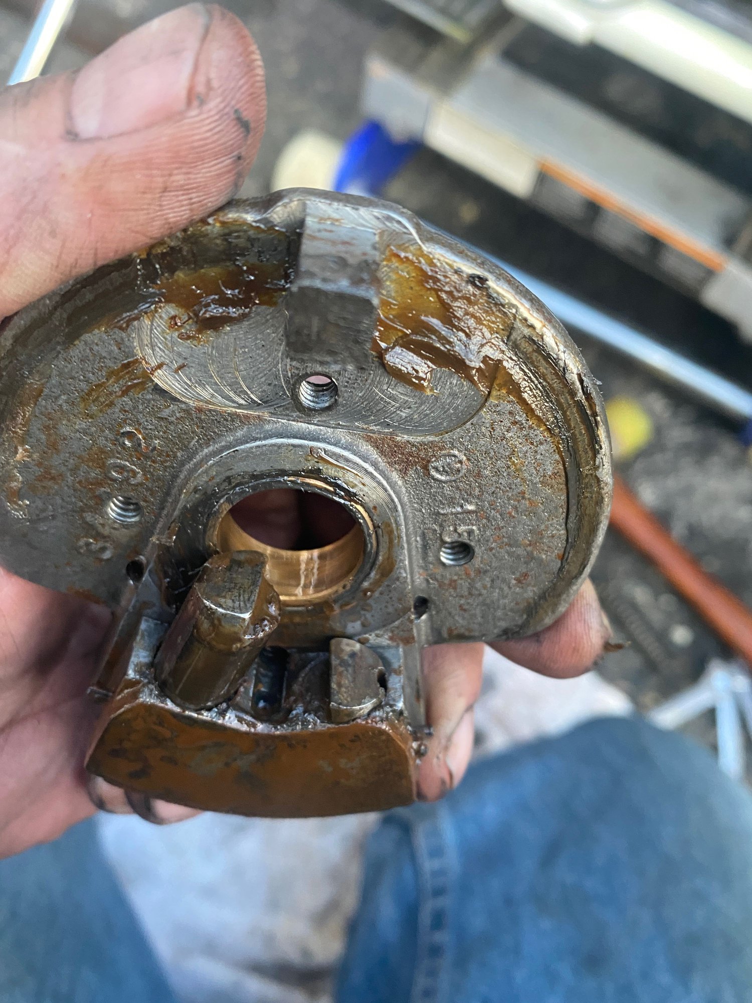

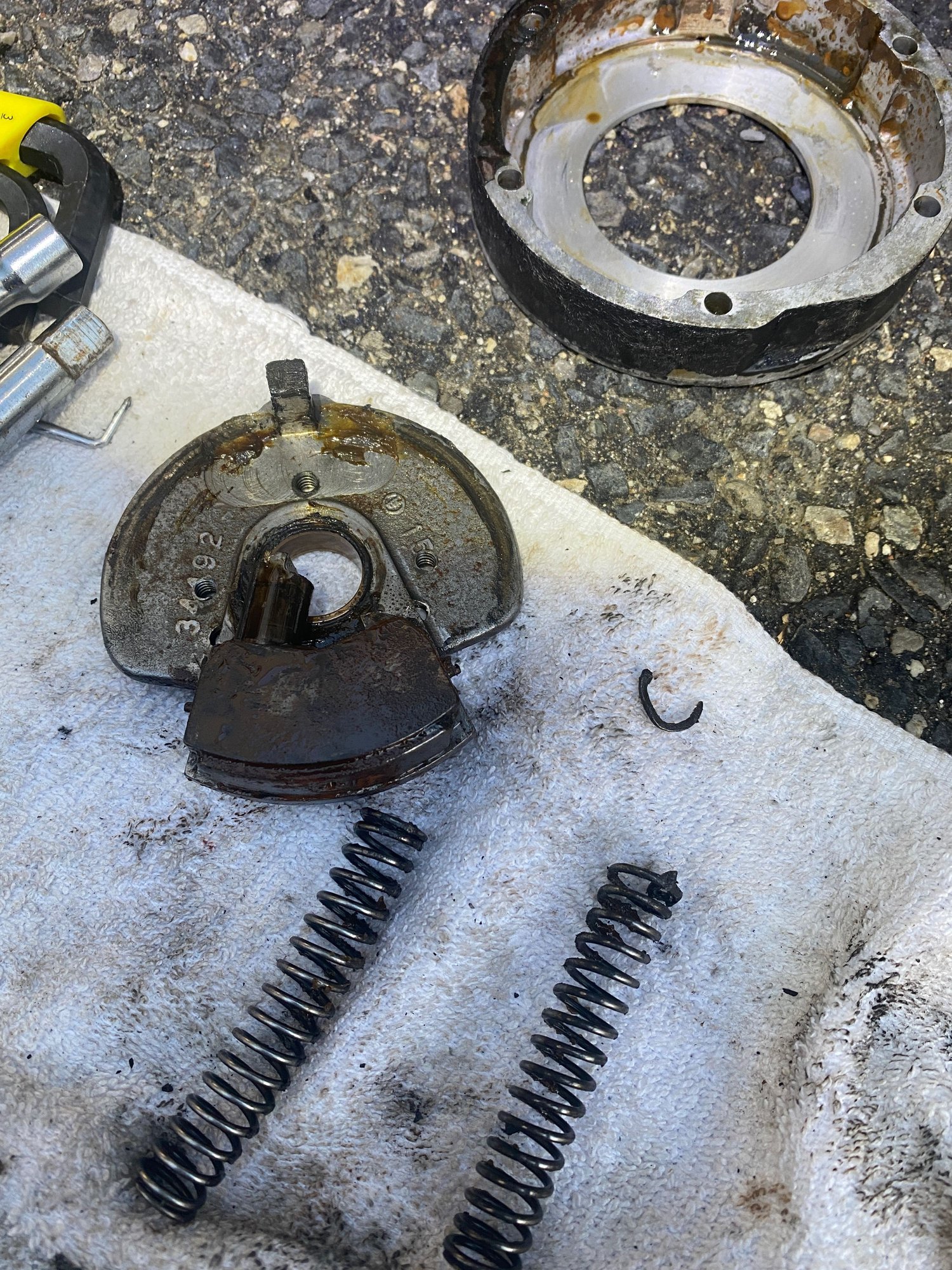

Tore in to her today. Found a piece of a broken spring it there as well as one of the shifter pawls stuck in the down position. Cleaned up the pawls and moving freely. Look good to me but will definitely have my indy check em out. Need to order new springs and some gaskets. Found a few grooves on my 3 finger hub and also some of the anti-rattle clips missing/broken off the steel plates. Will be replacing quite a bit but very well worth it.
